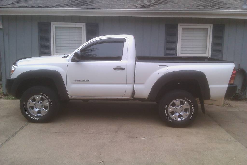

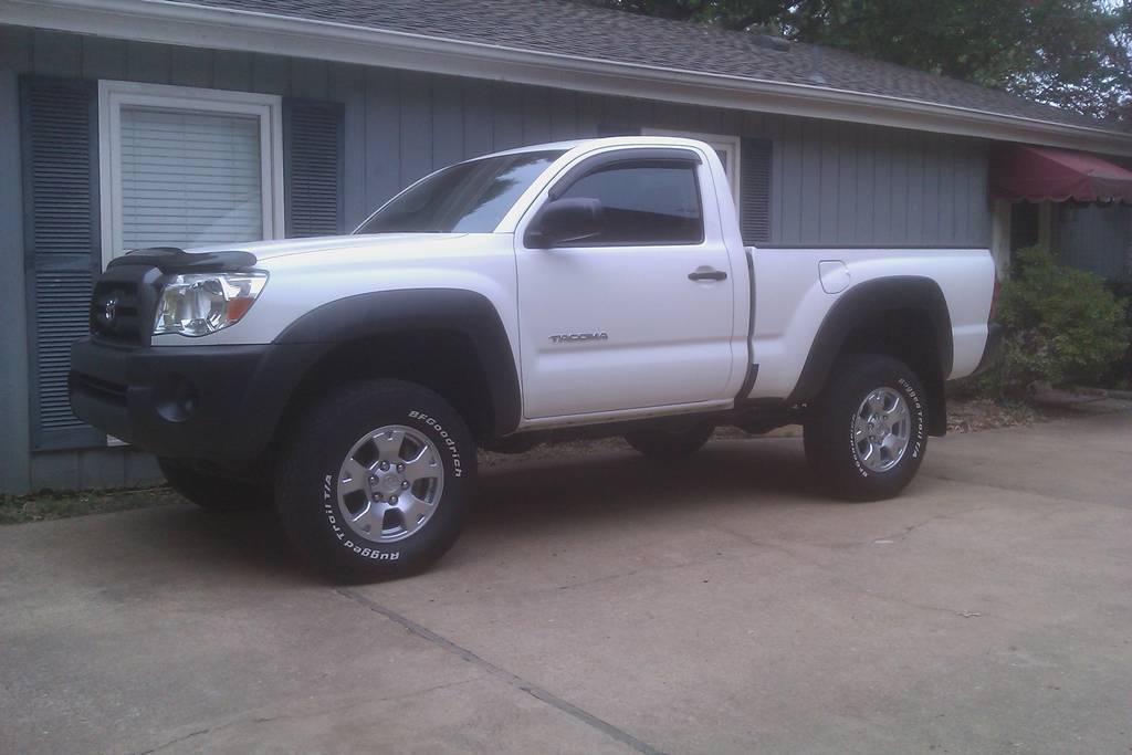

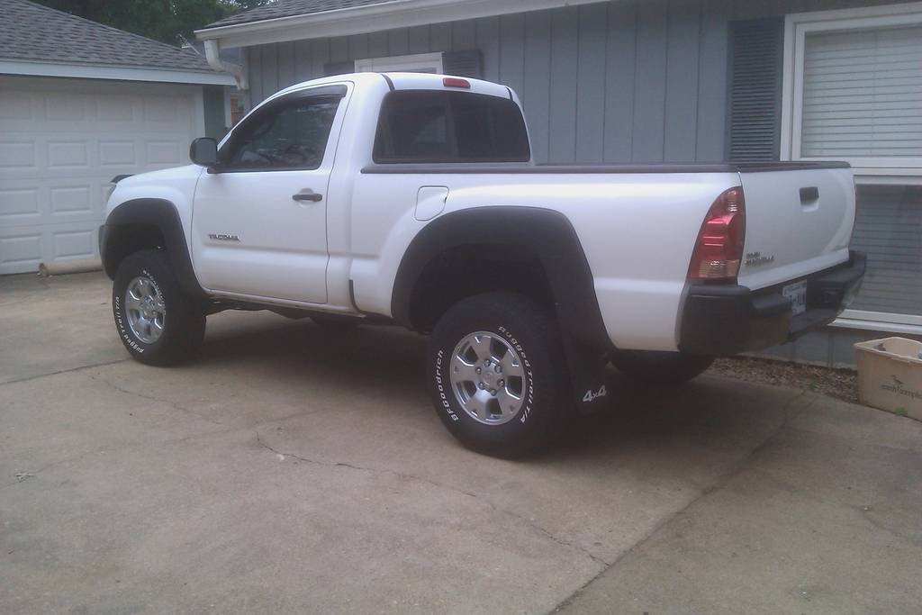

    Well I think I've decided to order some 285/75/16's. Here are a couple pics of mine lifted still on factory alums. I will be ordering my new wheels and tires within the next couple days hopefully.
    [​IMG][​IMG][​IMG]

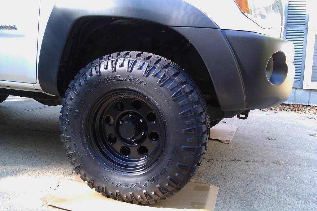

    Oh btw, here are some pics of my new wheels and tires.
