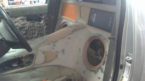

    This is my brothers old set up. He made a custom ported box for two Kicker 10 inch comps. Then he put two Kicker L5's in there. Then he rebuilt the box and put one 15 inch L7 in it.
    He has made three boxes so far. All three of them are like this

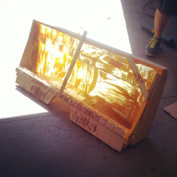

    This is his current box(Probably a little bit bigger than you want to go) He swapped out his bench seat for two factory bucket seats. He has two 12 inch Memphis Mojo's. The box is ported through the center console.

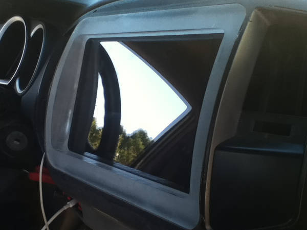

    And might as well post the pictures of the iPad in the dash..(Still not complete)
