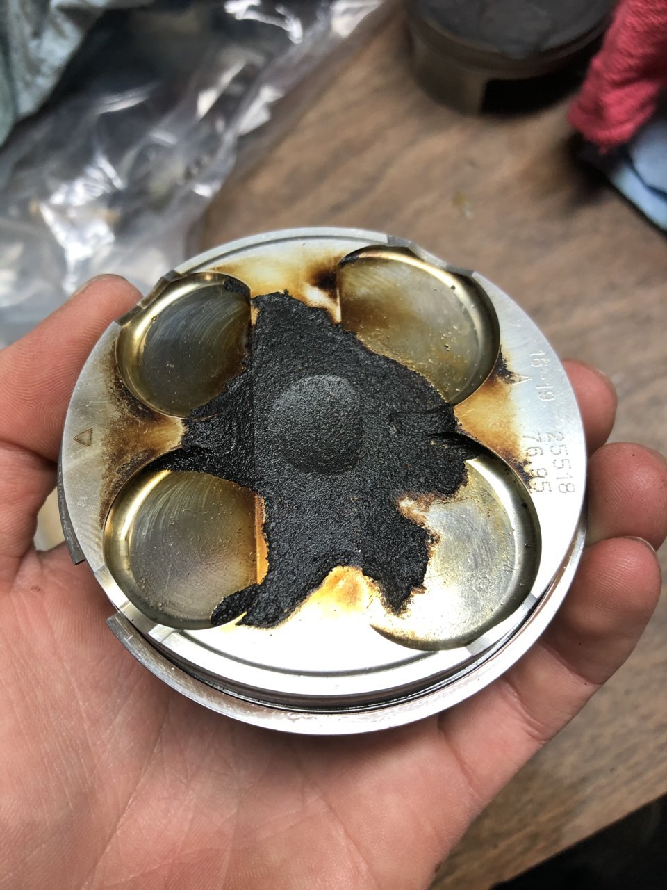

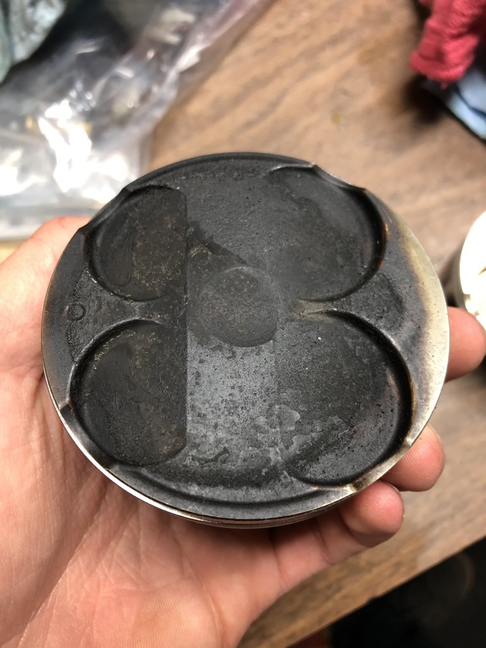

    Pretty much any gasoline brand will be fine. 87 unless you’re tuned for higher or hear detonation when towing or payloads are high.
    Personally, I’d run VP in my car if I could afford to throw money. Not for the octane number, but the purity. I’m not convinced that the cleaners and additives of pump gas is good.
    Here are two pistons from the same motorcycle, each run for 50hrs, with the only change being fuel. 91 octane top tier gas for the first picture, VP 101 on the second. The difference is very apparent in the amount of carbon build up.
    5CB3178F-4512-4A56-89EC-1CB748EBCF58.jpg F5C9D9C1-4144-4D96-8751-88E1C0361874.jpg
    The second image after VP 101, the carbon deposited could be scrapped off with my fingernail with ease. The carbon on the previous piston was permanent.
    This leads me to believe that the cleaner/purest gas available is best.
    The brand that carry’s that depends on the supplier they get it from.
    Then maybe a tank additive every once in a while to see if the soft deposits could be removed. I’d need to do more research on tank cleaners though.
