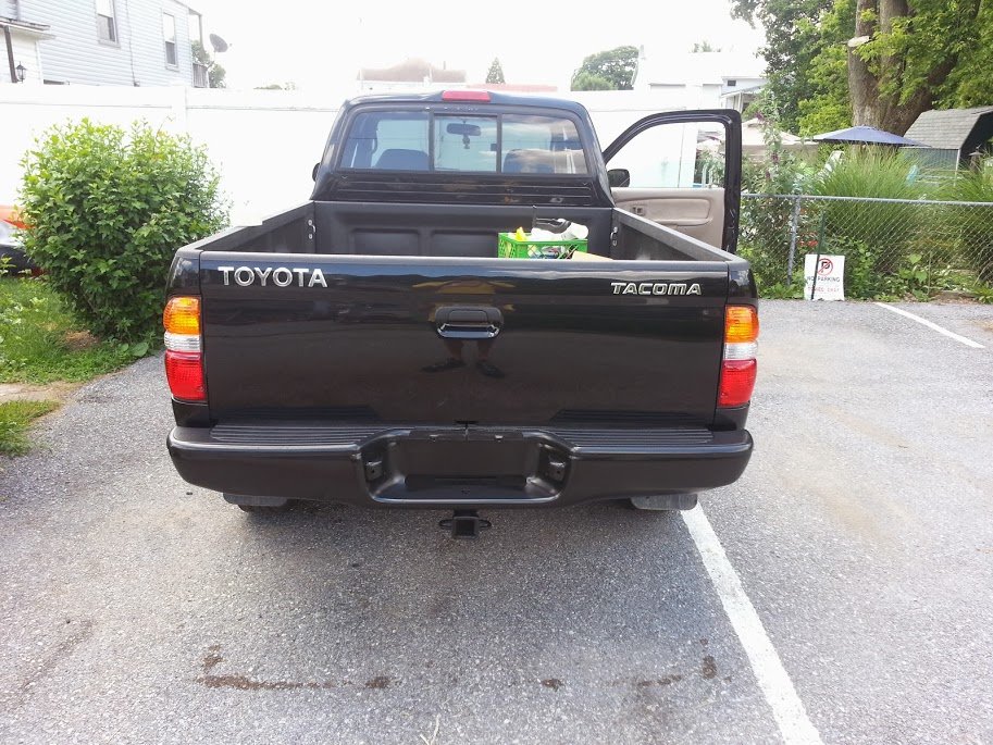

    I bought this truck in Feb of 2013. Bought it with 145,xxx miles on it. It is a 2.7 5 speed with 4.30 gears. I ABSOLUTELY LOVE THIS TRUCK!!! LOL. It is my first 4x4 and I don't know how I ever lived without that. My main purpose for buying a truck was hauling kayaks and for hunting.

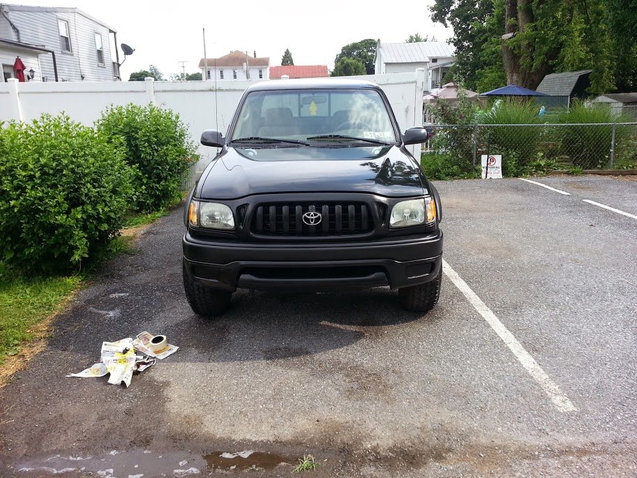

    Here's how she looked when I bought her...well minus the mud lol

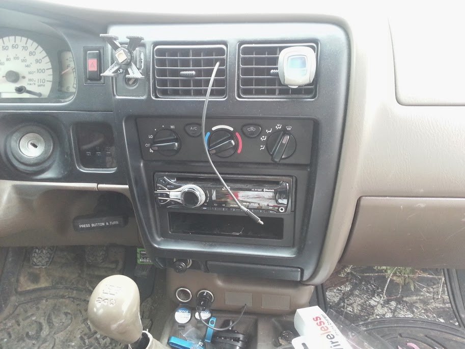

    My first mod was an aftermarket head unit. I can't stand fm radio so I wanted to be able to listen to Slacker radio from my phone. I went with the JVC KDR730BT In Dash CD Receiver and am very happy with it. The bluetooth sync is very nice. (I hate wires). It also came with a mic that I wired up and put on the A arm. Works well there and haven't had any complaints about noise in the year its been there. When I had the dash apart I decided to route a charging cable through the vent to hide most of the wire. I debated on whether to plug it into the head unit or the auxillary port. I went with the aux port since it charges much faster. Added a tetrax mount for my phone over the airbag indicator. Works great! Holds my beast of a Note 2 just fine.

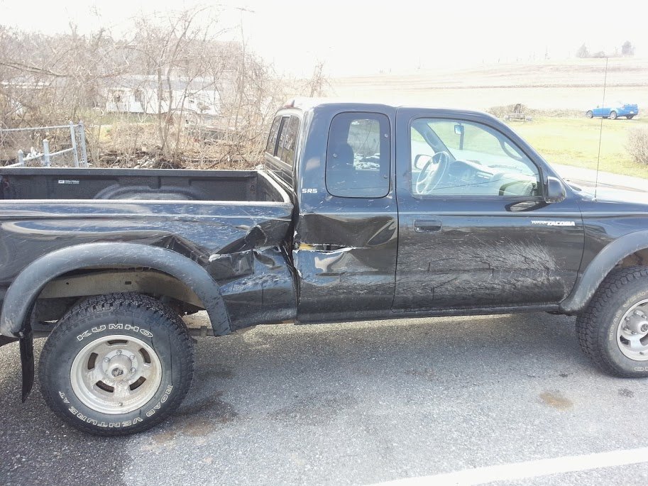

    About a month after I had the truck this happened.
    Going to work and was hit by a backhoe.:mad: My empoyer covered everything and even had some other minor scratches repaired :)

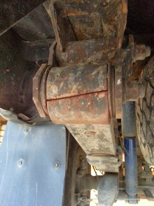

    Bought a hitch and during installation I realized my leaf spring was cracked.
    Ordered some new leaf springs. This would be my first real repair on the truck and I'd say it went fairly well. All of the u bolts need some heat to break loose and I cut one of the shackle pins not realizing it was actually fixed to the plate. I thought it was just another bolt I could replace. Ended up just drilling the old pin out and putting a bolt in its place. I think in the future I might get a 1" shackle lift so this will work for the time being.

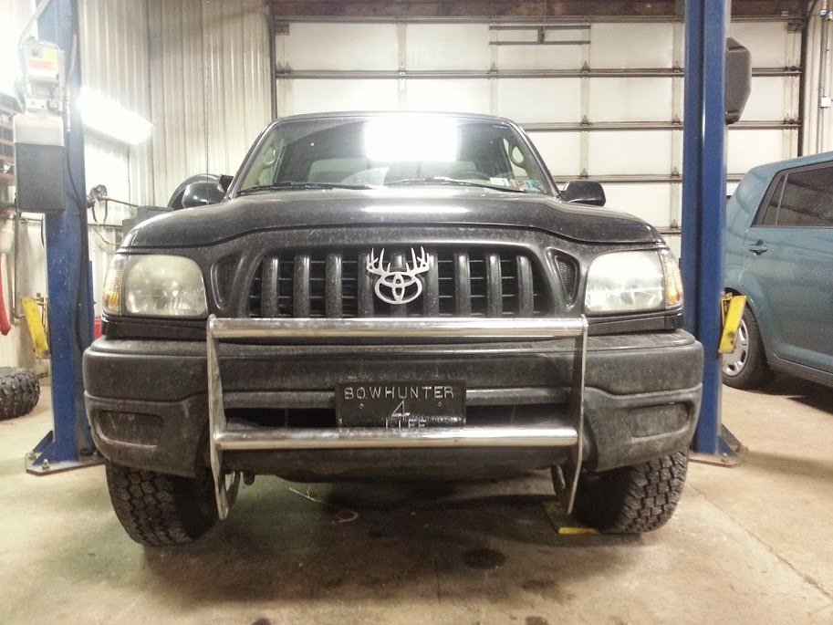

    Saw a picture of one of these emblems online and decided to make my own. I pulled the antlers in a little closer than the one I had seen and had a coworker cut it out with the plasma cutter. I was very impressed by his precision on just the raw cut. I did file and grind to get everything as symmetrical as I could then sprayed it with clear coat.

    Got an old push bar from work that came off a vehicle we no longer had. I'm still not sure if I like it 100% or not but its staying until I get a plate bumper.

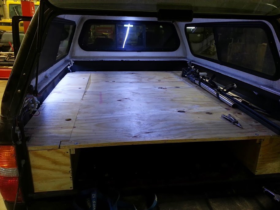

    Installed some LED strip lights in the bed and also decided I want to do some camping out of it so I built a platform. I plan on putting carpet in eventually but for now this is it.

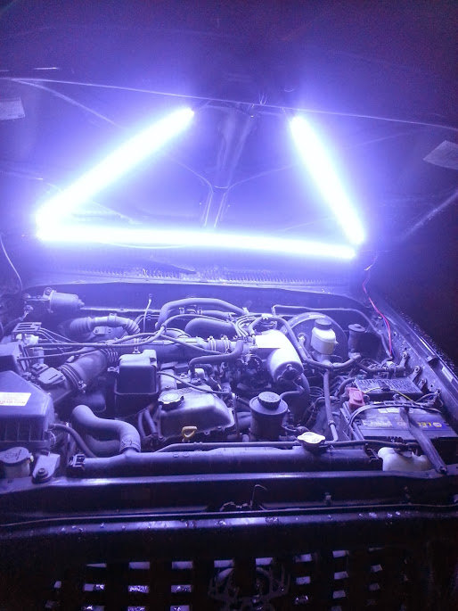

    With the remaining lights I decided to use them under the hood. They give out plenty of light.

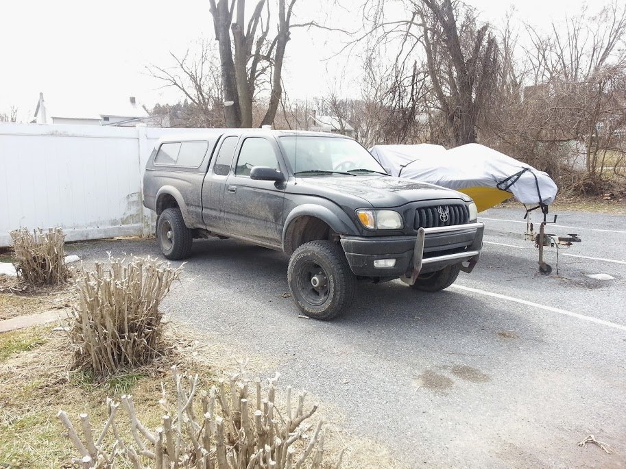

    Lifted!:bananadance:

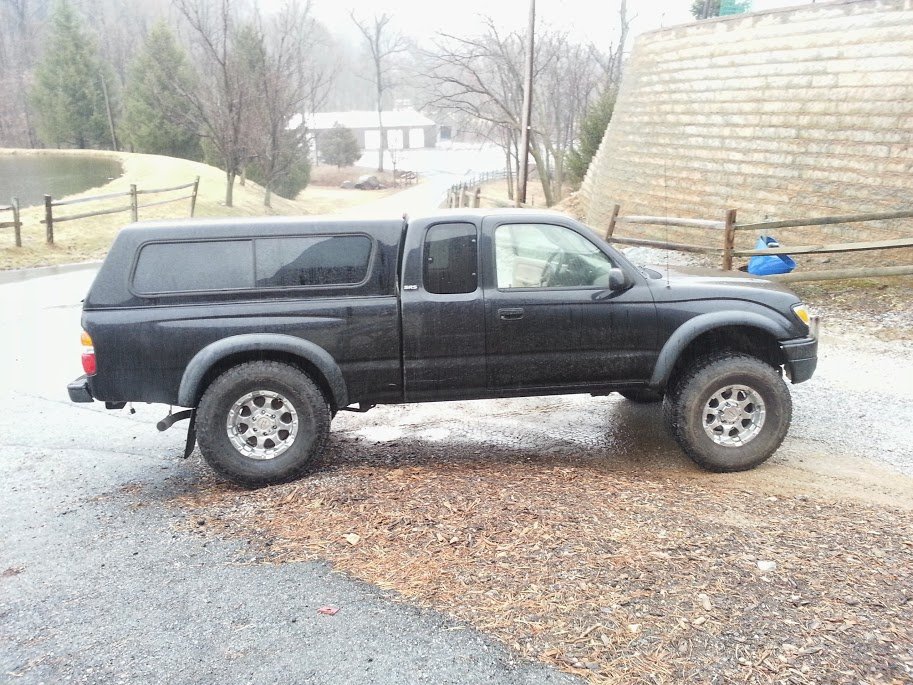

    Installed an OME lift with an AAL in the rear. I went with the 881 springs and couldn't be happier with the ride. Wasn't too difficult to install. Worst part was breaking all the nuts loose. I had to use heat on just about everyone of them. I'm glad I did this myself, learned a lot about the truck and saved a couple buck!
    Measurements were taken from center of hub to fender.
    Before:
    DF: 21"
    PF: 21"
    DR: 20"
    PR: 20.5"
    After:
    DF: 23.5"
    PF: 23.5"
    DR: 23"
    PR: 22.25"

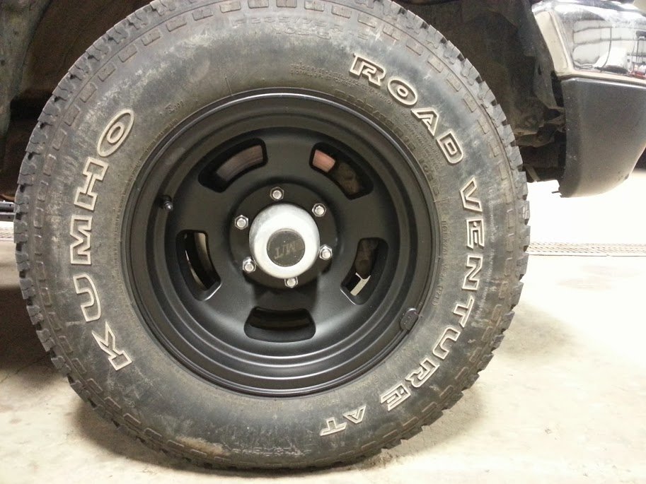

    Bought some new to me wheels and tires from a member on here. They are 295/75/16's Nitto Terras sitting on Motometal 955's. She is stuffed!! Haven't had to trim a whole lot yet but haven't had it flexed hard yet either.
    First pic with them on. Hope to get some better ones soon.

    Lifted!
    Before
    After
    Didn't think to really take some before and after pics so that what I got lol

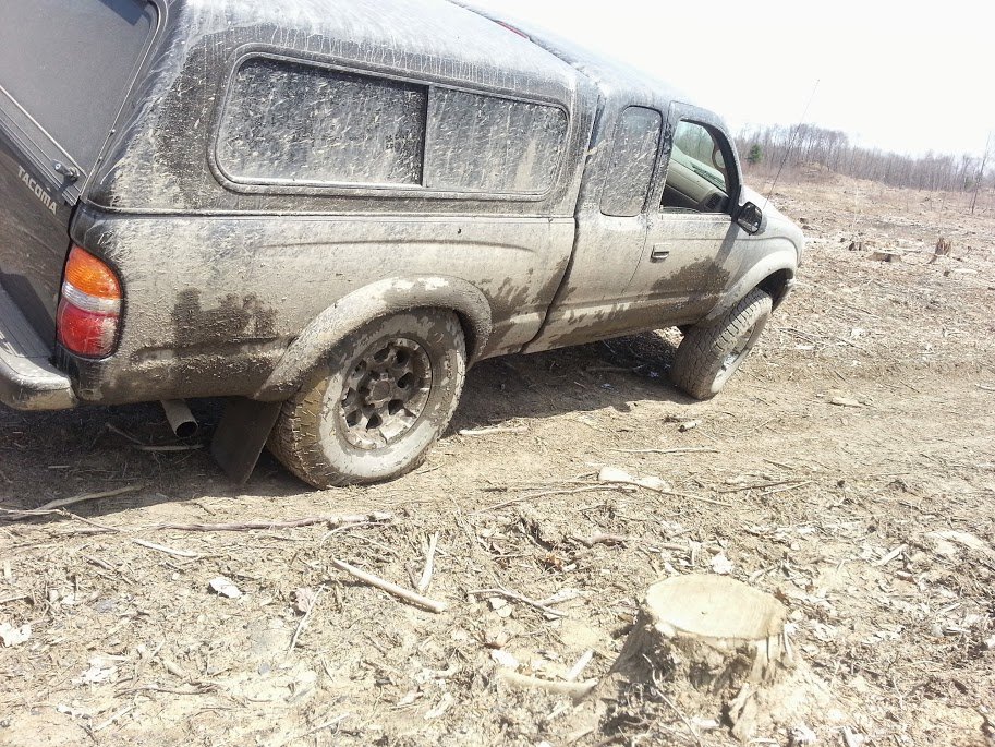

    Did some wheeling last weekend and rubbed like crazy! :eek: lol

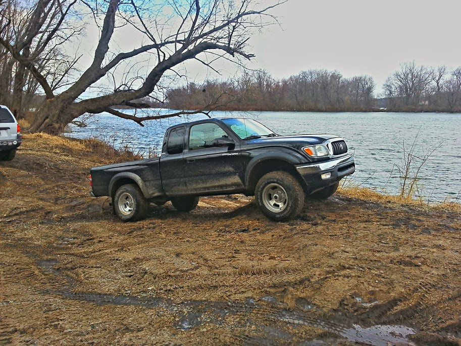

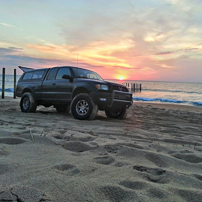

    Did a little beach driving over the weekend.IMG_20140525_103937_5f3b0fcb1bd1406e75c0e093cc276d067e05177c.jpg

    Are those 285's? They look huge!

    295/75/16 and yes they do rub a wee bit lol

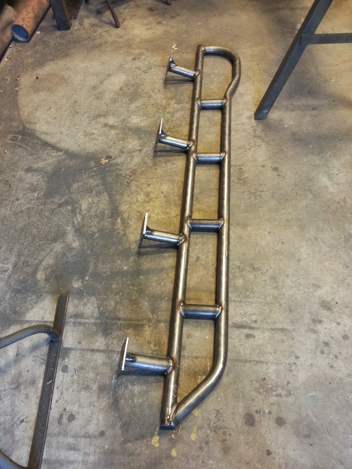

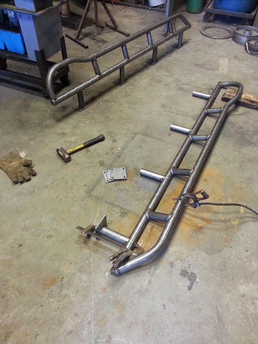

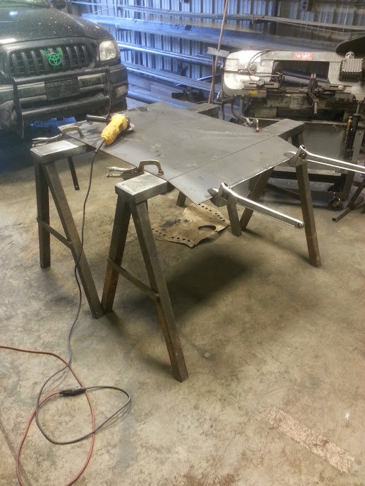

    Bought a set of 4x innovation slider and welded the legs on and then to my truck my self. So far my welds have held...
    https://lh4.googleusercontent.com/-.../gseHQdinAb0/w514-h685-no/20140822_122115.jpg
    In hindsight I should have cut the corners of the leg bases so I could weld the top. To prevent rust I just shove some rtv in there and hoping it seals.

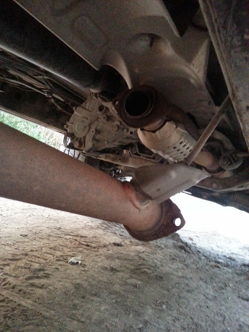

    My exhaust fell apart about a week after a wheeling trip. Sounded awesome for the day of so I left it like that.

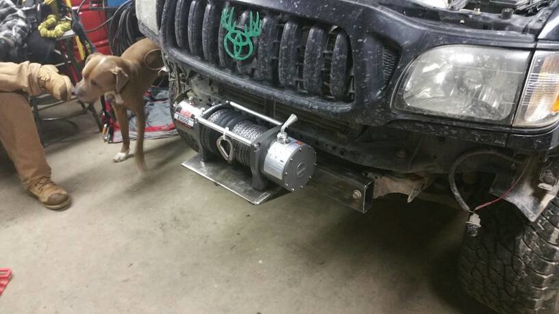

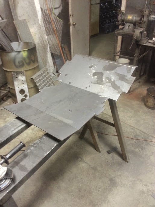

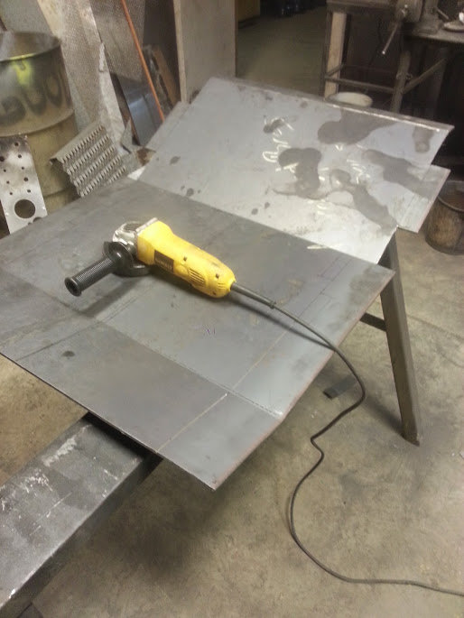

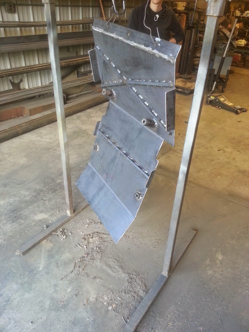

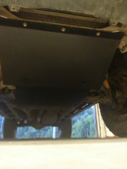

    First time out with the sliders on I banged up the stock skids pretty good. I found some blueprints online of a front skid and decided to try and make my own. Bought a piece of 3/16 plate for 60 bucks and turned it into this.

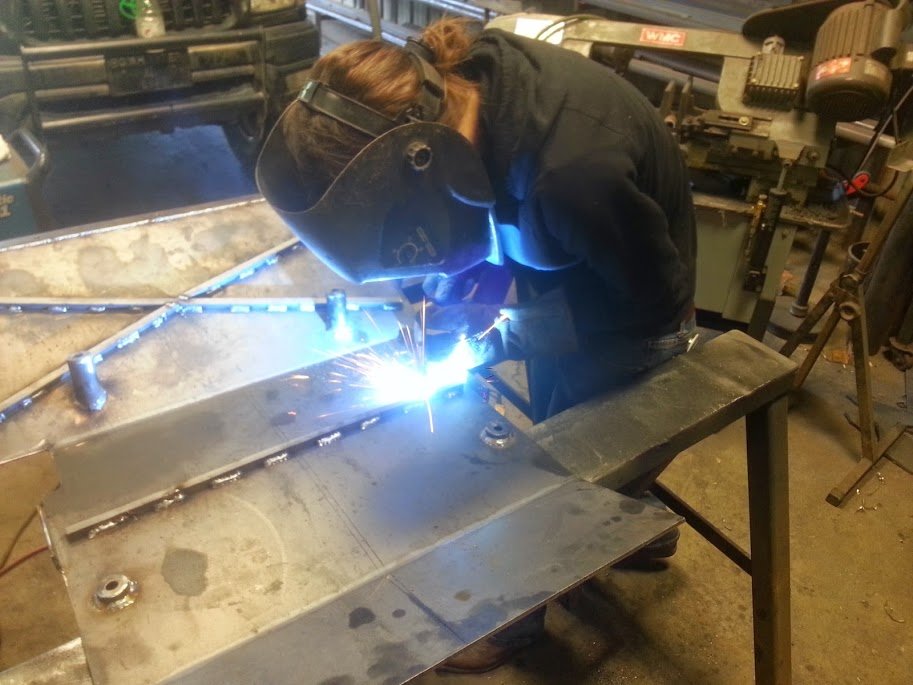

    Let Kristin try her hand at welding. Her beads look better than mine!:eek:

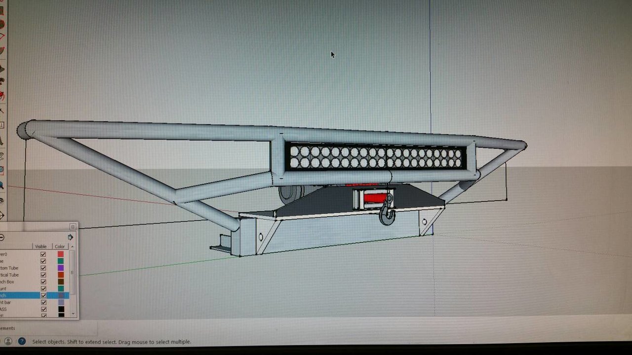

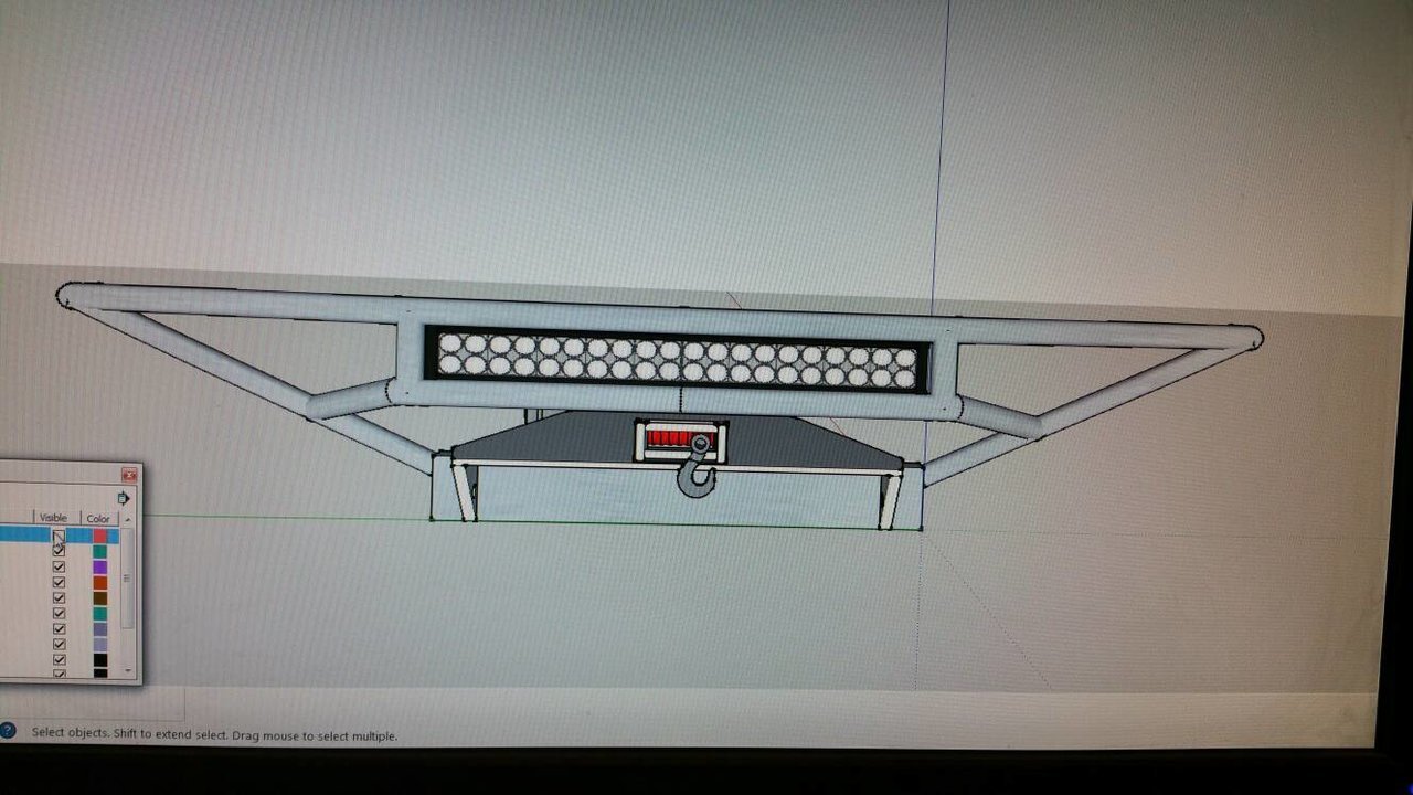

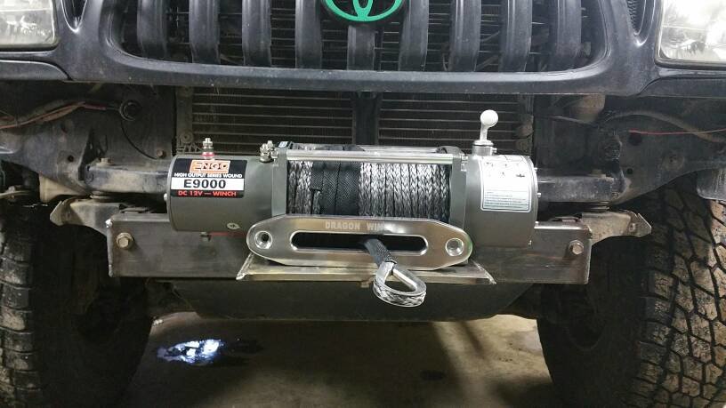

    Hoping to start building this bumper soon! Probably not going to look exactly like that but similar.

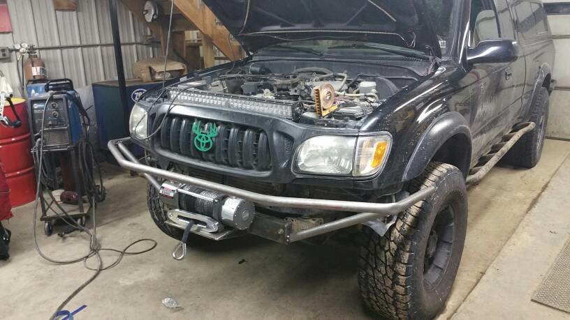

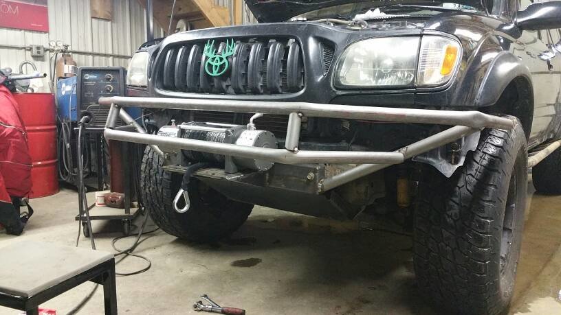

    Made some progress on the bumper! It's not perfect but I think it's going to look really good in the end.

    Tacked on the lower tube today. Hopefully tomorrow I will have that welded and the light bar brackets on.
