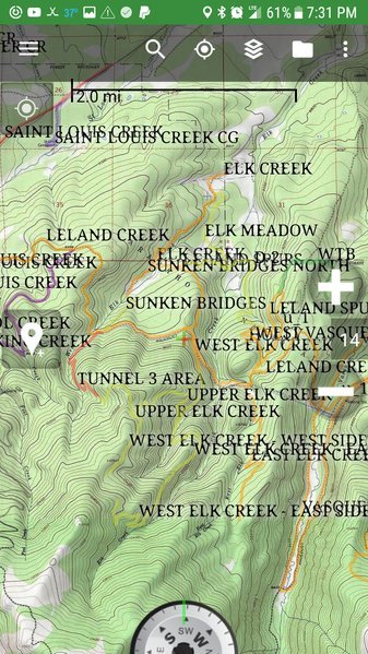

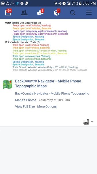

    Backcountry Navigation just added forest service roads as an over lay and color coded them.

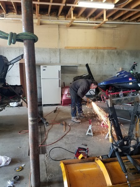

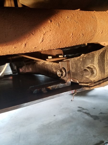

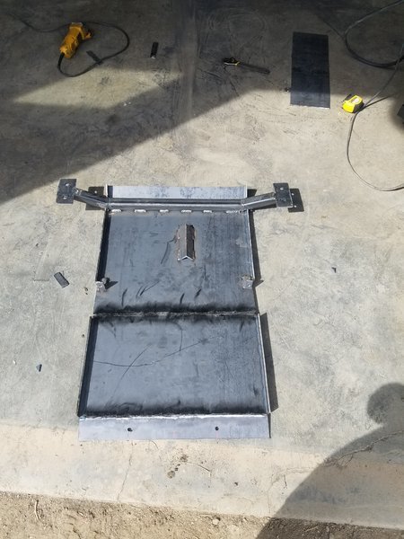

    Well @alee891 and I decided it was finally time so make some skids!
    Crossmember all welded up
    Austin grinding something on the ghetto fab table/trailer
    Used an existing bolt for the mid section to mount to. Had to grind the little lip off the factory crossmember.
    Getting sick of cutting 3/4 of the way though for the whiskey bends
    All welded up. Time for some cleanup and paint.
    Austin had frame plates to weld up and a job to get back to so his will hopefully be finished this weekend...

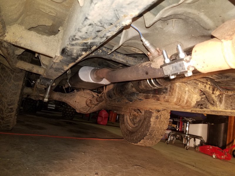

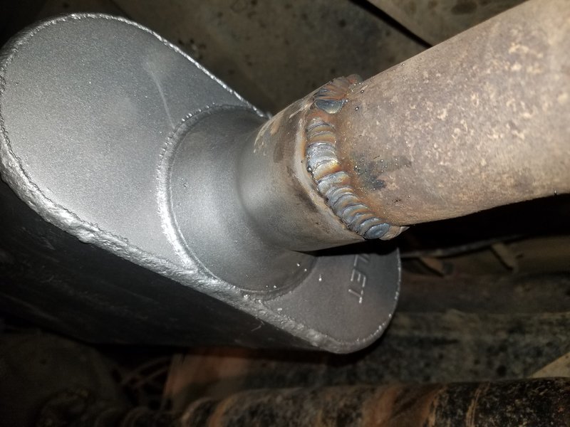

    Finally replaced my custom high flow muffler with a flowmaster 50 series. So no more 4 wheeler noises like @alee891 likes to say. At least I hope not. I only turned the truck on and let it idle for a bit since my dash is pulled apart and fender is off.

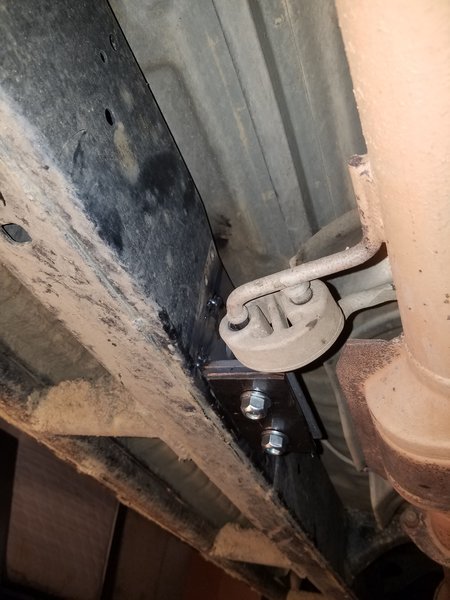

    I still might have to do some tweaking to avoid my new xmember from hitting the cat and the tailpipe hitting the leaf spring.
    Crossmember finally installed. Added some rubber conveyer carpet in between the rear mount to maybe help soften a hit.

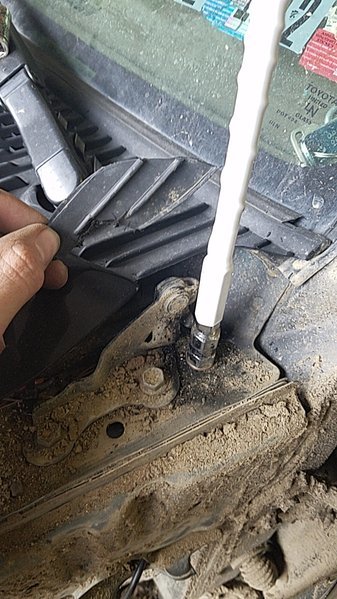

    Attempted to install my antenna here but there wasn't enough room inside for the straight coax cable to fit and the antenna stay straight. I think I ruined the cable at least I hope I did. I couldn't get my swr any where close. 90* fittings are on the way and a new coax I hope that is my issue.
    I hadn't intended for that piece to break off. I had it pretty neatly trimmed with a step bit using it like a dremel...
    Should I add a ground wire from the base to the factory ground near the battery?

    A firestik fire ring cable would work perfectly in that scenario. I was in the same boat as you when I first installed my CB. Ruined a cable by trying to make it bend tighter than it should. New cable allowed the SWR to tune below 1.5:1 on all channels.

    I wish I would have known about this! It is exactly what I need. I'm hoping there will be enough room for the 90* connector but if not I know that that will work! Thanks man!
