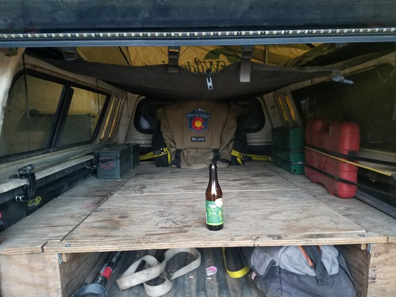

    Organized my bed in preparation for Moab this weekend! :bananadance:
    I think I'm going to rebuild my platform in the near future. When I built it I wanted something easily removable so I could load my kayak. Unfortunately I've only been kayaking once since I've been in Colorado so the removabilty isn't a requirement any more. When I'm offroad all everything bounces around and the lids are all over the place. I think I'm going to make one big drawer that slides out and add hinges to the side doors.
    Here's the rare sight of things being organized back there.

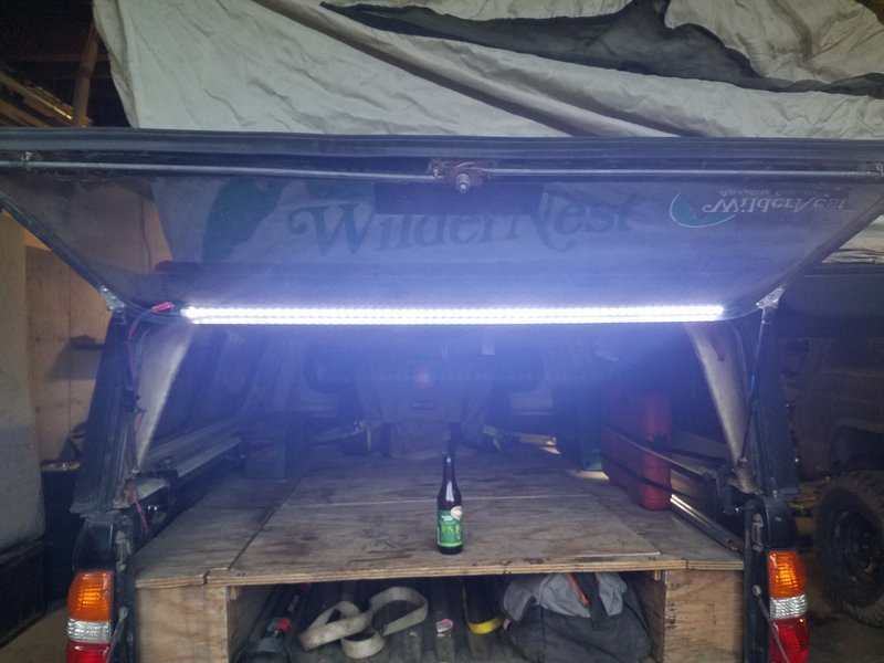

    I added this light tonight. Should be nice for cooking and when it's closed it should illuminate the Nest.

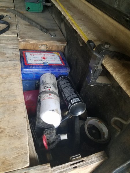

    Moved my recovery gear, ratchet straps, fire extinguisher, first aid, miscellaneous bolt box, and brake clean to the passenger side. Hopefully it helps with the terrible taco lean I have now. Previously I had some cooking utensils in there but I'm putting them in a box under the platform. Too much dust in the cubbies.

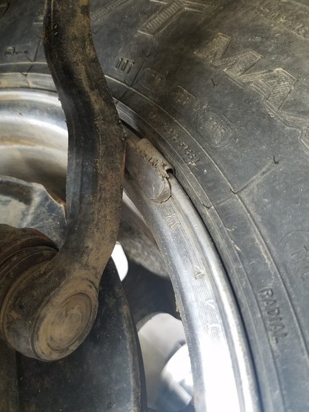

    Decided to try and figure out what my wheel weight was hitting. Turns out its the OTR. Hopefully this is why I can't get rid of the vibration around 65. I ordered new wheels with 3.5 bs a few weeks ago so I'm not too worried about it. I was told they would ship today but haven't heard anything yet.

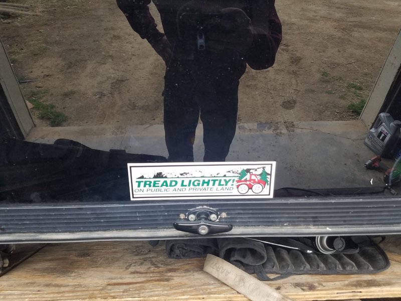

    Finally put this sticker on @Bumpr1080 found somewhere.
