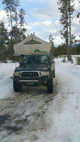

    Bought a Wildernest!
    Dalandser likes this.

    Sub'd. Stoked on your comeup on the Wildernest!!

    Those campers are really cool. Its a shame they do not make them anymore.....
    truck and build looks good bud me likey :thumbsup:

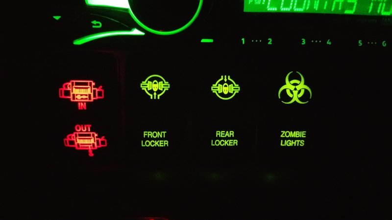

    Got 2 of the 4 switches completely wired. I still need to run the out going wires to the winch and compressor whenever I get that.
    Took a drive on a muddy/snowy county road tonight to put miles on the new rear end and to see how it handled with the driver front being locked all the time when in 4wd and add disconnected. There is a noticeable pull to the right when shifting gears. Not a big deal as of now, not sure how it will be when doing 55 on snow covered roads.
