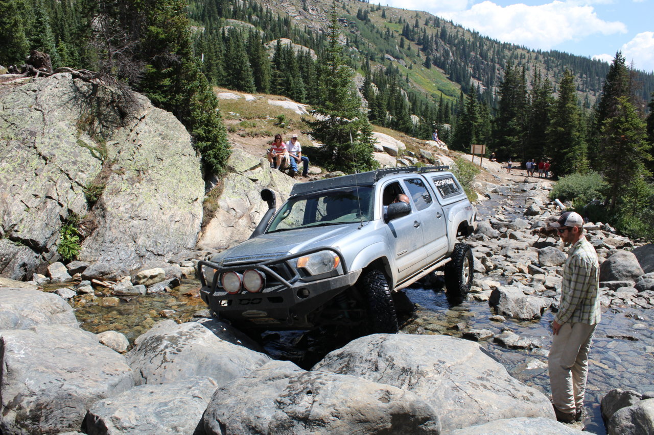

    Enough to make it a lot of fun!

    Moments before.
    And a few betters one's I'll toss in your build in a min.

    You can see them hovering in the background.

    That Toyota wave though!
