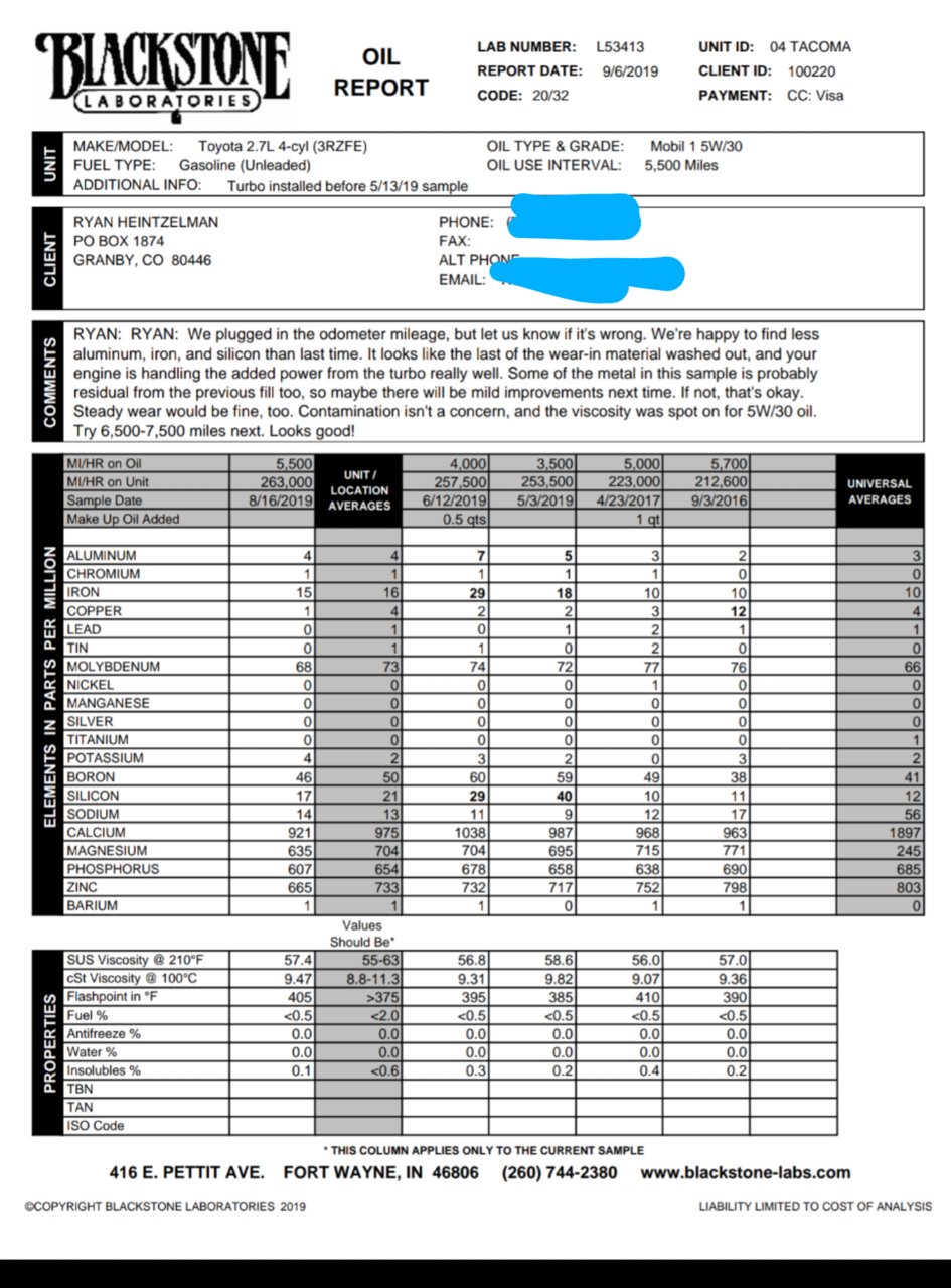

    Swapped out my LBJ with a MOOG. We'll see how long it lasts compared to OEM.
    Good news from my oil sample report.
    Not much else happening with the truck right now and there probably won't be until after I buy a house. Hopefully that ends up being sooner rather than later.

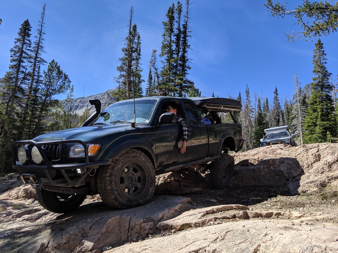

    Met up with @m3bassman and some others this weekend. Fun trail with some technical options, old mines and awesome scenery. If the trail had been more crowded I'd have thought I was still in Colorado.
