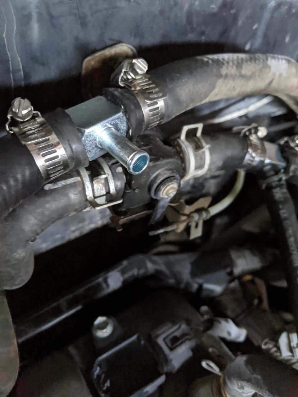

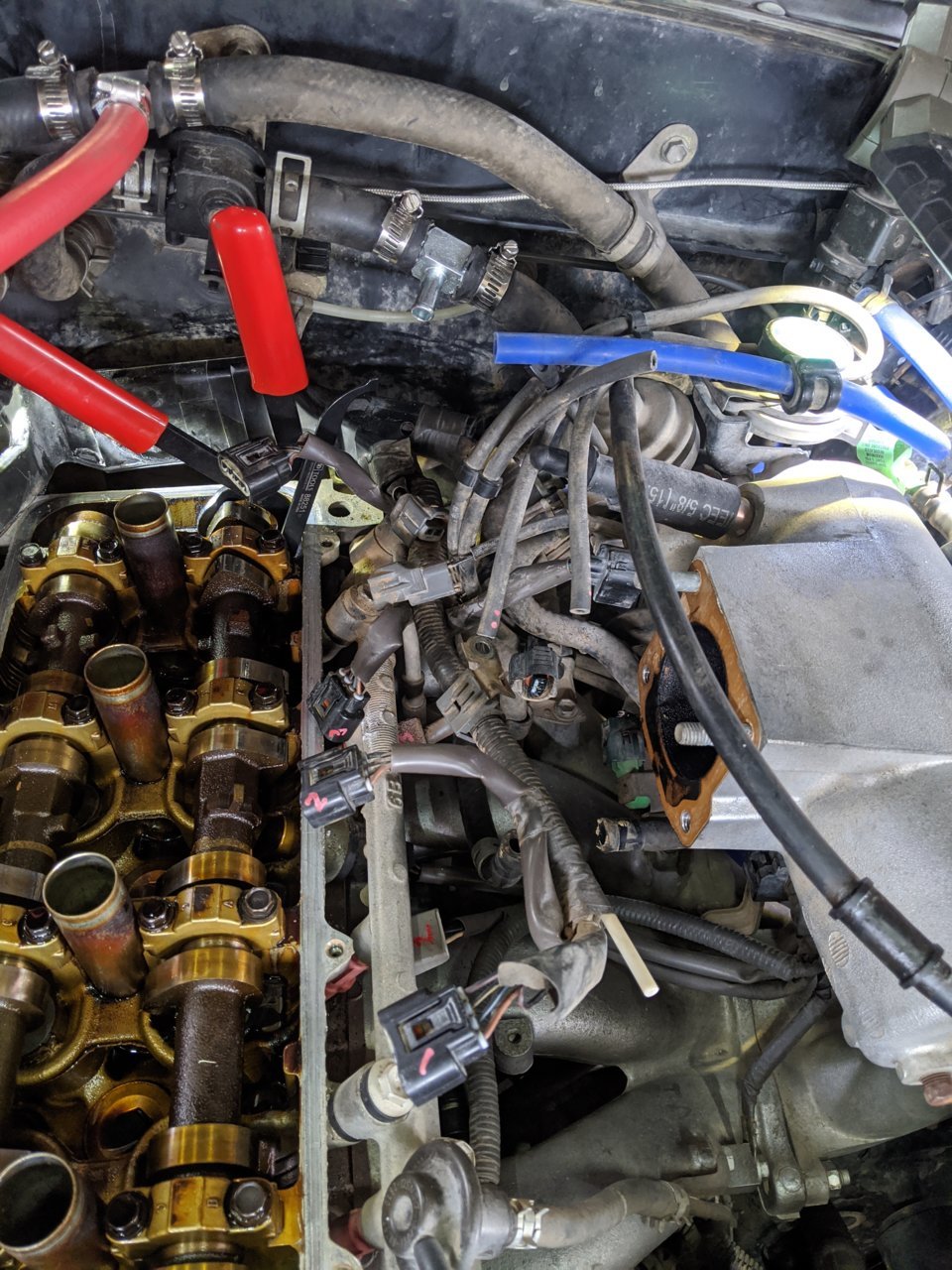

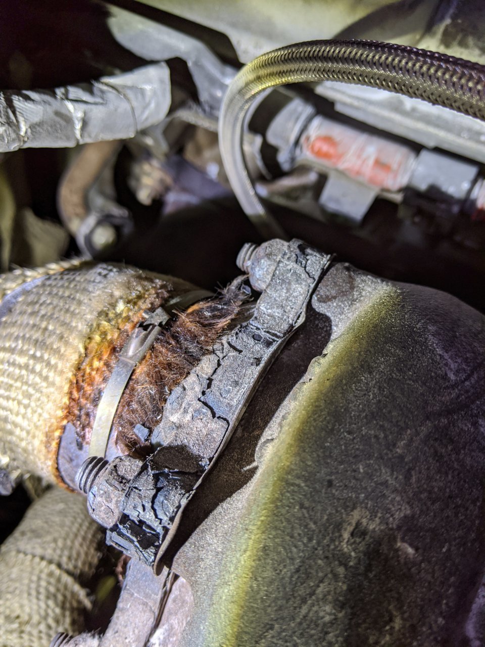

    After pulling things apart, my conclusion is that the pcv/ccv lines froze, which in turn blocked the oil returning to the pan and pushed copious amounts of oil through the turbo. The reason the lines froze is because I haven't emptied the catch can in months due to the valve handle disappearing. Lesson learned.
    I'll need to find some silicone heater hose to replace the turbo water lines. The current rubber ones wouldn't have lasted another year.

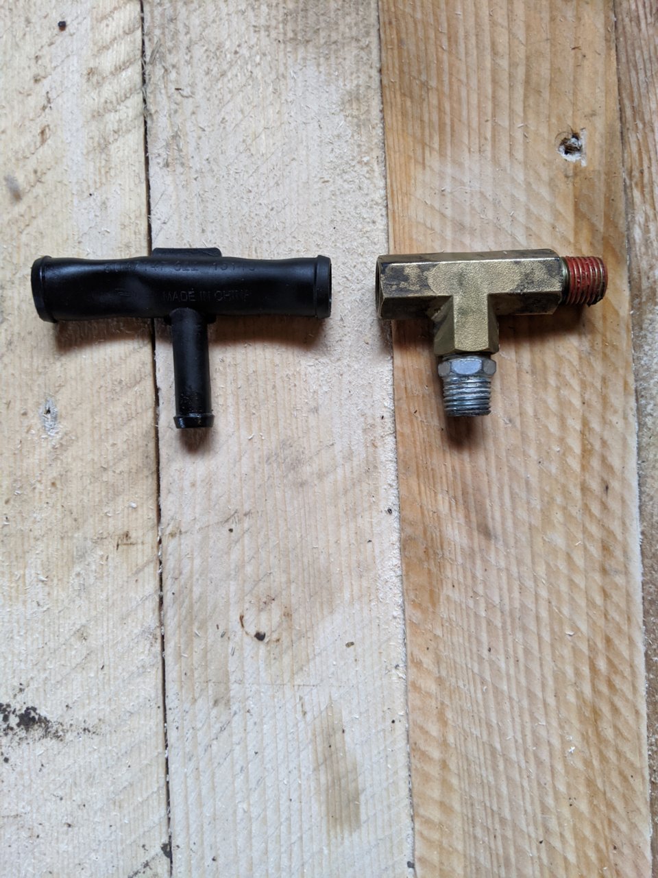

    Also this plastic T wasn't far from having the same fate as the one at Goose did. @Squeaky Penguin your brass T served me well. Finally found some steel replacement T's.

    Finally replaced the goose trail fix?

    Yep

    I hope you hang onto that brass air fitting. Maybe it will come in handy again. :D

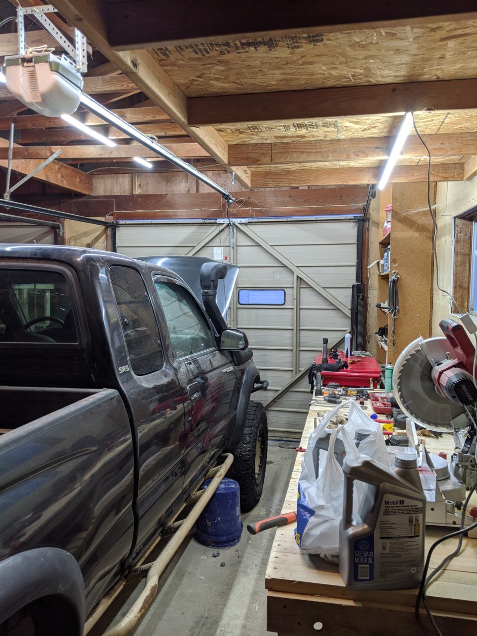

    Checked valve lash and found 1 on the exhaust side and 2 on the intake side to be out of spec. Decided to order the SST for removing the shims since it would be a pita to pull the intake cam off. Naturally it was cylinder 4 that needed the work and the most difficult to access. IMG_20200205_153218.jpg
    Put the cover back on and went to pull a plug and discovered that there was an inch and a half of oil sitting in the tube. I'm hoping it was just getting pushed past the seal and it'll be fine now that the vents aren't clogged. Hopefully by the time I go to start it that oil drains past the piston rings so I don't bend a rod...

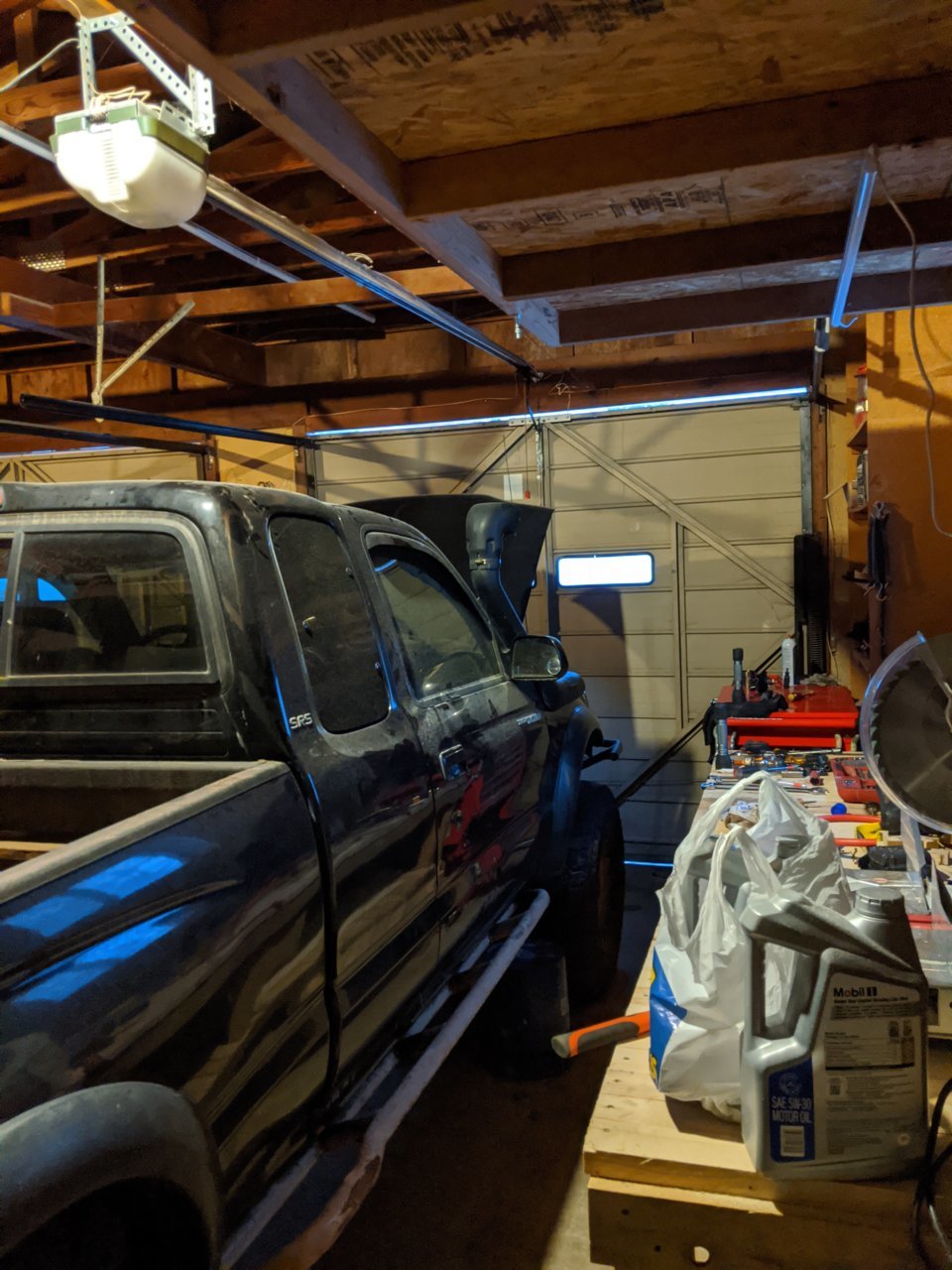

    Installed some cheap LED tube lights in the garage so I can actually see to work on things now. Definitely nice not having shadows everywhere.

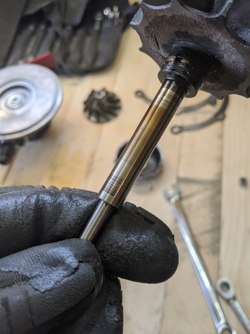

    Thought I had the turbo problems figured out but apparently not. Pulled it off and found very light scouring on the turbine shaft. There not enough play to cause the blades to contact the housing but it's enough to feel. There was quite a bit of oil sitting in the compressor side housing. Plenty of oil on the exhaust side as well. I'm hoping the problem is just a simple rebuild. Still more money than I'd like to spend right now. Did find a crack on the manifold as well. Easy fix I think. Pipes are stainless but the welds are not.
    Debating if I want to revert back to NA and fix everything else so I can use the truck this summer or not.

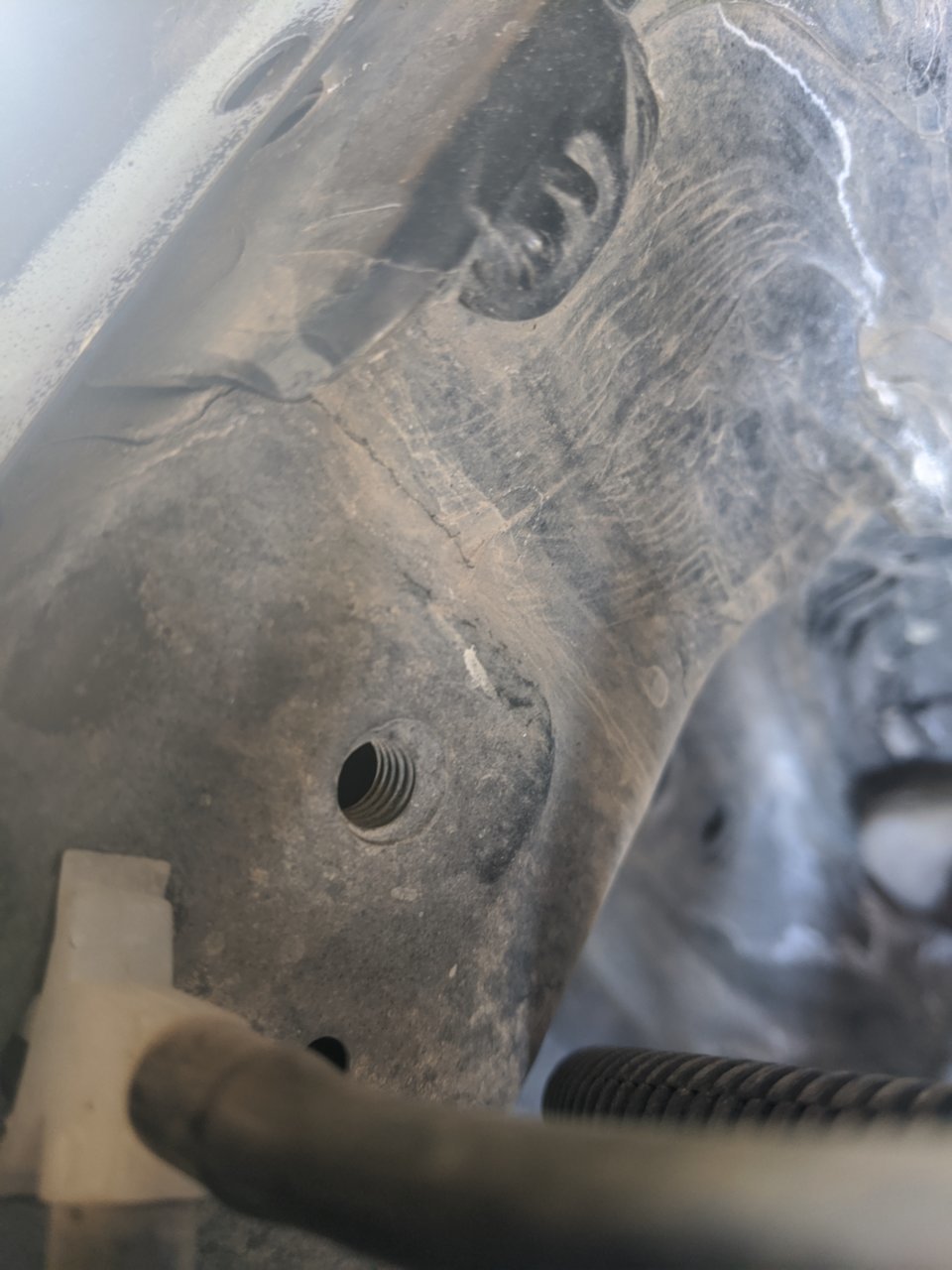

    Found moar crack too! o_O Passenger fender near the firewall.
    You know it's a shitbox because the way it is
