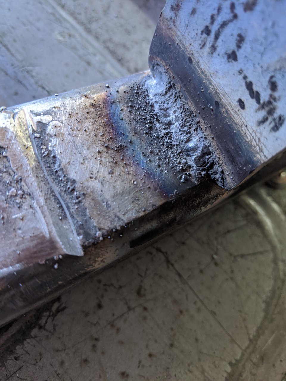

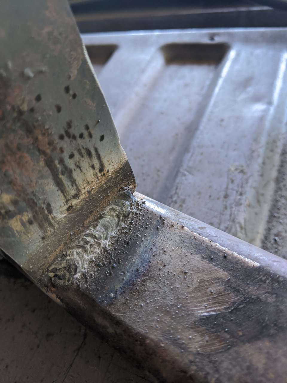

    Playing with the welder a bit today. It works! Need to run a good bit more heat than what it recommends though. This should suffice for my projects for awhile. IMG_20200321_130349.jpg IMG_20200321_130400.jpg IMG_20200321_130514.jpg

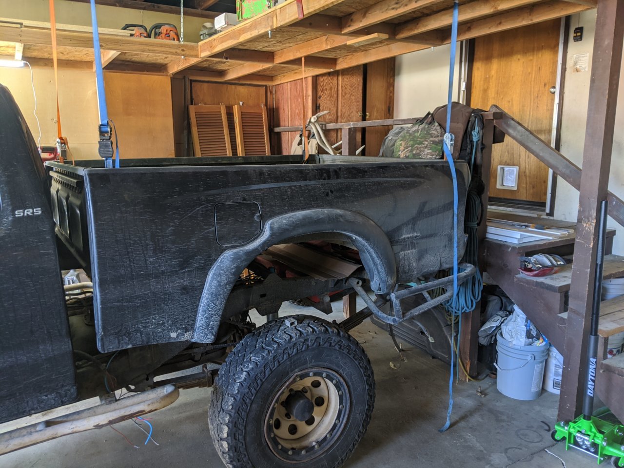

    Pulled the bed and started taking measurements for the bed crossmembers. I'll be completely cutting the old out and using 11 guage steel for the new ones. From what I can tell that's almost twice as thick as stock. Think I may draw them up on CAD and send them out to be laser cut so that I don't have to drill all of the holes and they'll be able to be replicated for others. Unsure if I want to use bolts or rivet it to the bed floor. A little worried that rivets would loosen up over time. IMG_20200321_132147.jpg
    Hopefully my Chinese turbo is here Monday so I can move the truck out from under the bed to the other side and begin prepping to recoat it. It didn't take long for the mag chloride or salt to start eating at me frame here. :mad: I HATE THAT SHIT, it's vandalism.

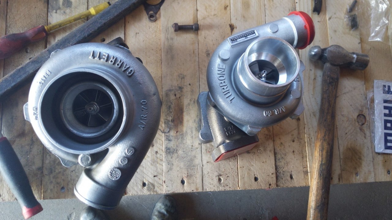

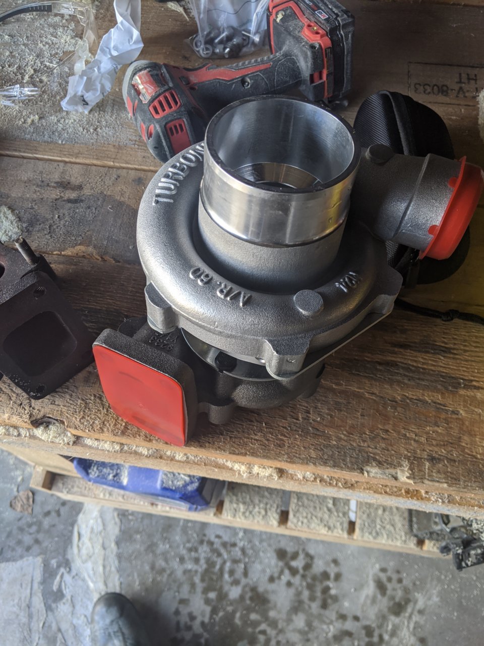

    Well completely frankensteined my turbo. Bought a. 48 turbo off ebay with hopes of just swapping the turbine housing for my cracked one since I couldn't find just the housing or an affordable t3 t04e 48ar 70ar anywhere. The serial numbers on my turbo didn't match anything I could find that came equipped on anything. Any who the turbines were ever so slightly different so the new housing would not sit all the way down without contacting the turbine. So I disassembled the the other turbo, put that turbine and shaft into mine and everything seems to good.
    I'm probably going to regret it but if it works it works. If I was building high boost I'd be worried about balance but for now I'm not. I was actually surprised to see balance marks on the ebay turbo. I would have just used that one but the inlet and outlet are smaller than my current setup and I didn't want to rework everything again.
    Comparison of the 70ar and 60ar

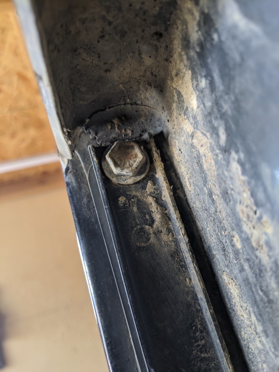

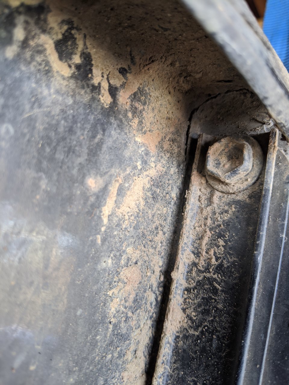

    @Wheelspinner you've really got my brain turning on the flat bed idea again. Finding more cracks is making it difficult to want to put the effort into these crossmembers. IMG_20200327_131556.jpg IMG_20200327_131603.jpg

    This is where my head is at. I’m not there in person to see what all actually needs to be done to your bed but in my mind if the repairs needed are about half the work it would take to build a flatbed is already be doing it. Plus in my opinion it’s sometimes easier to start from scratch than it is to make repairs, especially when rust is involved. Sometimes cutting out a 6” part that’s rusty results in a 12”+ hole to get to weldable Metal. And what you said about putting a snowmobile on a flatbed is exactly what I was thinking the first time I suggested it. I’ve owned a couple trucks with flatbeds an the usefulness and options are endless. I’m actually fitting one on my 79 f350 as we speak lol. The hardest decision you are gonna have to make is if you want to try and make it work with your habitat, or go with a rack/Aussie style canopy and an rtt or something else. The good thing with a flatbed is whatever you choose you can make it removable and have the option to drive out from under it if you put a jack on each corner. I’m hoping in the next year or two to do this on my tacoma :popcorn: On your decision

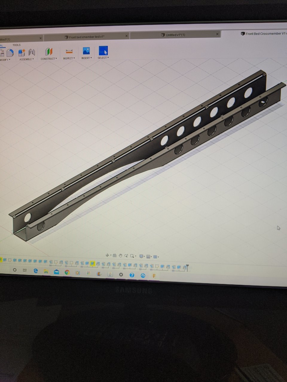

    Finally think I got the front crossmember drawn up. It was a pain confirming that the holes were all in the right place using my 8.5x11 printer . I didn't realize when printing straight from Fusion 360 it would print to fit and not actual size the first few times. The next two should go quicker now that I'm familiar with Fusion and parametric modeling. IMG_20200328_193902.jpg
    I could probably buy the materials for a flatbed for what these will cost to have laser cut but I don't think I'm ready to go down that road yet as tempting as it may be.
