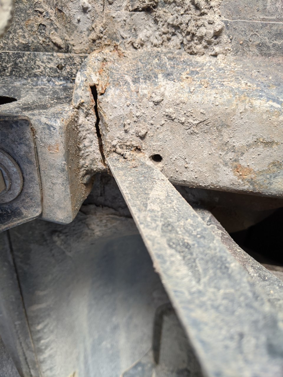

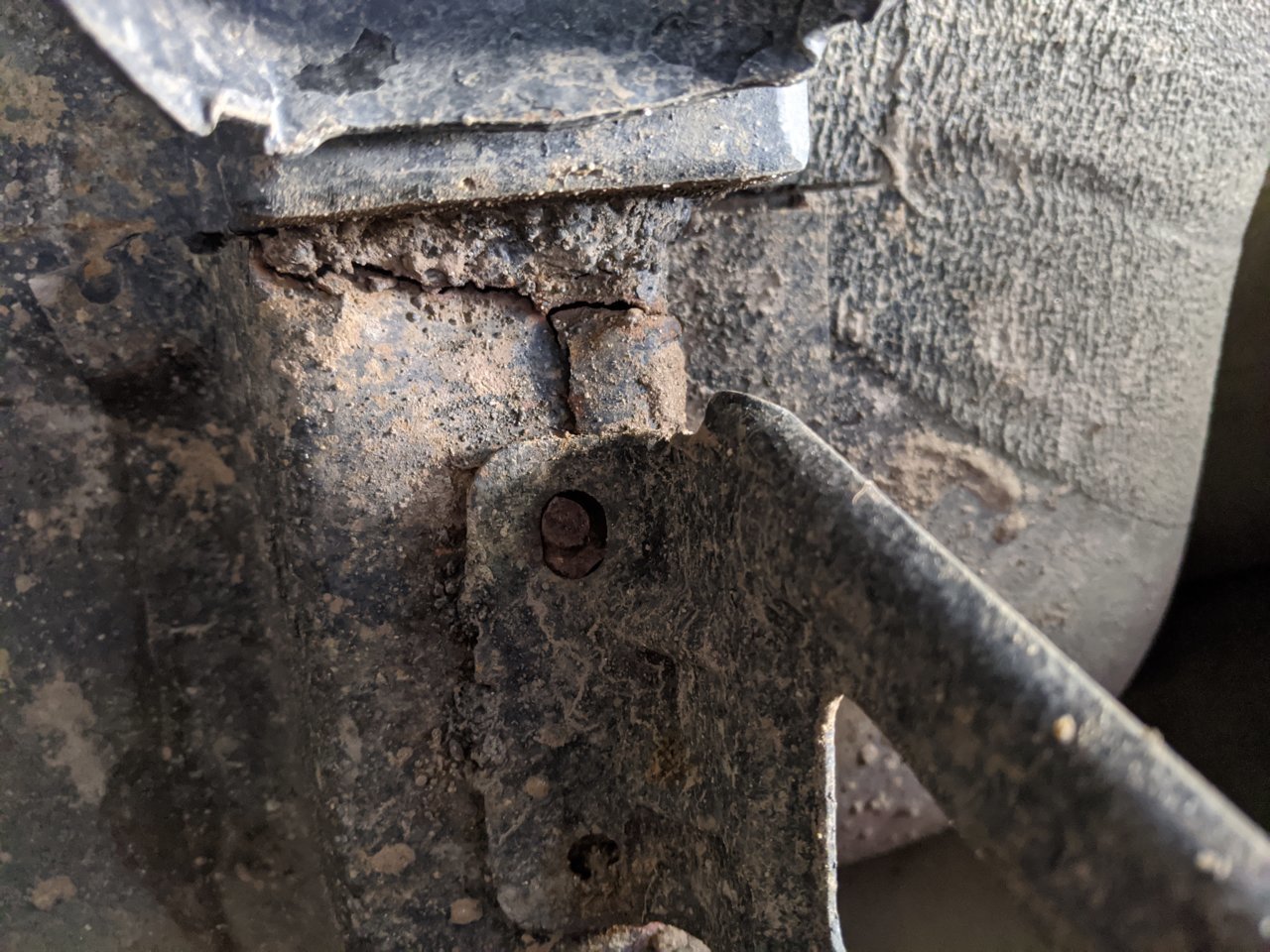

    What part of the axle housing failed? Wondering if it's the same spot mine did.
  4. Jun 17, 2020 at 8:09 AM
    #1164
    Reh5108
    Reh5108 [OP] Well-Known Member
    Feb 18, 2013
    #97832
    5,805
    Idaho
    2004 SR5 4X4 2.7L Extra Cab
    OME lift, 4x sliders, Demello rear bumper, custom front bumper, Engo 9000lb winch
    The passenger side spring perch on the inside at the weld.
    Jiveydude[QUOTED] likes this.

    Zero fucks left

    wait didn't you just fix that spot?

    That's extra shitty.
    I need to go look at mine and see if it cracked right next to the repairs.
    Without pulling the bedsides, there's no way you're going to reinforce that piece correctly.

    Yes, but like Brett said the fender needs to come off and that whole brace needs to be remade out of something thicker than 18 guage. I honestly didn't expect it to hold up. Might be able to get away with plating it but I think it's just going to tear at the end of the plate again.

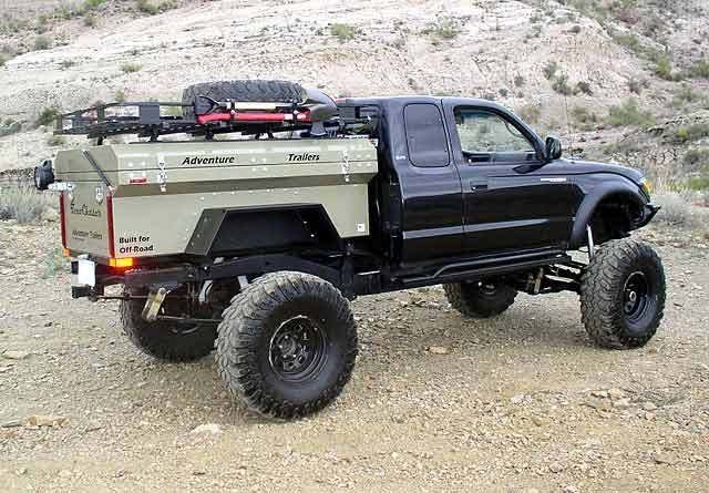

    I remember seeing a black extra cab on Google a while back, and it had a military trailer as a bed. Seems like this would be a good alternative to the stock bed. It even had a topper of sorts on it.
    m3bassman and razhick4x4 like this.

    more on this idea, i think that @POSTacoMike is planning on putting a logger bed on his truck once finishes up his cab conversion. real similar to military trailer bed.
    POSTacoMike and m3bassman like this.

    I think some sort of simple bedcage that ties the frame into the bedrails would work and be a lot simpler than a custom flatbed/tray/military trailer thing.
    Guessing Ryan wants to keep the nest too.
    Or burn it to the ground. I know the feeling.

  17. Jun 18, 2020 at 5:15 PM
    #1177
    razhick4x4
    razhick4x4 Well-Known Member
    Oct 31, 2018
    #271261
    636
    Alex
    MT/WY
    2004, Tacoma SR5 Xtracab TRD, 4x4, Red, 5spd. V6
    ARB Bumper, 3" Toytec/OME lift, 33s, Sliders, ARE Topper, Ditch Lights, Hella LEDs, Trigger controller, CB, Pioneer Radio
    that looks awesome, this is the one that @POSTacoMike is using. not sure when he'll actually get his on though as he's only just gotten the cab bolted down onto his frame (did a extra to dbl cab swap)
    POSTacoMike[QUOTED] likes this.

    I don't want to add more weight though. I think that's half the problem. Idk how expo'd out second gens aren't having the same axle housing issues unless it's thicker. Or the mall just isn't as tough on them.
