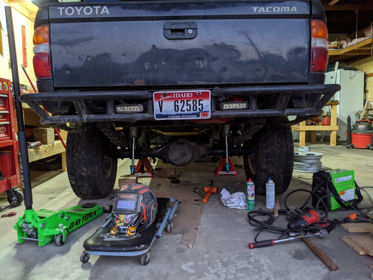

    OME lift, 4x sliders, Demello rear bumper, custom front bumper, Engo 9000lb winch
    Shitty mcshitbox is back to sitting on her wheels! Still need to install the brake lines, fill the diff, attach the lower shock ends and put my highly customized fuel tank back in. IMG_20200721_213511.jpg

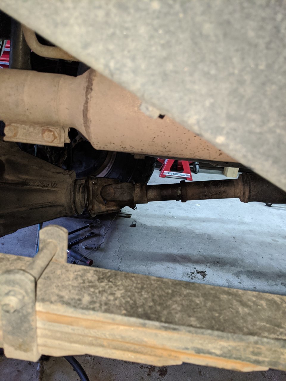

    Not quite. I totally miss calculated my pinion angle. Might try some shims but I might be back to square one and cutting off the perches again... :frusty:

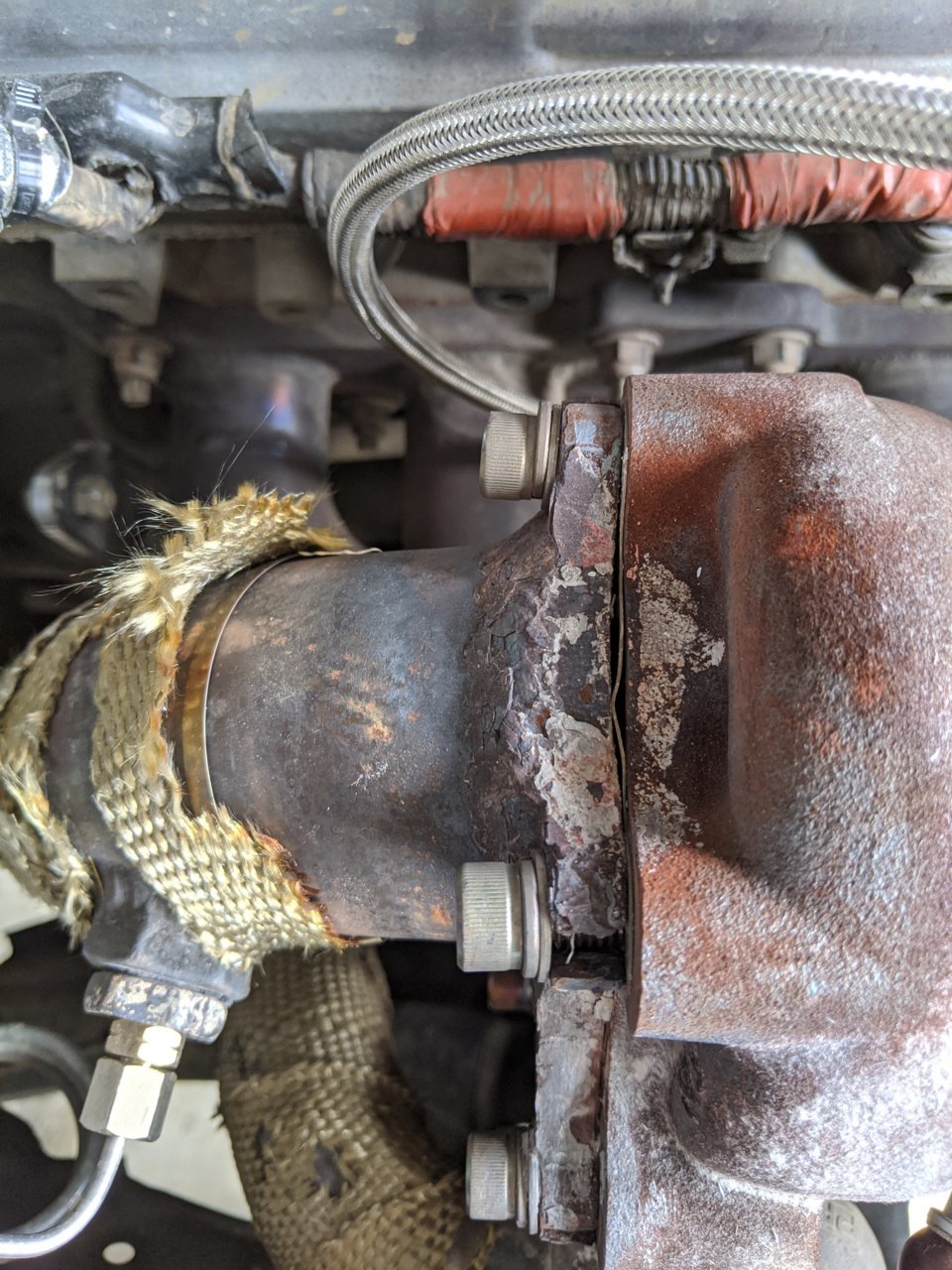

    Found my exhaust leak. Hoping I can just cut the flange off and replace it.

    The Trifecta of Taco's
    Bummer. How'd you mis calculate?

    Torspd Custom Turbo kit [] Borg Warner 9180EFR Turbo [] Haltech Elite 2500 [] TiAL Q BOV [] TiAL V44 Wastegate @ 15psi [] CP Pistons [] CP Carrillo Rods [] ARP Head studs [] ARP Main Studs [] ARP Header - Head Studs [] Ported Heads w/ 1mm oversized valves intake/exhaust [] Brian Crower Forged Stroker Crank [] Darton M.I.D. Sleeved Block [] Kelford Camshafts [] Torspd 160* T-stat mod [] APR Large Fuel Rail [] Walbro 460 LPH E85 Fuel Pump [] FueLab FPR [] APR T56 Conversion Kit [] KP RACING Built T56 [] McLeod Racing Custom Twin Disk Clutch [] One Piece Aluminum Driveshaft [] MGW Shifter [] Custom lowering kit [] Ohlins Front Coilovers [] QA1rear shocks [] Custom Ron Davis Radiator [] Dual SPAL Electric Fans []
    Good opportunity to swap in a stainless flange. Just take care to prevent the warpage, and it'll last sans scales.
    Not completely understanding the process and also measuring with the jack stands on the springs so the angle was different than when the springs are weighted at the center bolt.
    Went with a mild one again. Hoping it last me a little bit, going to leave the blanket off. I'd like to get a cast manifold at some point. I did get another flex pipe that should flow a bit better than the current one. I'm finding it hard to believe that at only 3psi things are getting too hot still. That's basically sea level pressure. Could potentially have a clogged cat as well.
    This looks much better. 0.2* difference between the shaft and pinion. Pinion is up 2* from the factory. Kind of surprised it wasn't more . Hopefully I'll burn them in tomorrow after work and get axle back in. Then onto the downpipe... IMG_20200727_211455.jpg
