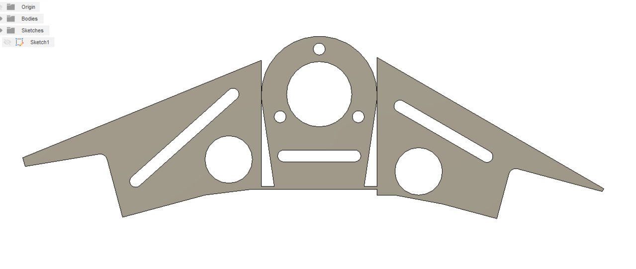

    One final paper template tomorrow and I think this will be ready for the laser cutter. I'm not to sure on how well the bends will work since they transition from a small to large radius.passenger coilbucket gusset.jpg

    Those are looking dang good Ryan. Only one way to find out how they will work.

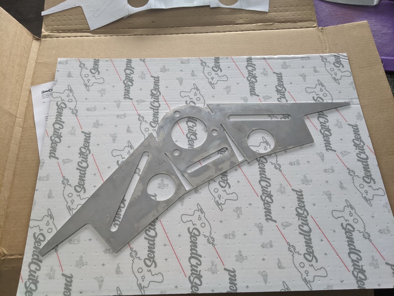

    Slowly getting the small things fixed on the shitbox. Did away with the crappy exhaust band clamp connecting the down pipe to the rest of the system. Installed a Vband. Hopefully that gets rid of my P0420 code I've had for what seems like forever. Might add one to the short section after the muffler as well, that one leaks too. Small complaint with the Titanium 125, it doesn't feed well at all when its 20-30 degrees in my garage. Brought it inside for the night and it worked perfectly the next day.
    Replaced the front output seal on the tcase. Found that someone used fpig on the splines :rolleyes:. The seal installed didnt feel very snug on the shaft so I shall see if something else needs to be addressed.
    Apparently on the last trip I hit my passenger side ITR on something and tore the boot. Fortunately I had a spare and swapped that out while the rest of the suspension is apart awaiting the coilbucket gusset which should be here tomorrow. :fingerscrossed:

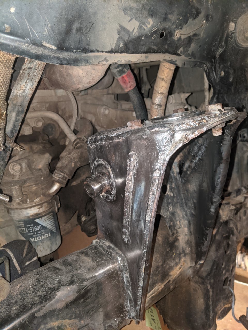

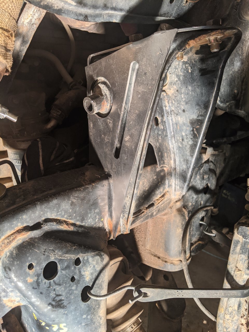

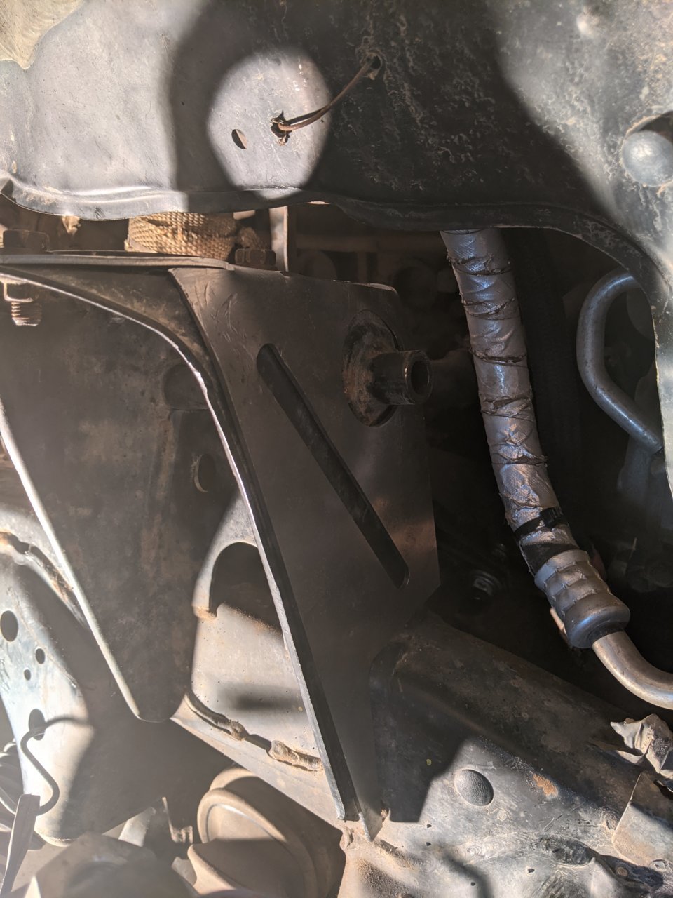

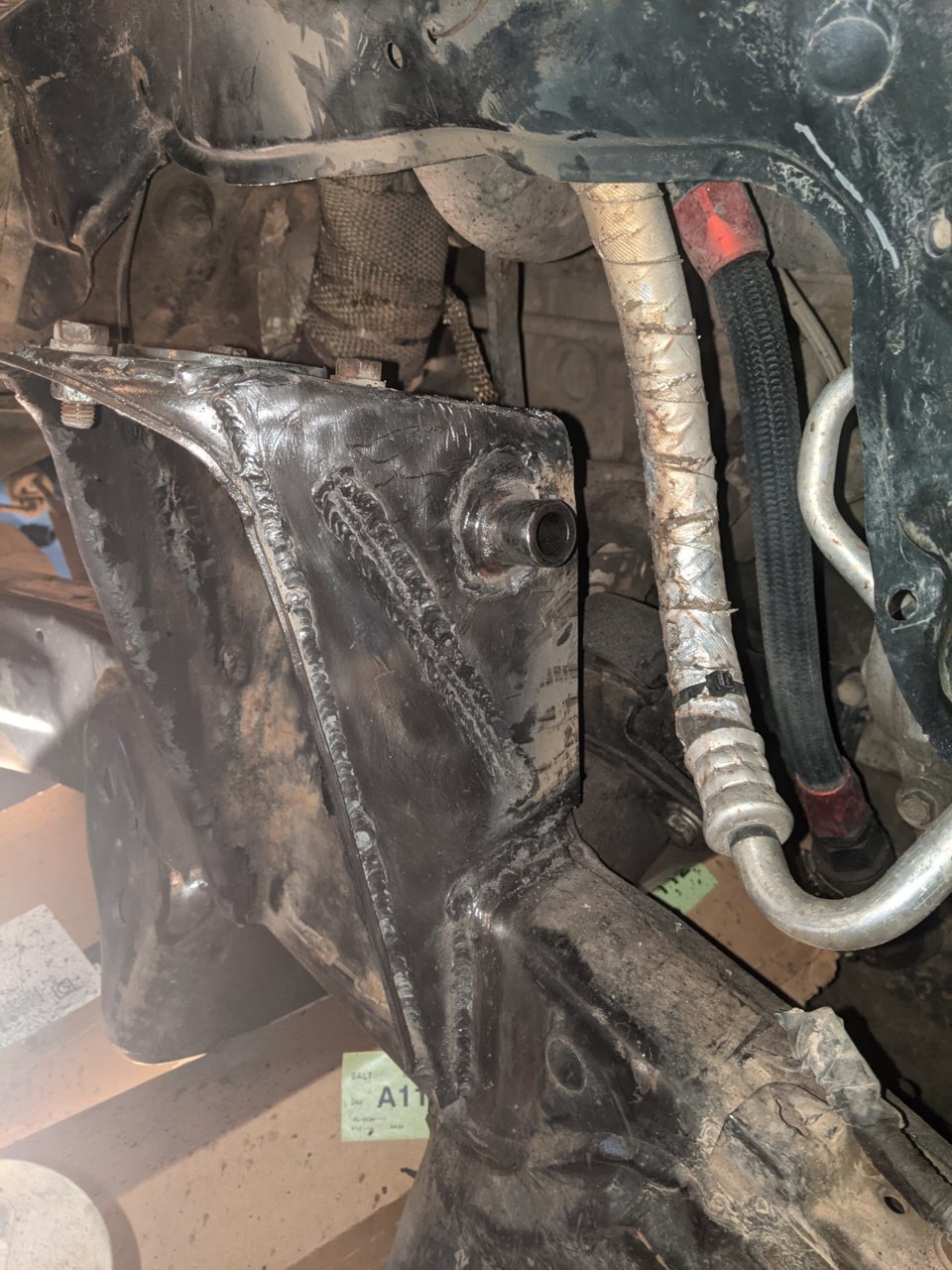

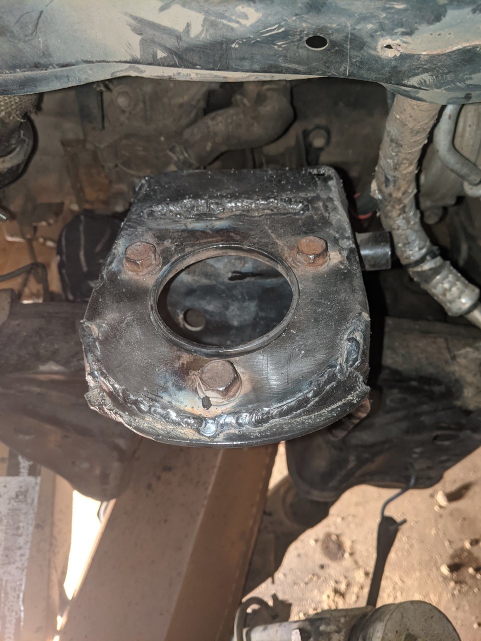

    Template turned out pretty damn close. I didn't need to take a grinder to it. It was a bit of a pita to fit it over the UCA tube ends but it worked in there. I did ubolt the cab mounts and lift up the cab to make welding a little easier. Getting it in there probably would have been easier with the extra room also. Any high spots were easily hammered into submission and then tacked and moved on to the next spot. Debating if it's worth pulling the motor to weld the back sides or not. Hopefully I can use this same template on the driver side also.
    PXL_20210122_190726984.jpg PXL_20210122_201054950.jpg PXL_20210122_201102883.jpg PXL_20210122_225347034.jpg PXL_20210122_225355197.jpg PXL_20210122_225400315.jpg

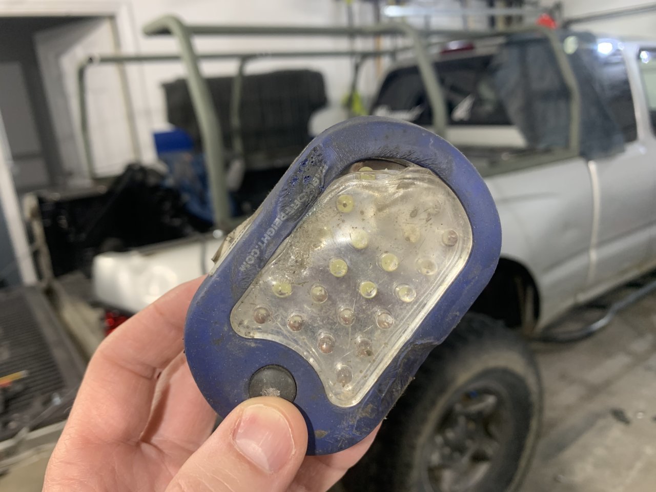

    This little light of mine got a little hot. HF freebiePXL_20210122_225648013.jpg

    I didn't realize you committed to burning it on.
    Reh5108[QUOTED][OP] likes this.

    Solid work! :thumbsup:
    I know how much of a PITA it is welding in the wheel well.
    Reh5108[OP] likes this.

    I was able to weld be back sides through the engine bay...mostly. be way better with the motor out but thats no walk in the park either..
    Solid work though man!
    I'll be pretty surprised if you can use the same side on the passenger side.

    I've got a pesky turbo in the way and pulling the engine sounds more appealing than unbolting that thing again.

    Damn I never thought to lift it off it’s body mounts for easier access. That’s a really good idea. Did you just loosen the rears and lift the front or lift it all? I’ve never replaced my mounts before so not sure how people usually do it.
    also twinning, I think this happened when I did my uca gussets.
