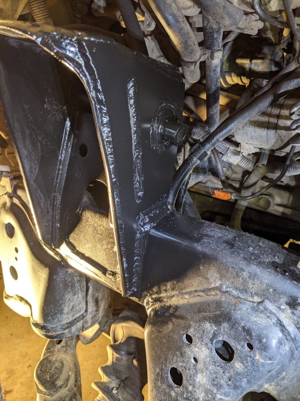

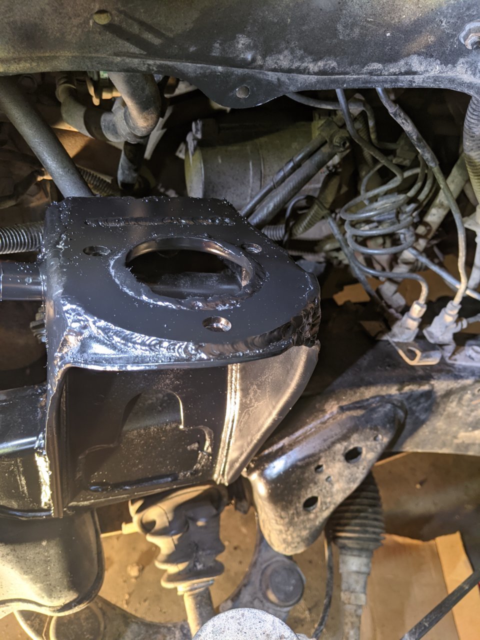

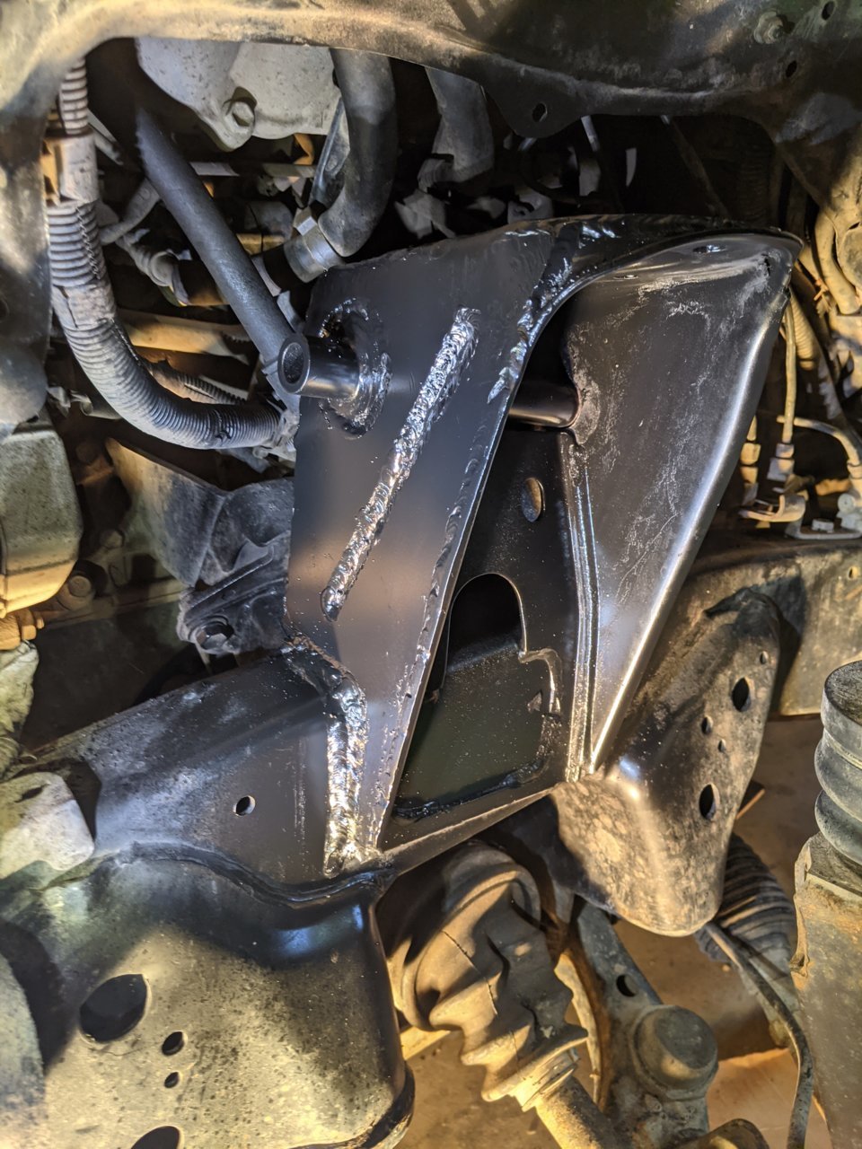

    Drop bracket lift and booger welds
    This is with the cab lifted again? Jesus you have clearance for days to get in there.

    Yes. Just wait until your head is in there or you need to weld the edges not facing you. It might be able to go higher if the radiator shroud is removed.

    Oh I know all about it when I did the TC gussets and the top plate gusset from Eimkeith, it was a bitch. I ended up welding the back of the top plate gussets from inside the engine bay. I can see the back side of those going down the tower being more difficult though, you almost can't weld the back side of the TC gussets unless the engine is out.

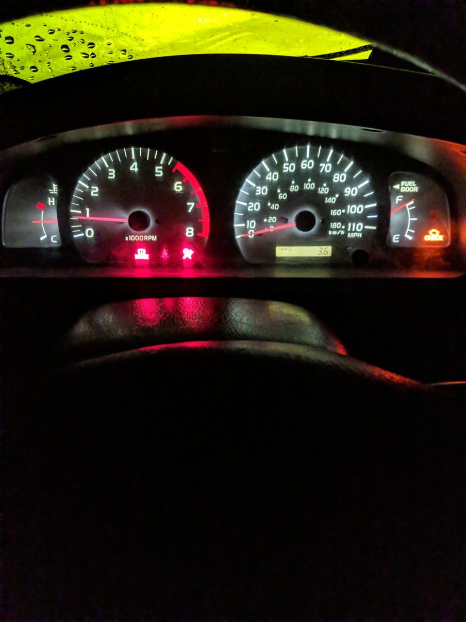

    Finally got around doing the tac weld mod to the steering column. It made more of a difference than I thought it would.
    Found another crack in my core support... P0420 is still hanging around.
    Replaced my green led dash lights with white because that's what I had leftover from replacing some dead ones on the T100. I'm not sure why the green quit working. Occasionally I'd see a flicker of green but they never stayed on.

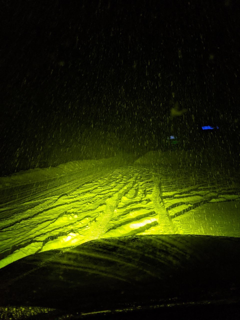

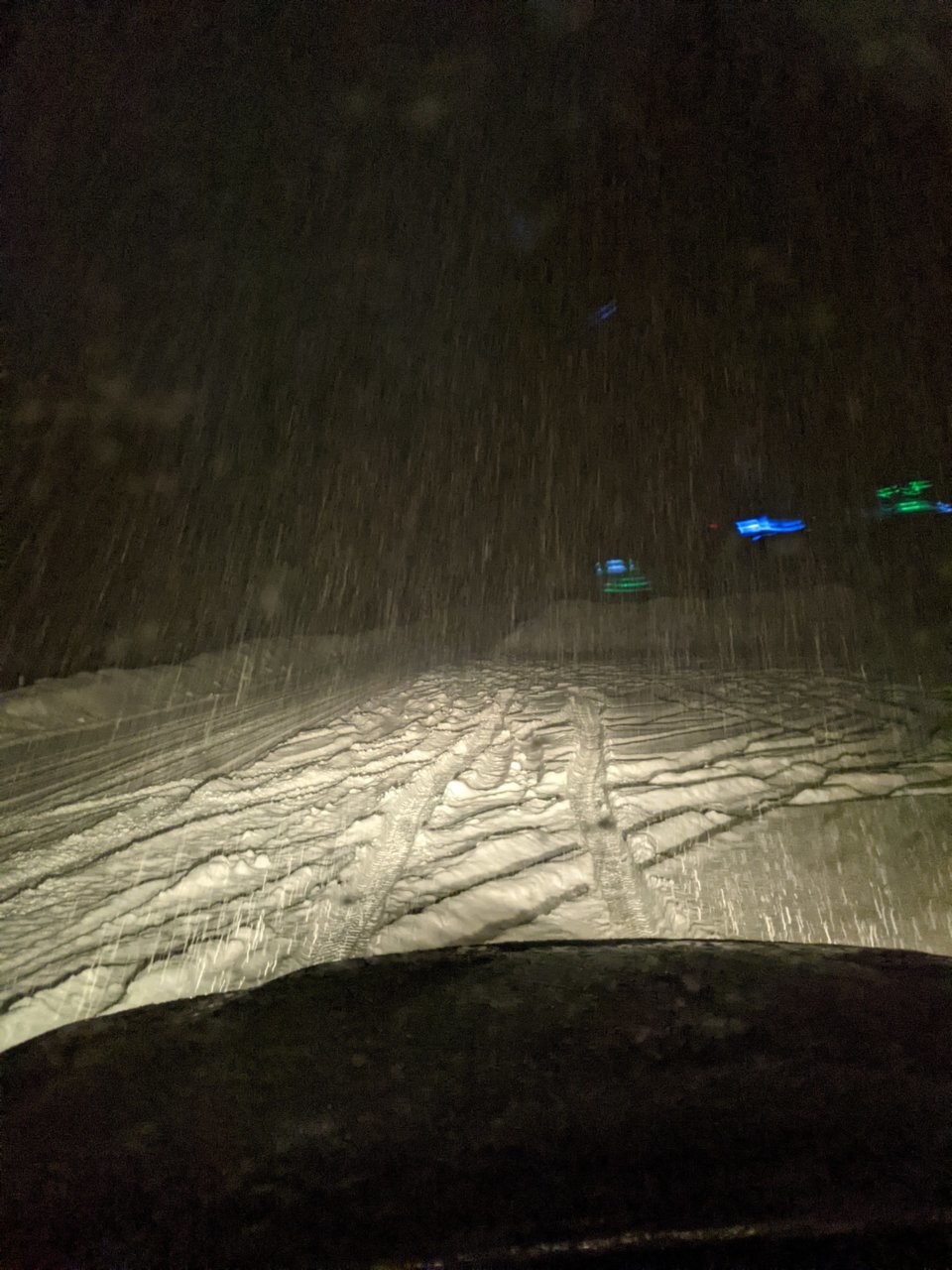

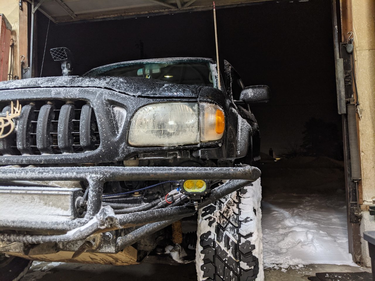

    Installed some fog lights also. May end up moving them closer to the center.
    Fog lights
    Headlights
    Not sure if there is much of a difference between the headlights and fogs. The fogs are about useless in the snow after a few minutes of driving as they are not hot enough to melt it fast enough.

    Those even real fogs? haha
    That's why bought the Pro SS3 C2 fogs. They will melt the ice.

    :notsure: Cheap Amazon lights, honestly wasn't expecting to much from them. They are listed as "flood beam"
    What constitutes a "real" fog?

    Judging from the light pattern they are just floods. I wouldn't drive with those, you'll piss of every person driving in the on coming lane.
    Real fog lights have a very wide and very sharp cut off. They are meant to light underneath the low beams. Not supplement them like another low beam.
