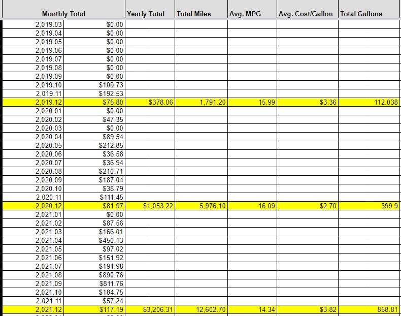

    Not too much going on with this turd lately. Replaced a front wheel bearing in hopes that was the cause of my vibration but it wasn't. I hate just guessing at problems. Overall for the amount of miles I put on her, she did pretty well. I don't think the bed falling apart has gotten any worse and the crack repair to the axle still seem to be holding. I'm hoping the drop in mpg is due to a lot of 80mph driving and not a sign of a tired engine.

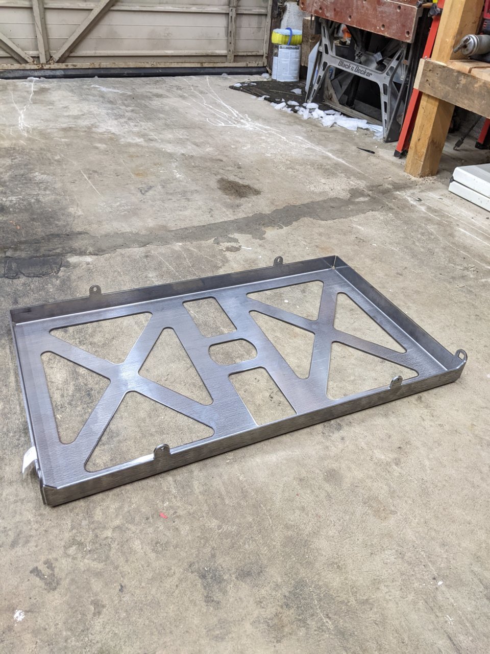

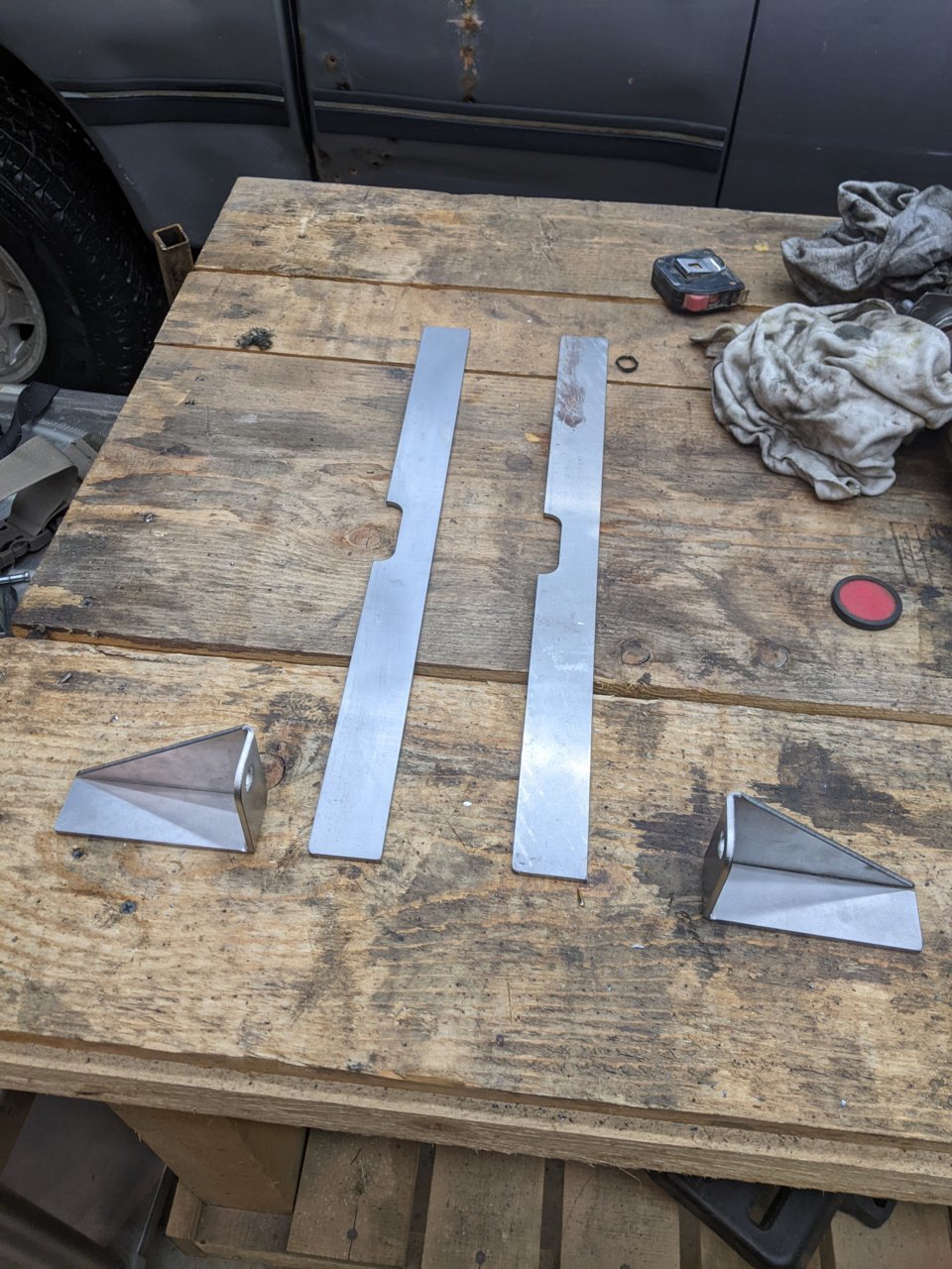

    Finally went ahead and ordered this. The main piece is from oshcut and the smaller from sendcutsend. SCS was received a day sooner.
    The two companies have different tooling. SCS was unable to bend something as long as the carrier and oshcut was unable to bend the brackets because they interfere with the press finger. They show a 3d animation of the parts being bent which is kind of cool. SCS is the more affordable route.
    PXL_20220108_010637945.jpg PXL_20220109_035617985.MP.jpg PXL_20220109_035706284.jpg
    I'm always anxious that I measured something wrong and just tossed money in the can but so far this is looking pretty good!

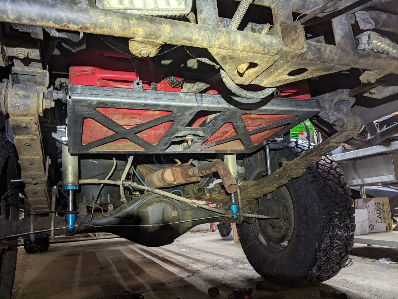

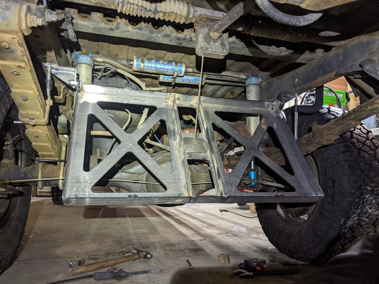

    Stoked on how this is turning out. Needs a few small tweaks to the CAD file to be perfect.

    So far you're only the second person I have seen do this besides @cynicalrider. Probably the best way i have seen that space utilized. Awesome work!
