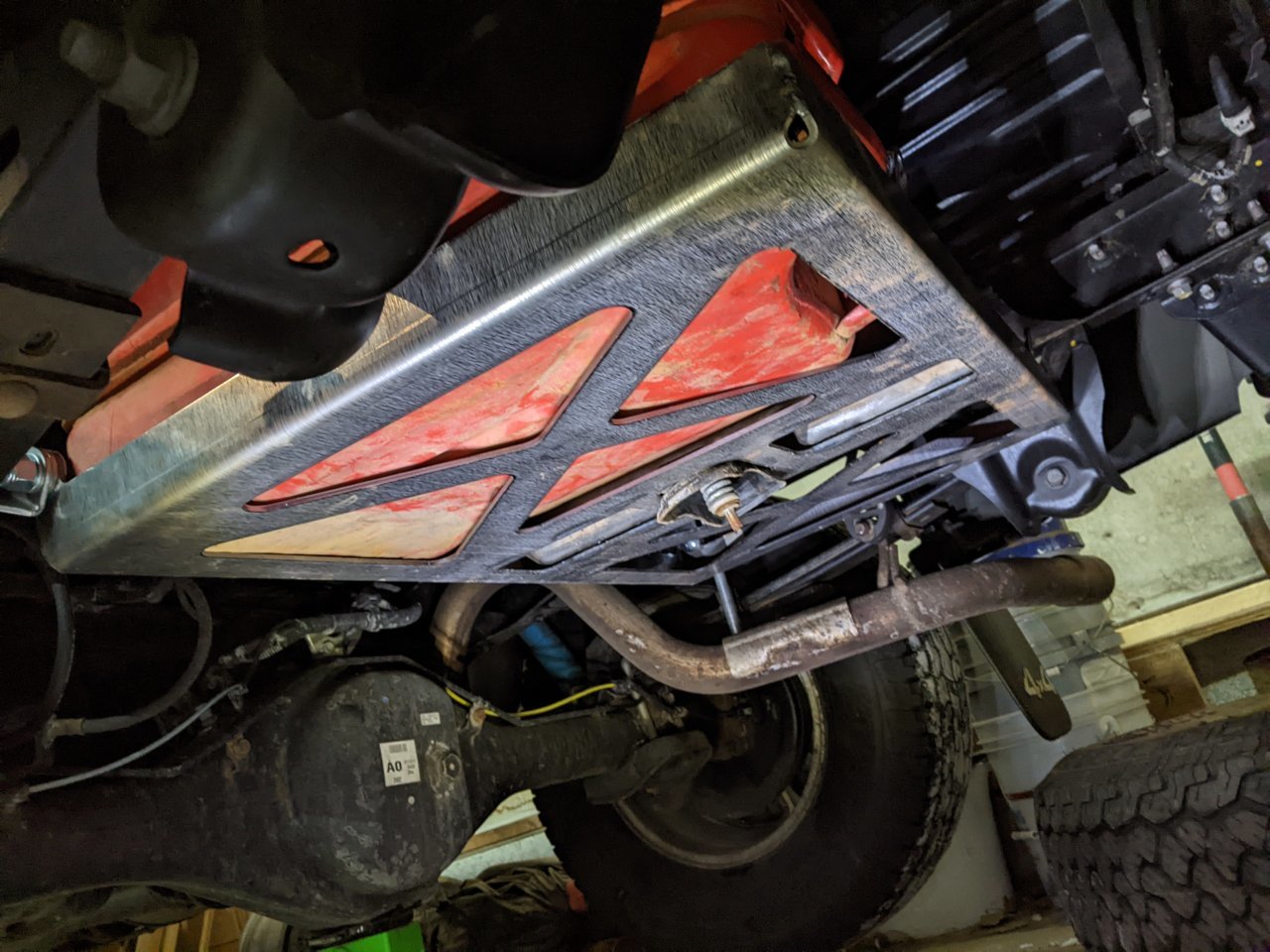

    Here’s one for my dual battery tray. I deleted the tire carrier for the shocks so I am looking at ways to reconfigure a winch. That’s a great use of the stock tire winch.

    The imagination is the limit to what you can put there.

    Looks like it may work on 2nd gens as well. Just need some slightly taller brackets.

    Close! I think the longer brackets would actually work better on a first gen that has the factory crossmember member there also. Need to confirm before I order a bumch to bring the cost down.

    Yeah this is sweet Ryan. I might be interested in it. Would mean i'd need to get a swingout for the spare tire though..will think on it. Was considering doing what timmy did and just doing a swing out for the jerrys.

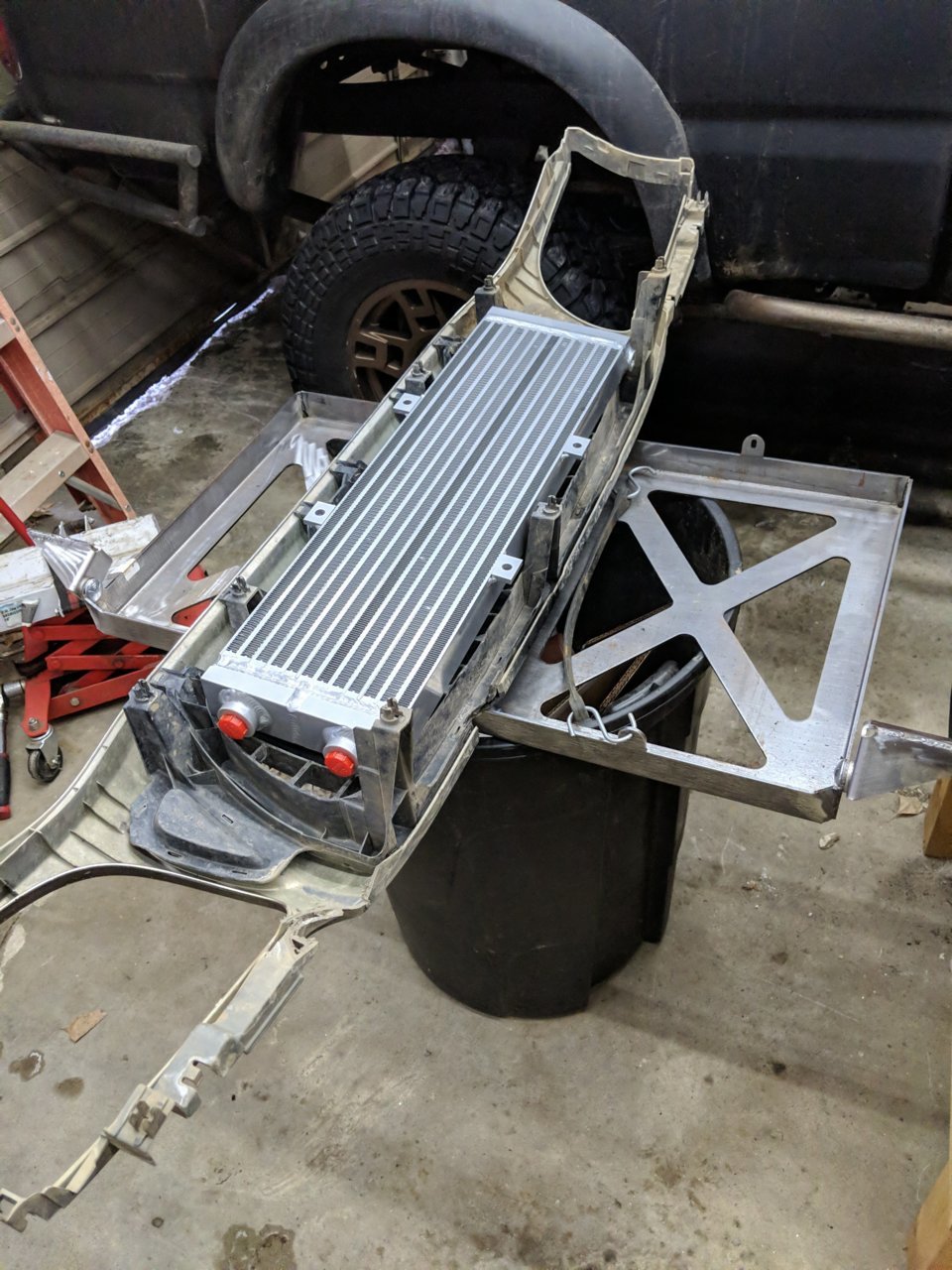

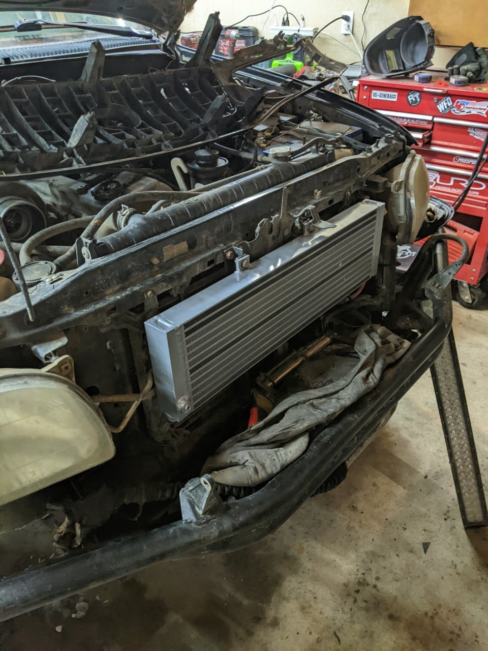

    Finally getting around to intercooling this pile. PXL_20220206_233609358.jpg
    Pretty good fit with the grill.

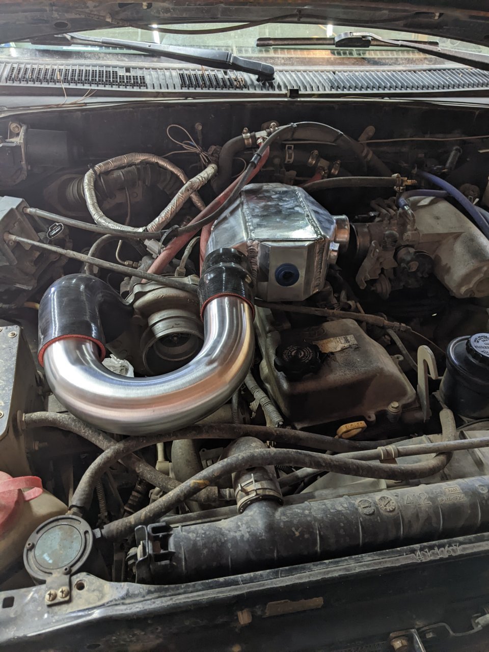

    Nice. Some one finally doing it right and using the grill for the IC. looks good. Although are those tiny red plugs the in and out ports?

    For the water :)

    Damn that's a nice fit.
    Who makes that intake part?

    I meant the metal part just before the TB

    thats the water to air intercooler.

    Ya ya I got that now, but who makes it?
    They don't look like off the shelf parts
    edit: I also don't know of any companies really making turbo stuff for the 3rz platform anymore.

    Exchanger: http://www.siliconeintakes.com/elec...FBowusdhHTDyp1iTLN1UKx9sXywlUH-0aAqAoEALw_wcB
    Intercooler: http://www.siliconeintakes.com/front-mount-intercooler/water-to-air-intercoolers-p-213.html
    Found that in like 1min of googling haha
    Might not be the exact sizes he used. But that place has lots of options to choose from.

    @Blackdawg nailed it. Nothing about my setup is meant specifically for a 3rz. Im hoping to get a Treadstone cast manifold if they ever end up back in stock. Mine keeps cracking everywhere. LCE is probably the place to go if you want off the shelf stuff. Koracing I think is another that offers a 3rz turbo setup.

    Oh jeeze my bad. Didn't realize silicone intakes makes actual intercooler stuff. I just assumed it was all literally silicone intake parts lol

    Well the packaging looks like it should work out well. That heat exchanger fits pretty money in the grill
