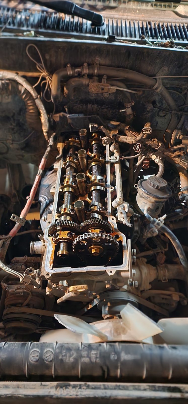

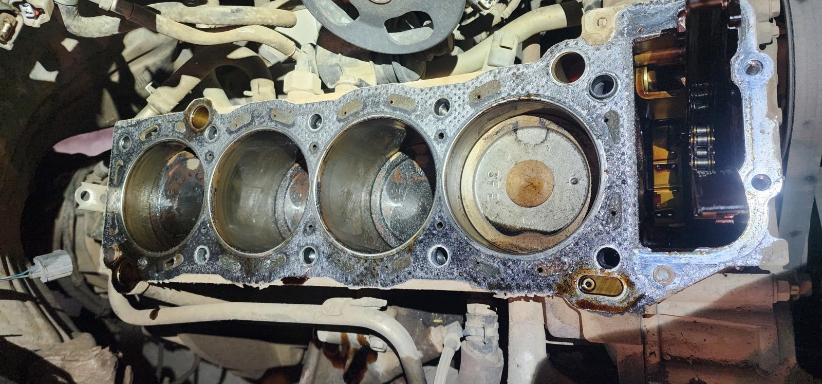

    Well, so far I haven't found any cracks in my head. Think it may have just been a failed gasket. Small spot above the number 1 exhaust valve. I'll take it to work and toss it in the parts washer to clean it up and then dye penetrant for cracks. Hoping it's not warped either.

    Sure looks like a crack between the valves on the photo. :notsure:

    It definitely does in that picture but I cleaned off the carbon and it looks fine.

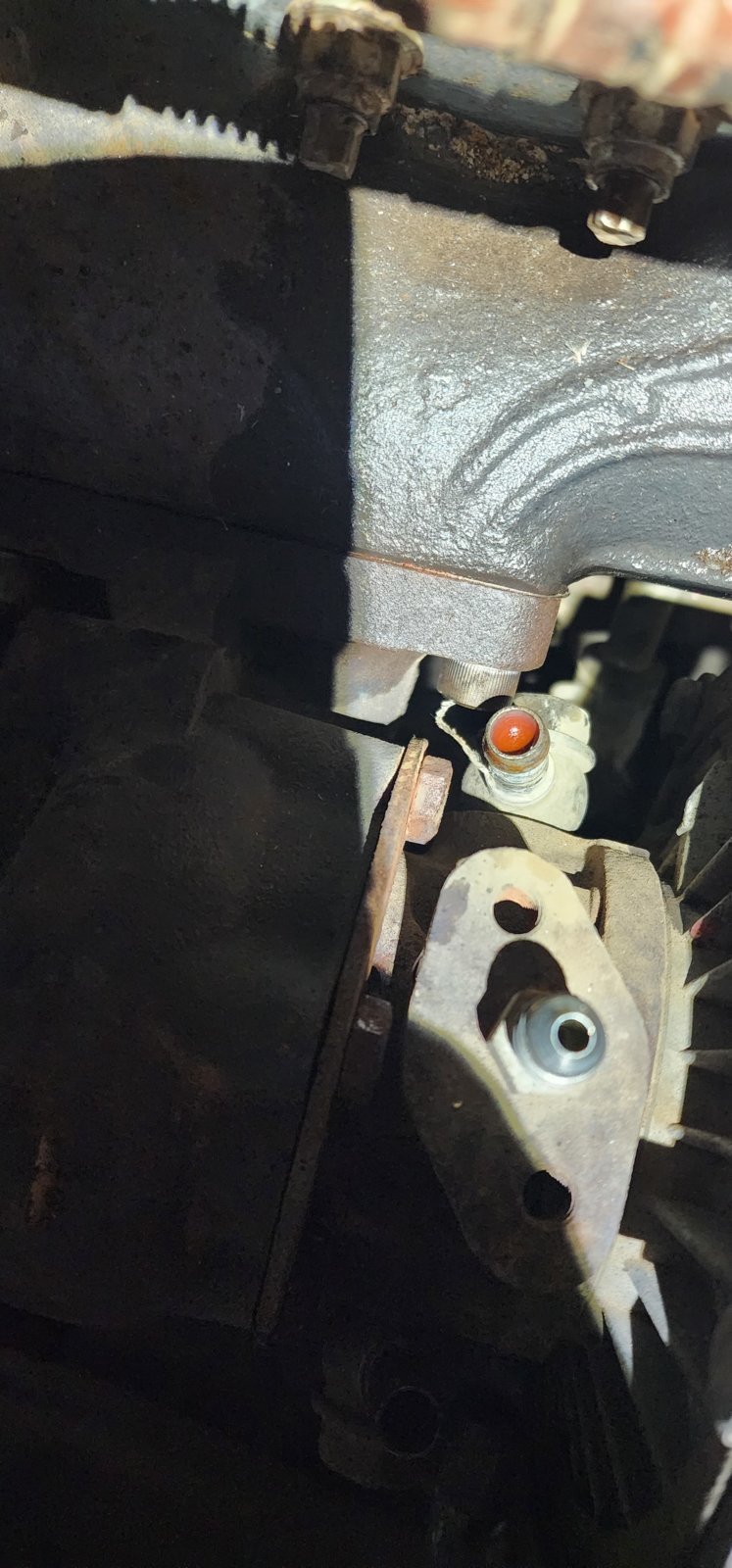

    Well the shitbox has been back on the road for about a month now and everything seems to be good. The reman head has some issues that needed some attention but I guess that's what I get for trying to go cheap. One of the cam cap bolts pulled the threads and the valve lash was off on a few. Nothing to serious but I was expecting to drop the head on and go. About to embark on a roughly 6000 mile trip in a week. Hopefully everything holds together.

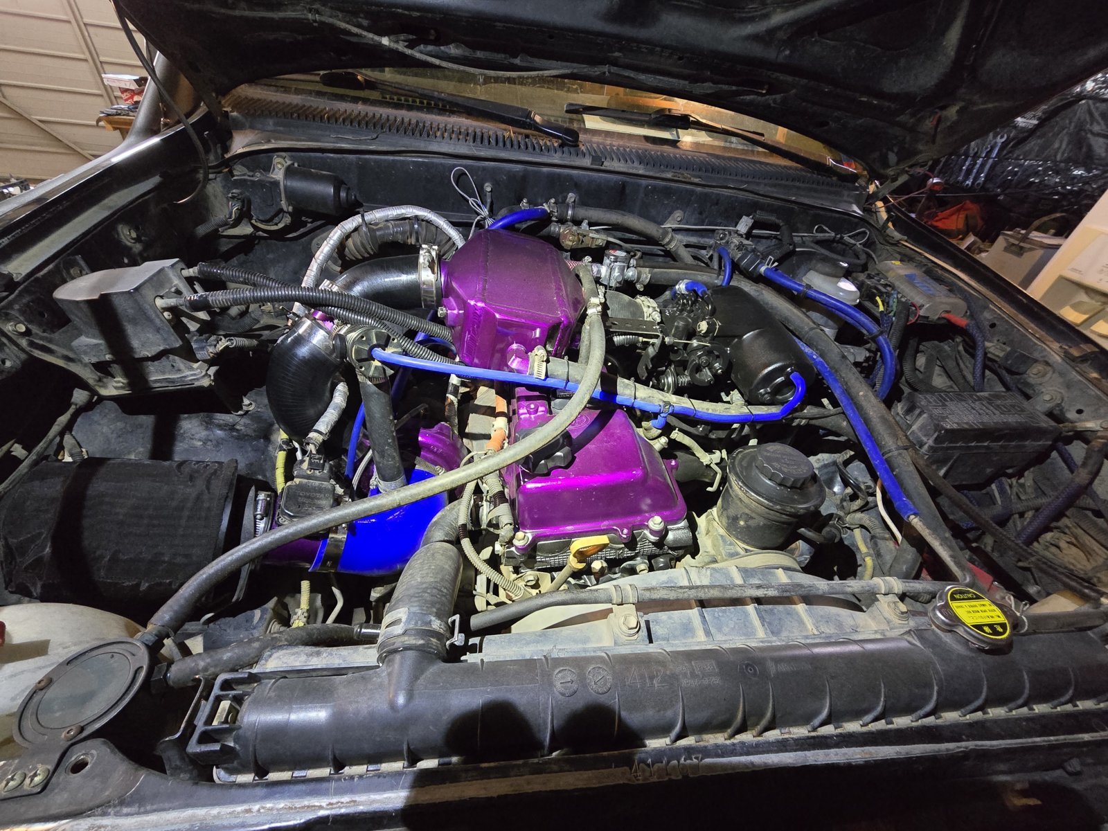

    Finally happy with my intake routing. Don't think I could make it any shorter. I played around with having the MAF in the charge pipe but was getting some erradic fuel trim so I went back to preturbo. I'm guessing it was because it was right after a 90* turn. Pre intercooler temps would get up over 150*. I was always curious what they were. The stutututu noises were kind of fun running without the recirc valve and I was surprised I didn't encounter any stalling issues when the throttle plate slapped shut.

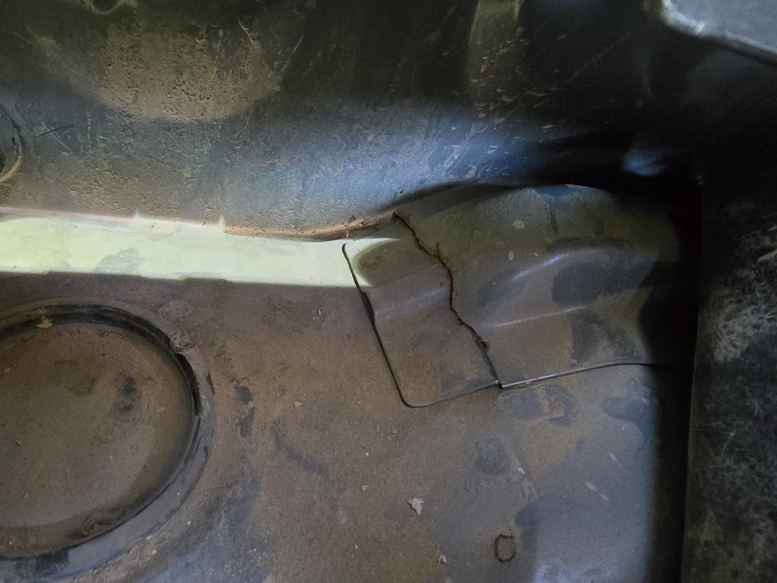

    Had a super annoying squeak coming from the back seat and found this. 20240421_145031.jpg
    Wedged a screw under it for now to stop the noise. Might throw some quick tacks on it before I leave.
    Unfortunately, I had to bring the fridge back into the cab. Things are getting a little tight with a toddler and pitbull in back seat. It seems to get shaken up to much in the bed and stops cooling. Anyone else ever have this problem?

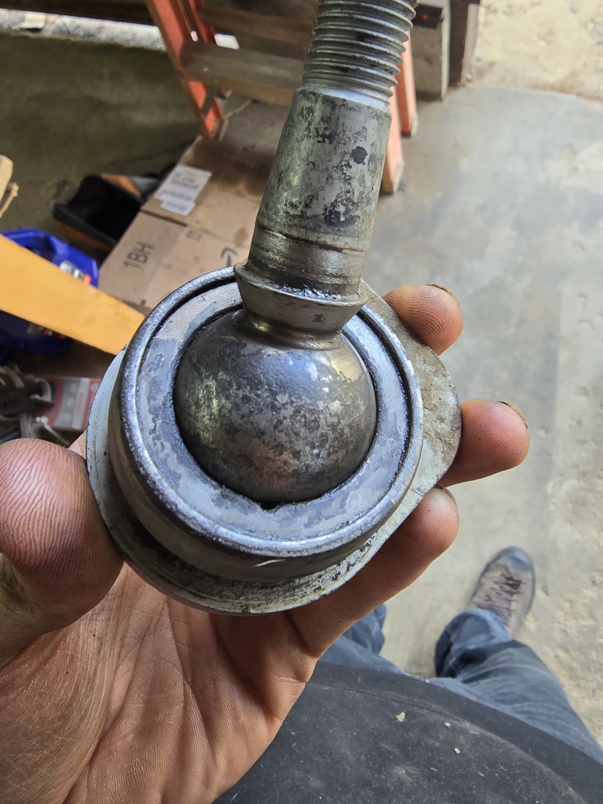

    Replaced my spc ball joints again. This has been an annual item. The replacements I purchased have no zerk to grease them so I'm curious if I will have a different result. Pulled the boots off the old ones and there is lots of pitting on the ball. Not sure where the moisture is coming from to cause that. I haven't done any deep water crossings in awhile.

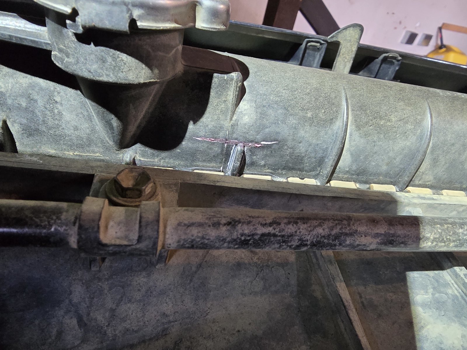

    I was keeping a close eye on my coolant level and was losing a very small amount each drive. I'm glad it turned out to be this and not the headgasket again. Expected the radiotor to be an hour job but all the turbo stuff made it a little difficult to access some of the bolts.
    And that about sums it up where things are at with this shitbox. Hopefully I don't beat it up too bad in Moab and not be able to make it to Pennsylvania.

    Wyoming/St. Louis
    The Trifecta of Taco's
    I've been thinking of ditching the Spcs. I don't want to do ball joints every year. And uniballs would last longer even.
    Also I've never seen maf post turbo due to the pressure difference. Has to be pre boost to be accurate. Or you could convert to map which is generally better. Not sure you can without some kind of piggy back or sand alone.

    There are a number of people doing it with seemingly good results. Usually post intercooler and in a long straight section of pipe. I couldn't tell a difference on how it was running. It was pulling on avg 14% fuel on long term fuel trim. When in boost I was seeing afrs that were very rich, in the 10s. With it pre turbo I'm usually around 12-13 depending on how I accelerate.
