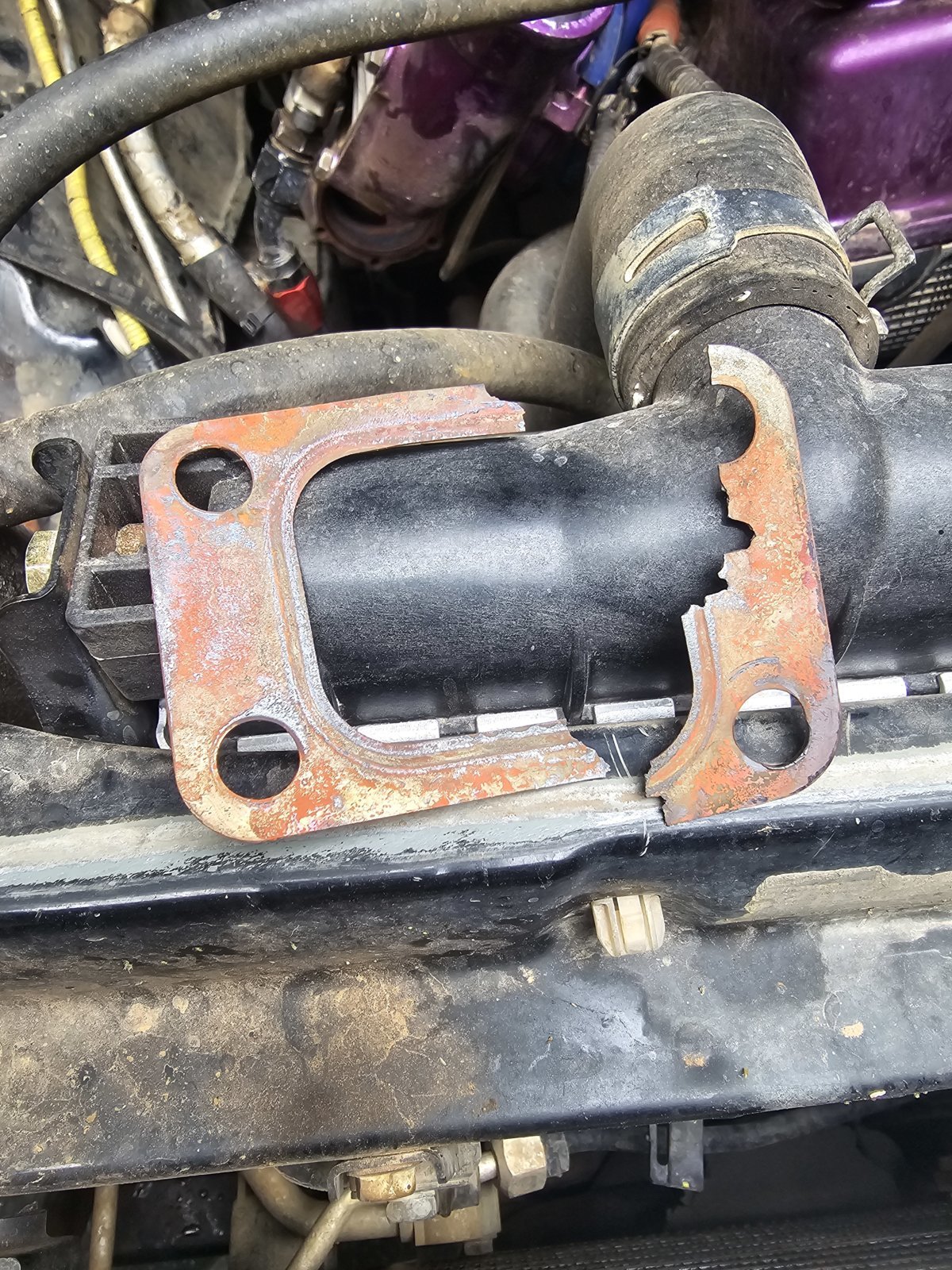

    So I continued on my journey to PA and somewhere in Missouri I discovered what that air leak I hurt was. The gasket between the turbo and manifold blew out. I was missing two nuts on one side causing a massive exhaust leak. I tried to source some oem exhaust nut but didn't realize oem is 1.25 pitch not 1.5 that my studs were. While I was trying to get nuts back on I discovered that my front driveshaft had caught my ADD actuator harness and has ripped it to shreds.
    Limped the truck another 1000 miles to my parents in PA where I could address the manifold gasket and hopefully make the trip back to Idaho. Should be an interesting trip back to Idaho...

    Oof. Reminiscent of all the exhaust leak issues I've encountered over the years.
    I tried a lot of different thing but double nutting all of hardware south of the head manifold studs has done the trick for me.

    Considered it. Don't have enough stud left currently though and I'm not sure there is enough room. Considered pinch nuts as well but Ace doesn't carry them in metric.

    Lots of different anti-vibration hardware to try, but they're not commonly available at hardware stores.
    I'd give these a try

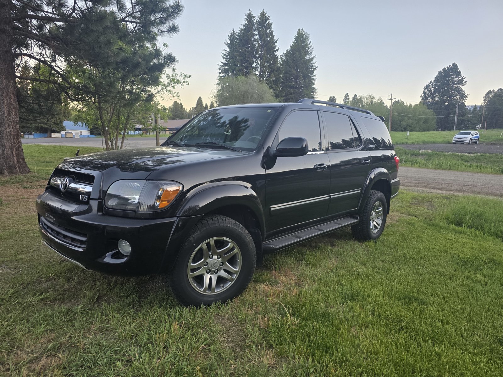

    Added another shitbox to the fleet. This one much less shitty than the taco or T100. Should be considerably more comfortable for my dog and daughter and pull my boat easier. 216k 05 Limited. Going to keep the mods to a minimum for awhile.

    Very nice, how much did that run?

    $6500 most 05-07 Limiteds seem to be pretty close to 10k.
    I did sleep on one in Missoula that had a GFC on top for a similar price.
