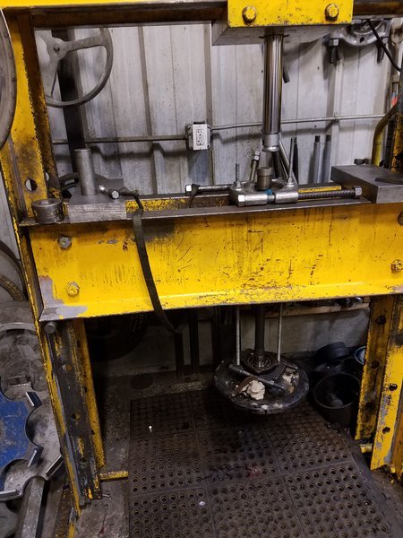

    Started having misfires on the wrx :(
    But I finally got my wheel bearing replaced and everything put back together just before a trip to Indian Creek to climb. It's tough being in Utah and not wheeling!
    Anyway I didn't need any special tools just 2 bearing spreaders and some all thread. It was a little tricky getting everything square but it worked.

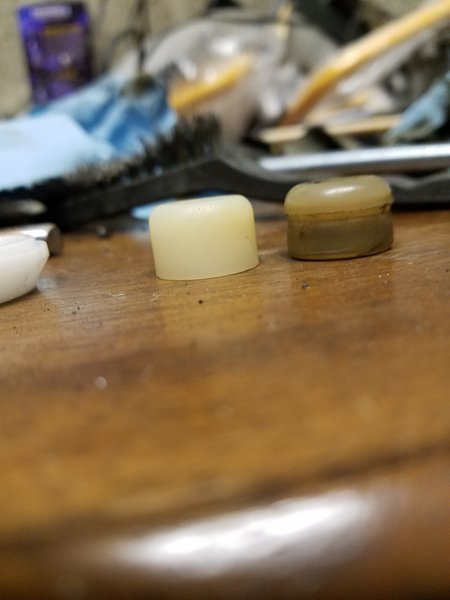

    Well this was a relief. I started having difficulty finding 5th and reverse gears. Initially I was thinking I needed a new transmission but after a little research found it was likely the ball and socket on the shifter. Ordered the parts from Marlin Crawler which will supposedly last longer than OEM.
    Old ball compared to new
    The old socket was completely disintegrated but heres the new.
    The shifter is much tighter now, practically no play when in gear. No problem finding gears now either! $30 fix that I thought was gonna be over $400
