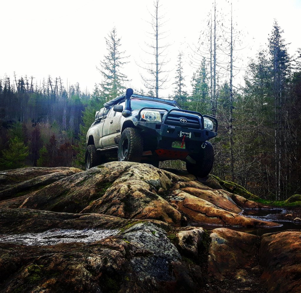

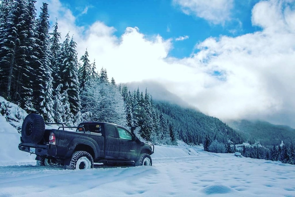

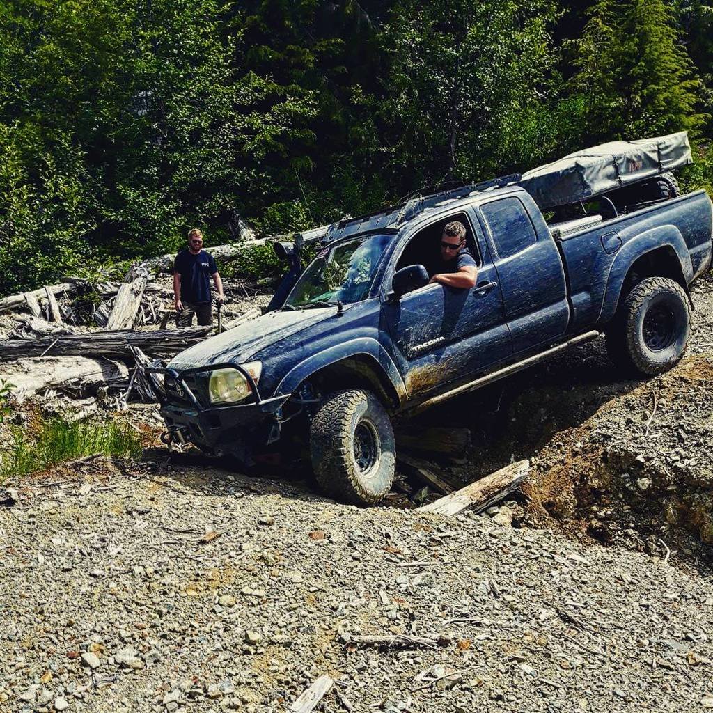

    First off, 5.29s don't fit in a second gen so if op has a second gen then they're not an option. Secondly 4.88s and 35s are perfect. I would know I have them. Personally I would go with arb over the e lockers but that's just me. It boils down to personal preference as the after market e lockers are pretty good. Lastly keep in mind you'll need to clearance and cut your truck. No amount of functional suspension lift will save you from that. Also I strongly recommend spindle gussets. You will need to cut 2.5" from the fenders and flare in the front, you will need to cut the shit out of the cab mounts and box them and you'll need a minimum rim backspace of 4.25" also beat that pinch weld and fire wall like it owes you money. Then check the fire wall for leaks as you might hit it too hard and separate the seam sealer. Also you inner fender liners won't be much use after so expect to come up with an intake solution I opted for the snorkel option. After all that you can install your tires.
    Totally worth it
