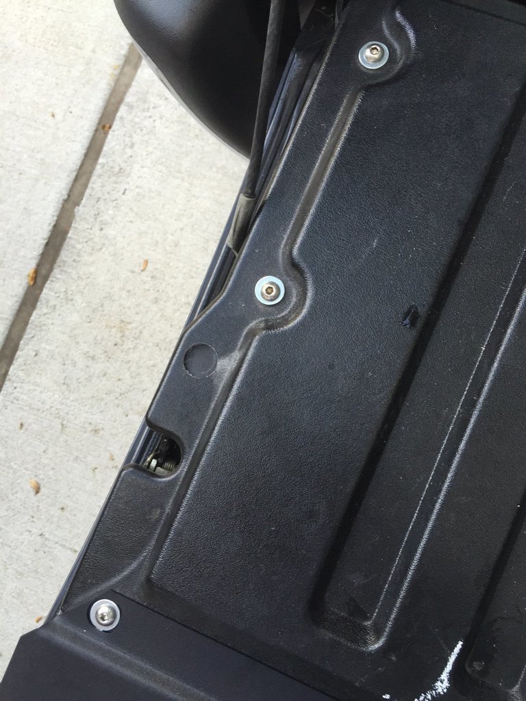

    I kept the OEM plastic, just because I use it to hold small parts and pieces when I work off the tailgate.
    The only thing I did was to drill a hole in each side for the factory rubber bump stop to go through, so I didn't have to slam the tailgate.

    Do you have a pic of what you are referring to here?

    Here is the pic. You can see the hole on the edge.

    You used different fasteners than what was original. Why was that?

    Also, the tailgate cap is designed to go under the OEM plastic skin and on top of the metal replacement skin. Looks like you have yours on top of the plastic skin, which means it probably doesn't fit all that well.
