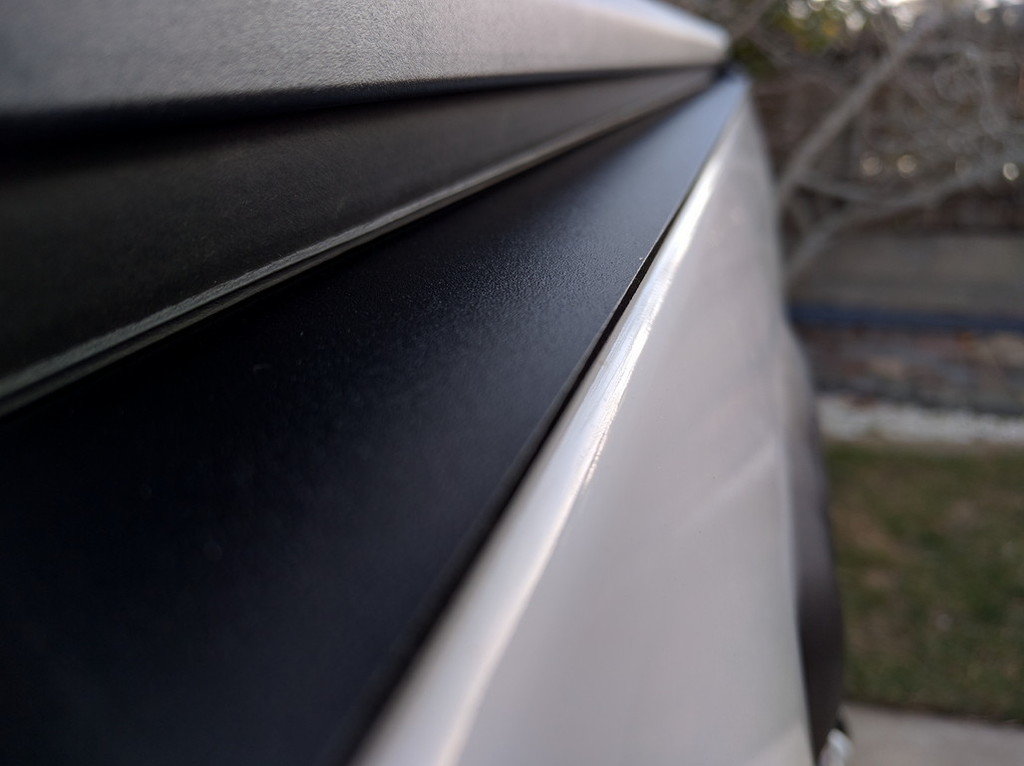

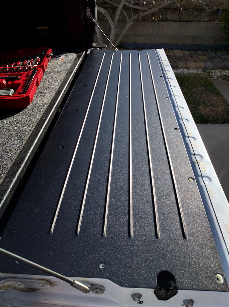

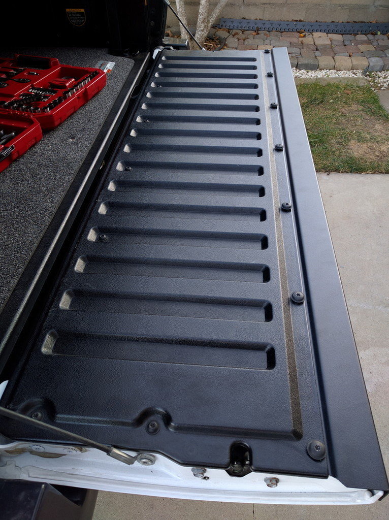

    Got my ribbed tailgate skin + cap in today, and installed them right away.
    As already stated, if you plan on using the OEM skin on top of the Mobtown skin, 3 centering tabs must be removed from the OEM skin first. I used a hacksaw blade and took them off in seconds. The Mobtown tailgate cap must be installed over the Mobtown skin, but UNDER the oem skin(if you plan on reusing it).
    It also should be noted that since the Mobtown tailgate cap sits much more flush to the tailgate(aka lower), it may affect the seal on some folding tonneau covers. To me, really isn't a big deal. The strength is worth that slight drawback IMO.
    Overall, GREAT products by Mobtown. Very satisfied customer here. I got the hardware kit too, but I will be installing all that at a later time. The OEM fasteners will suffice for now, but the Mobtown hardware kit has MUCH better fasteners for sure.
    Pics:

    Thanks for the write up and I'm glad you like it!
