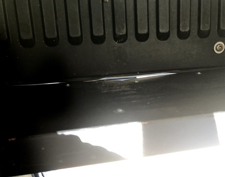

  13. Jul 7, 2017 at 3:20 PM
    #333
    Echodawg
    Echodawg Well-Known Member
    Jul 25, 2013
    #109034
    775
    Fremont, CA
    2014 TRD OR DCSB
    Stuff and Things!
    I had to take the tailgate skin off a few times to work on something and now one of the rivet nut inserts just spins when tightening the bolt. Do you know the size so I can see if I can get another at the hardware store?
  14. Jul 7, 2017 at 4:39 PM
    #334
    jowybyo
    jowybyo Well-Known Member
    Nov 19, 2013
    #116863
    6,092
    Joe
    Baltimore, MD
    '14 MGM DCSB Postrunner 4wd Conversion, Debadged
    It's a standard 1/4-20 steel rivnut.
