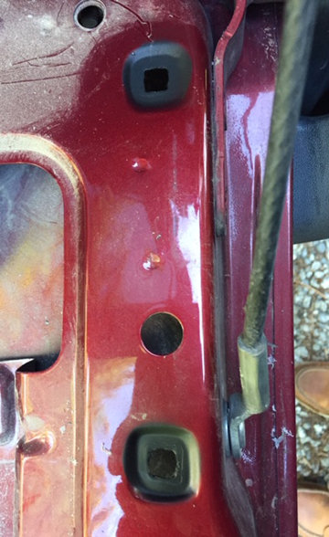

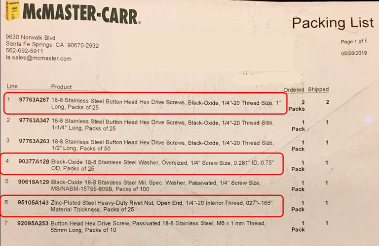

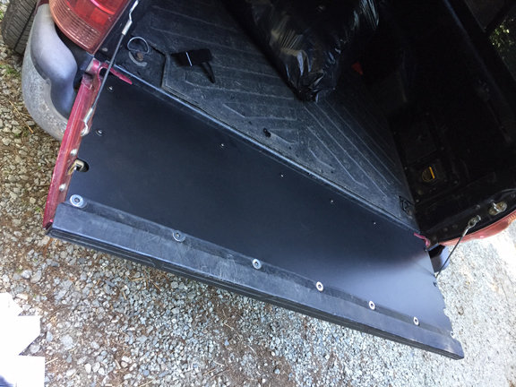

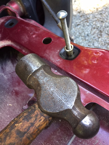

    Got mine installed today. Took about 90 minutes to get RivNuts and cover installed
    I went with Black Oxide Stainless Steel HW from McMaster-Carr. Cost a bit more then the MobTown HW kit but I was planning to use extra HW on my Prinsu Rack. Part numbers are:
    In hindsight, I should have gotten larger 1" washers instead of the 0.75 washers. The 0.75 washers are great for the bottom holes but not large enough to cover the larger holes on the plastic top piece that I reused so picture is showing some 1" SS fender washers on the top edge.

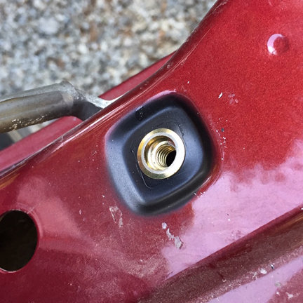

    For installing Riv Nuts, I used 3/8" drill bit instead of the recommended 25/64th, purposely undersized a tiny bit to get a snug fit, and then touch up primer paint on the holes to keep corrosion down where drill bit cut paint away. I used a 1" hole cut into a piece of thin cardboard to keep spray pattern tight.

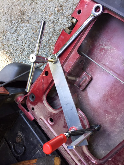

    Since holes were undersized i tapped the RivNuts in using extra long screw to hold RivNut straight and keep fingers clear of the hammerhead. One light blow was usually enough to seat the RivNut.
    Swaging the RivNuts was easy. Took some trial and error but discovered this method worked best. First I drilled a 1/4" hole in a piece of scrap metal and inserted a 1/4-20 - 2" fully threaded grade 8 bolt with a nut preassembled on it through the hole in the aluminum bar and threaded the bolt into the RivNut until I could feel threads on the bolts protruding out bottom of RivNut. I then clamped the metal bar in place to help keep the RivNut from turning and put a drop or two of oil on the bolt threads to reduce friction before hand tightened the nut down onto the bar. The T-Handled socket wrench in picture was used to keep things straight and to push down on the RivNut for first turn or two with the wrench until the RivNut started to get a grip on it's own. I tightened the 1/4-20 nut with a 7/16" wrench about 4-1/2 turns until RivNut was tight. Do not turn the upper T-Handle wrench, instead tighten the nut in standard CW direction while holding the bolt with T-Handle up straight and still. Tightening the nut will pull the bolt up and compress the RivNut as the bolt is pulled up. Once done, loosen the nut and unscrew the 2" bolt and move on to next one.

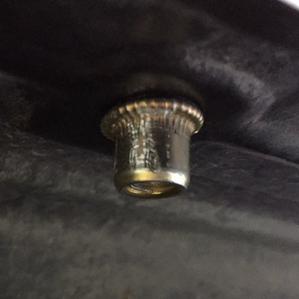

    Once done, your RivNut should look like this
