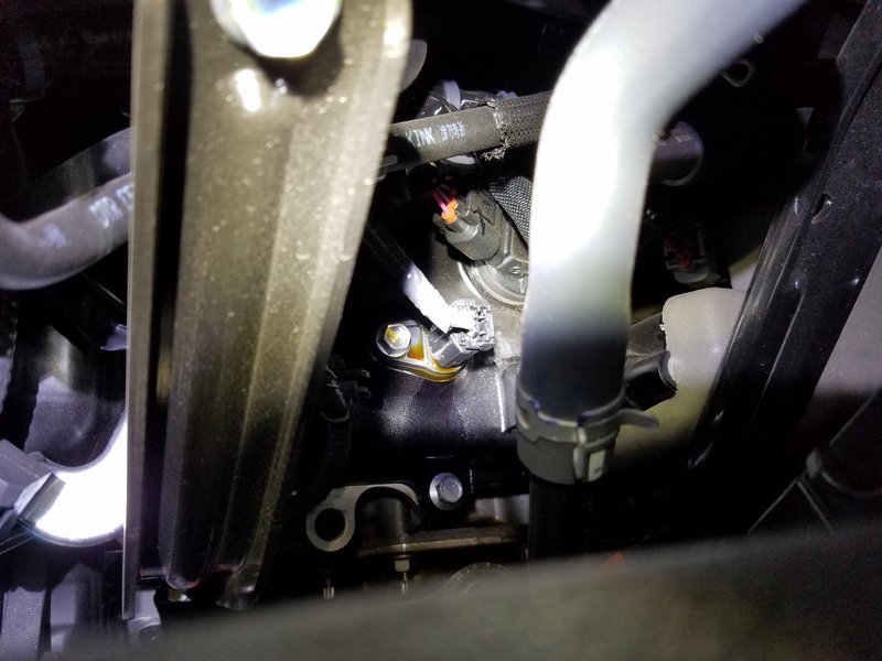

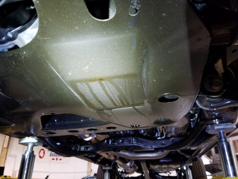

    Decided to throw my truck on a lift at work to check the zerk fittings to see if they were greased. Didn't find them before I found this...

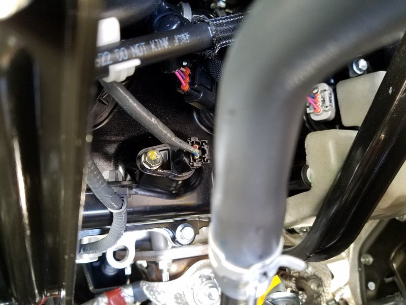

    Found the source at the top of the engine. Looks to be some type of sensor input.
    Called up a dealer and dropped it off the next morning. While I was there I brought paper work on the ECU tsb and Lower arm tsb. I also mentioned that at 55-60 MPH there is a howling in the rear. I get a call few hours later stating that they needed to order the sensor for tomorrow and that the technician did not hear any howling... The howling is super noticeable so I am going to probably need to schedule a test drive with one of their techs when I go to pick up the vehicle. Also asked to check the ATF level and explained that I understand its a time consuming process, they said everything looked fine. (doubt they actually checked it manually)
    Kinda a bummer with only 450 miles on the truck but Im not too worried since its being taken care of under warranty. Hopefully this is the extent of my issues.

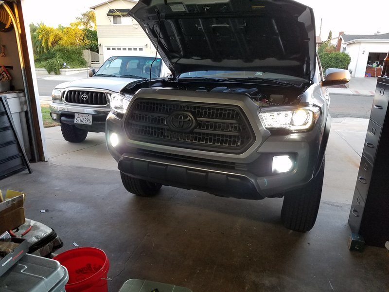

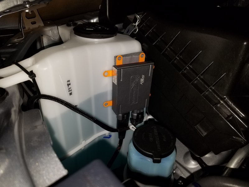

    Added Morimoto HID's 6500k 55w for low beams and the china version of the opt7 LED's for the fogs.
    Used industrial grade Velcro to attach them. Did not want to drill into the aprons or radiator support to affix them, sanded both locations a little to help with adhesion. May relocate RF ballast for cosmetic reasons.

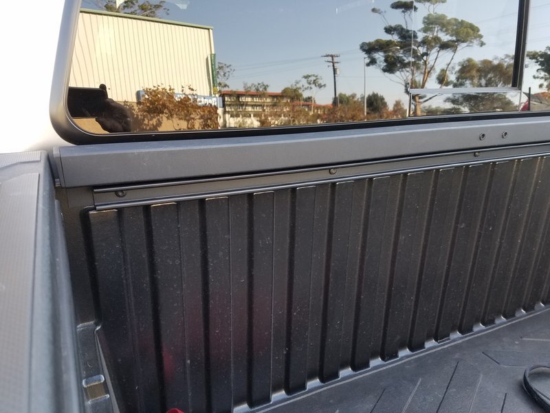

    Added the front bed rail that comes missing on 3rd gens for whatever reason.

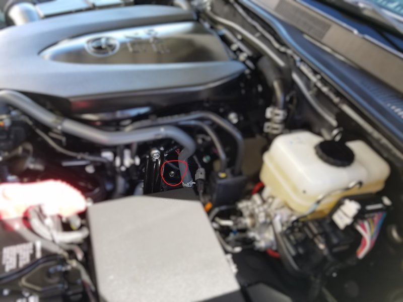

    And for the second time my left side cam shaft sensor is leaking oil, after only a few weeks since replacement... Its just a tiny puddle at the moment but I will be needing to contact the dealer again for warranty work. lame.

    Nice! I came back to the Tacoma from a 4Runner also, mine was an 11 Limited with way to many mods to list.
    Where are these located exactly I'd like to check mine for any leaks? TIA
  8. Oct 1, 2016 at 8:43 PM
    solscooter
    solscooter Sh!t Outta Luck
    Nov 8, 2015
    #169056
    1,910
    Brian
    Minnesota
    2016 TRD OR DCSB 4x4
    Put that passenger one behind the washer fluid tank. Much better location.

    Sorry for the weird blurred pic, was messing around with windows photo editor. They replaced the first one with 400-500 miles on the vehicle. Its been back from the dealer for about 2 weeks with me checking the sensor every other day. Now it has a small leak at the base of the bolt that holds it in.

    Ya I may switch it up, just thought the adhesive would stick to the roughed up plastic better than sheet metal. Does seem a bit out of place in its current spot.

    I used the industrial strength Velcro for mine. Hasn't moved in over 10 months. Pretty shielded back there. Need to find a better place for my drivers side though
