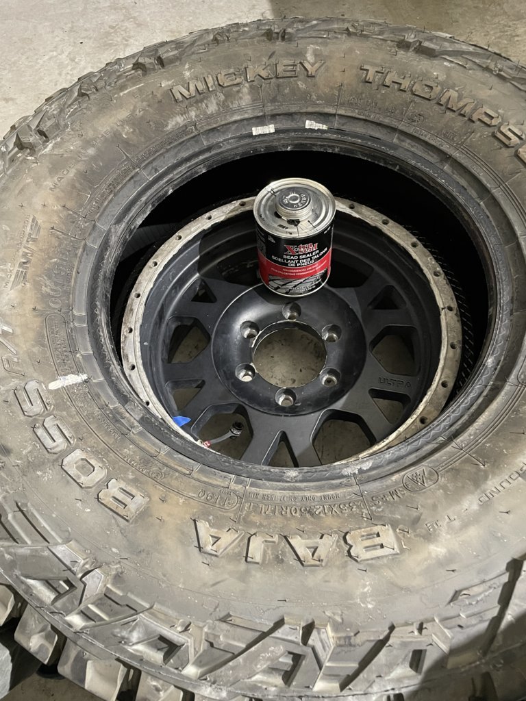

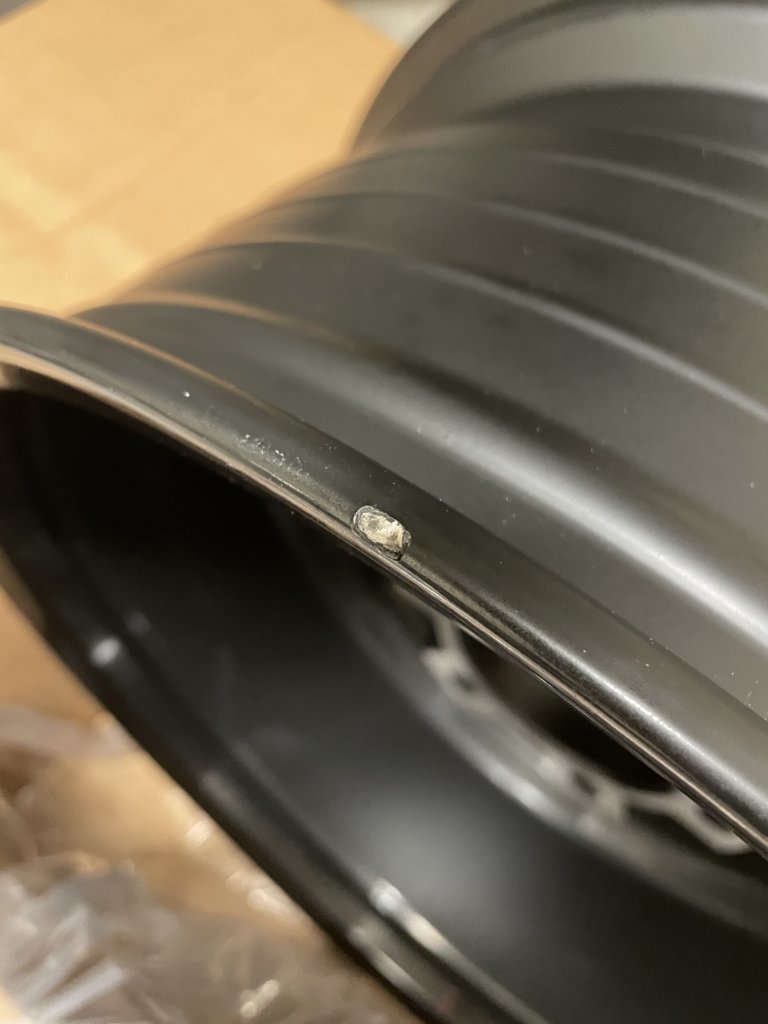

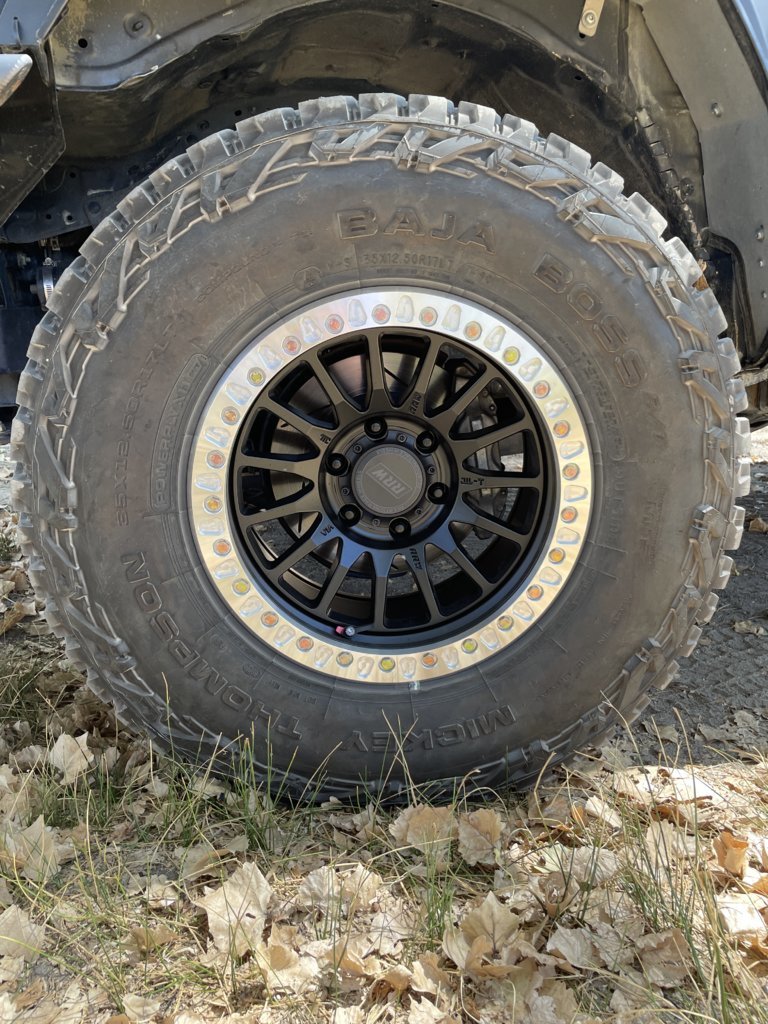

    Just recently switched to these in a -12 and running them as true beadlocks. One of them had a nice chip on the back of the rim edge, a bit disappointing but not the end of the world. I just stacked up a few layers of touch up paint and called it good, plus I ordered 5 so this ones now the designated spare.

    any issues losing air pressure with the beadlocks? I have these and one of my tires is losing a few PSI per day.

    Not with these wheels, been running them a few weeks now and no issues holding air.
    I had that problem with my last set of beadlocks but it was because the powder coat was failing around where the ring seats against the wheel, so I had to use bead sealer to get them to hold air but they held air fine before that.

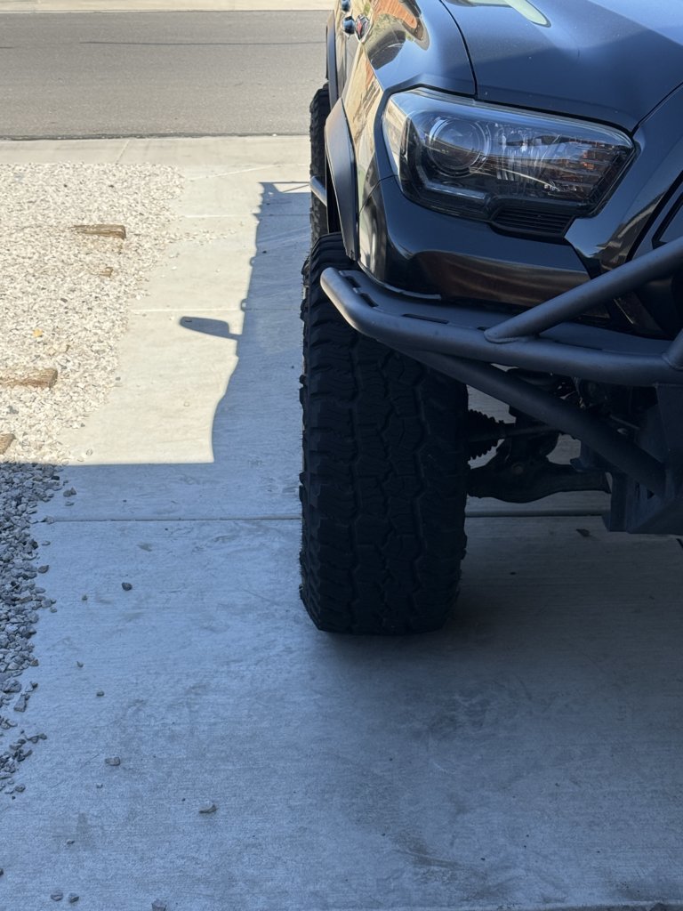

    Could we get some more pics of "down the line" to see the poke with the offset? What tire size are you running here. Any issues with the brake caliber?

    Tire size is 35x12.5R17 and no issues with the calipers.
    This is the poke from the wheels, no spacers.

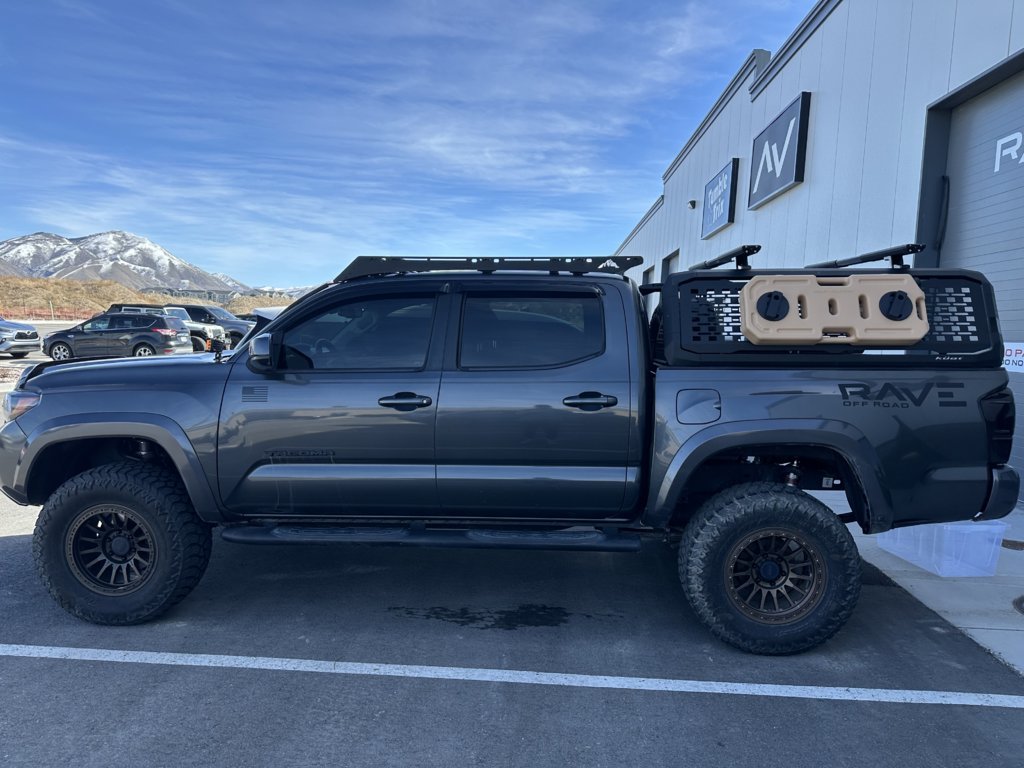

    loving my wheels. they’re 0 offset with 285/70/17 amp tires, freedom offroad UCA’s and CMC. no issues rubbing
    anyone know if or any ideas to other center caps that could work with these? would love to see the OEM bronze ones that say toyota on them but obviously those won’t work and probably any others won’t either

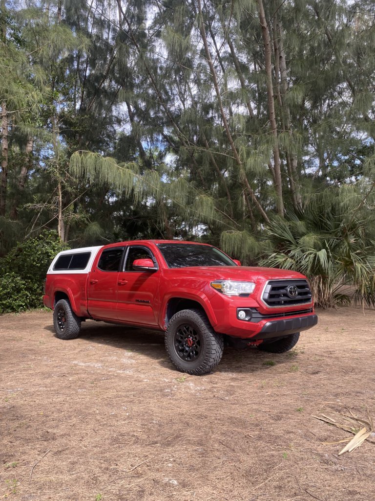

    Hello 2025 ?
    I want the aluminum/polish look can someone steer me in the direction of what rrw model you recommend. Ty :bananadance:
    im painting the topper too so y’all chill out
