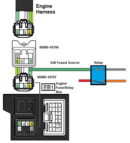

  5. Oct 3, 2023 at 9:08 AM
    caribe makaira
    caribe makaira Well-Known Member
    Feb 13, 2011
    #51121
    11,797
    Caribbean, Puerto Rico
    05 PreRunner TRD Offroad AutoTrans
    Hood Struts, My version Fogs always ON, Map & Overhead Light Mod,

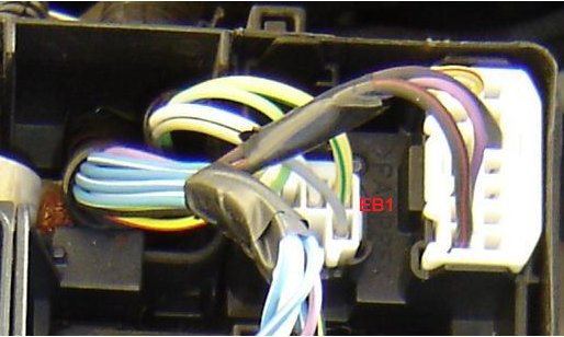

  6. Oct 4, 2023 at 2:38 AM
    caribe makaira
    Feb 13, 2011
    #51121
    11,797
    If the above is too complicated, you could just use a posi-tap type to same wire (EB1 _3).
