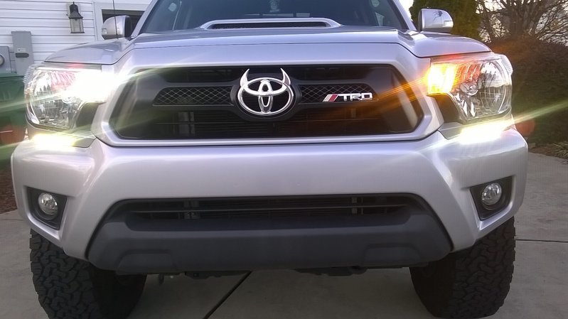

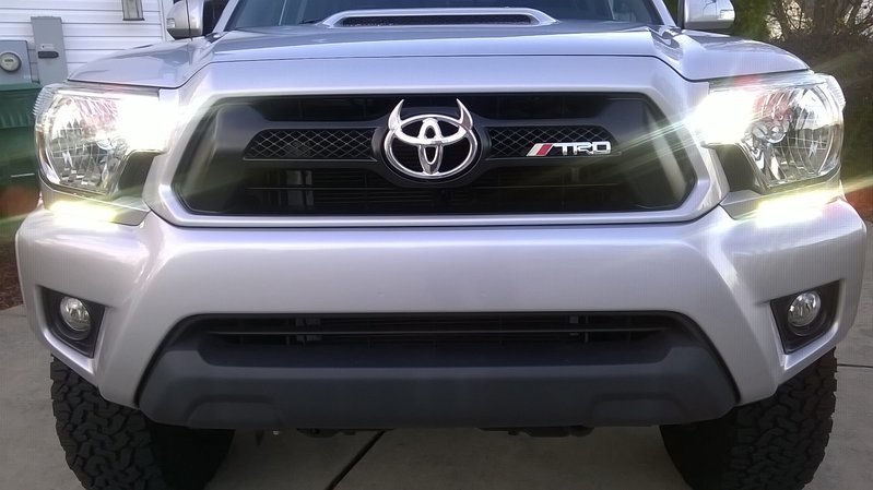

    Below is the plug and play V3 Triton
    Argent Taco and BassAckwards like this.
