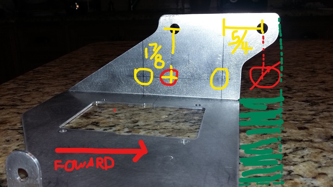

    I'm going to try raising it 1 7/8 see how that fits, can only drill 1 hole to mount it ,no metal forward to drill out
    and then I'm going to try moving it forward 1.25 (moving it forward ill have something to drill out for the 2nd mount hole)
    but moving forward will lose 3rd mount point and mounting plate will be over main relay box
    *Also did not raise it a full 2" only 1&7/8 so I could fit a ratcheting box end on mounting bolts m8
    * also prefer there be metal in shaded green area(metal to drill for mounting) if so the mount plate could remain in original position
    THOUGHTS ?

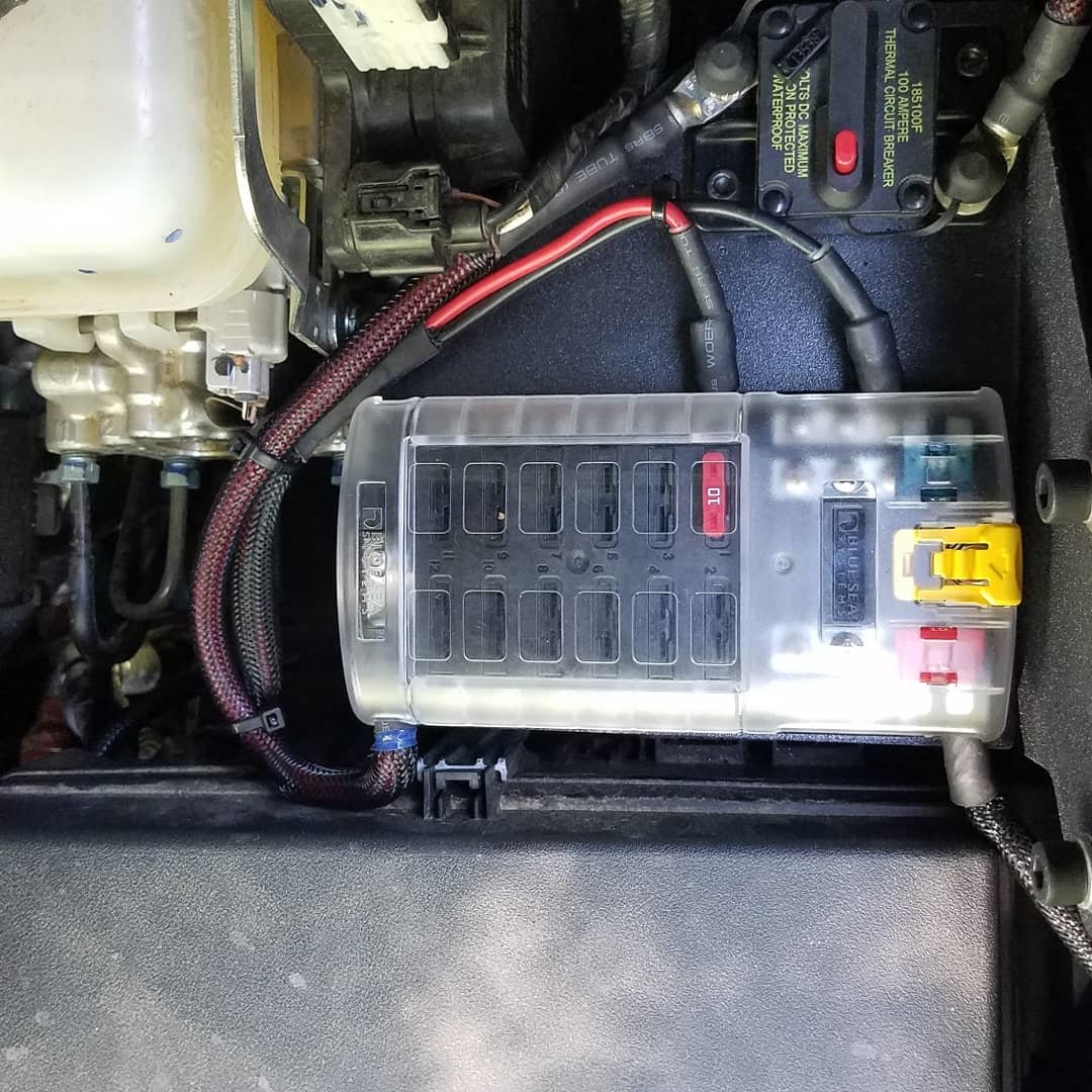

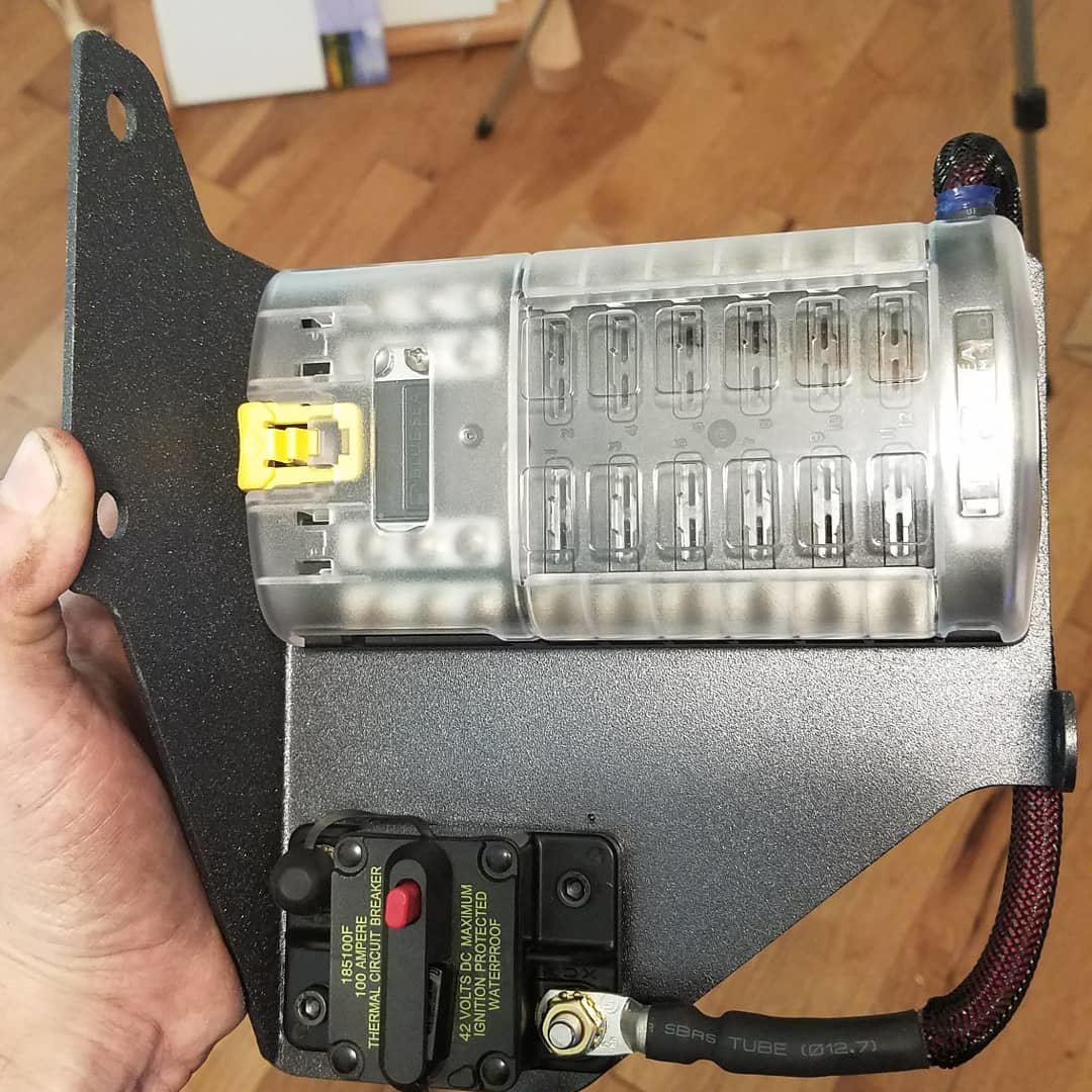

    Got mine drilled, once I paint it and get everything mounted I will post up some pictures.
    I am using 12 circuit blue sea fuse box and bussman 100 amp circuit breaker.

    As promised.

    For future reference, the mount fit perfectly and I did not relocate the relay since all of my gear is mounted on top. I made some of my wires a little long and you have to test fit to see how the wires will need to be routed but it worked well.
