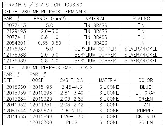

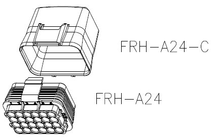

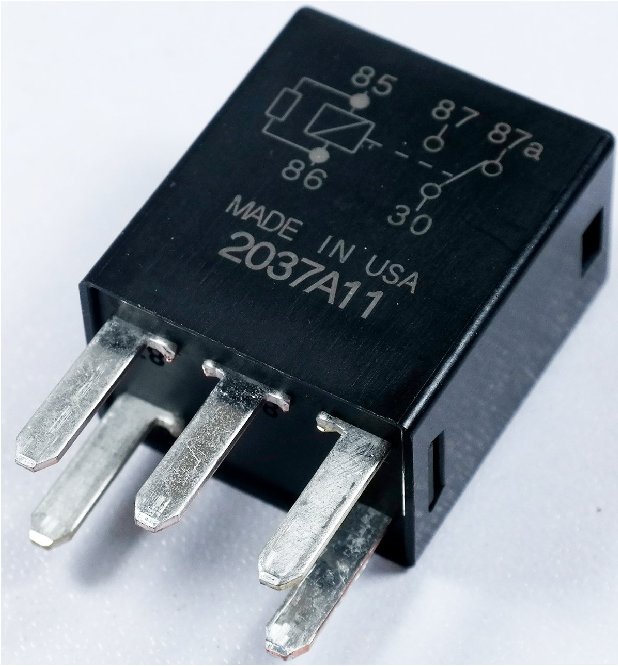

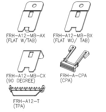

    These are the type relays (280) that fit the 24 pin base (GEP_FRH-A24)
