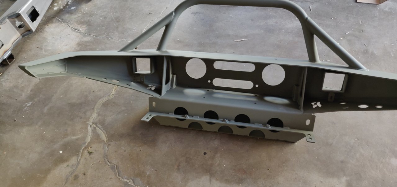

    @Grand dude can you post of pic of the front bottom side too?

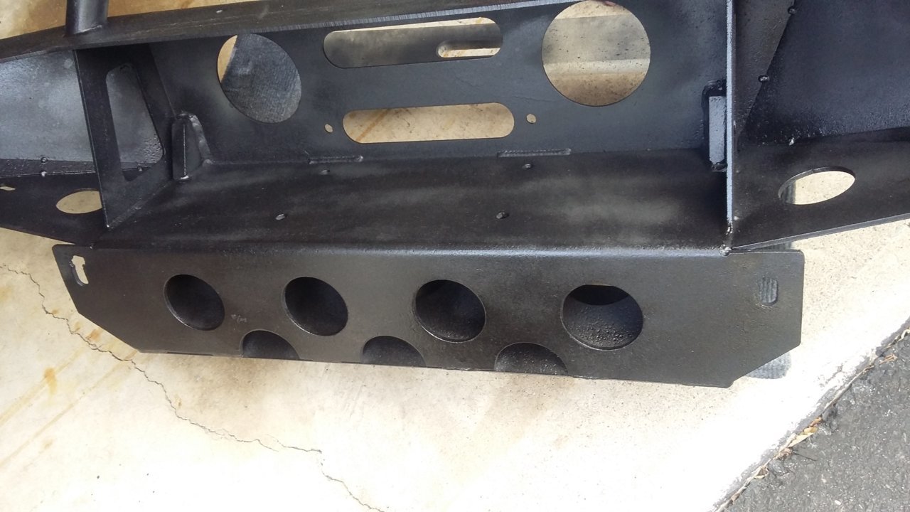

    @quetzal
    Ouch yeah mine has some angle iron to mount oe style skids.

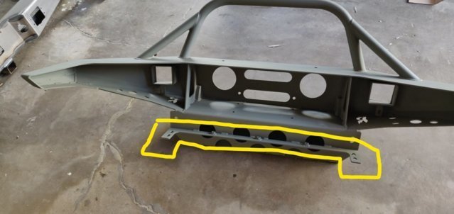

    @RelentlessFab ...Eric is there a chance I can order just the piece of steel that the OEM skid plate mounts to for a first gen 02
    Piece in yellow

    Yes you could, you'd need to reach out to us via email to get that set up. I actually have one other customer that reached out last week with a similar situation with a kit bumper he got.....
    FYI this bumper you bought happens to be one of our old DIY kit bumpers that was sold in pieces and someone put together in their garage(one way you can tell with the photo someone attached has our 'R' on the under part of the sides on the bumper vs the logo delete/round hole cut there on the kit version).
    Things like this issue is part of why we discontinued them a few years ago. Unfortunately there were a lot of guys that were doing them as their first welding project and simply didnt have the welding and mechanical knowhow and some of their handy work started to bleed off onto our reputation for our fully built bumpers and we couldn't have that.
