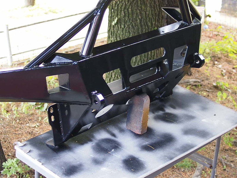

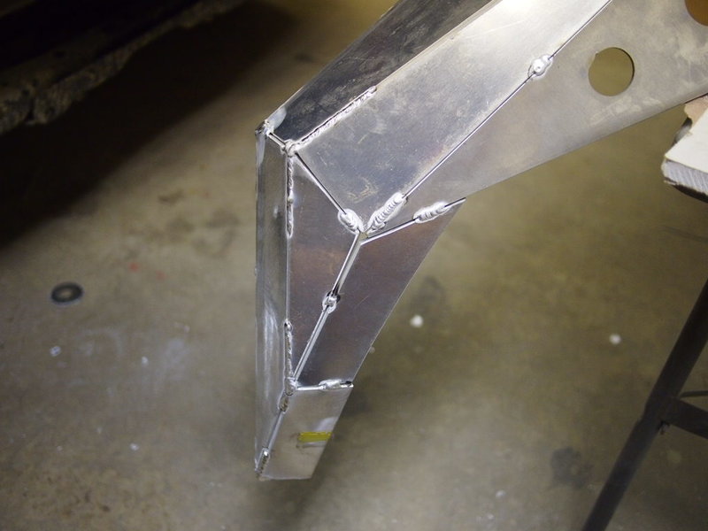

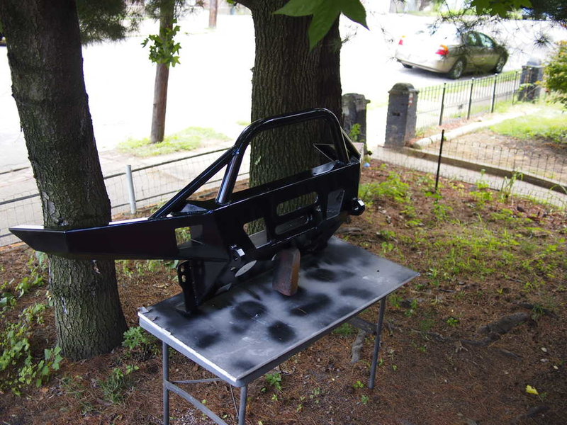

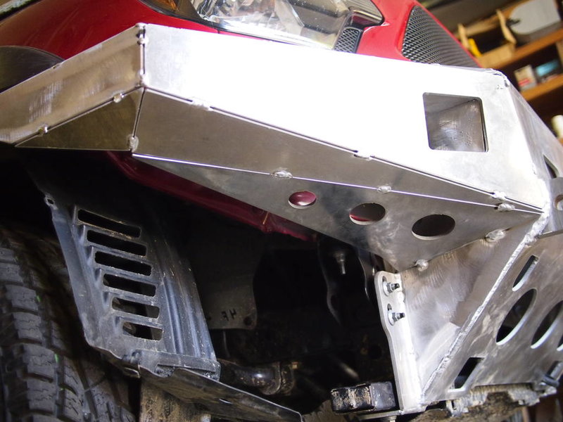

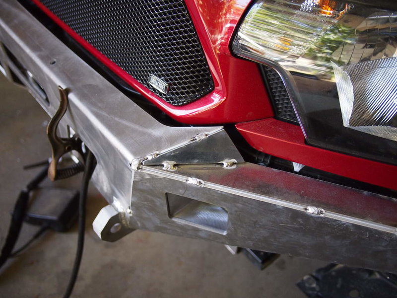

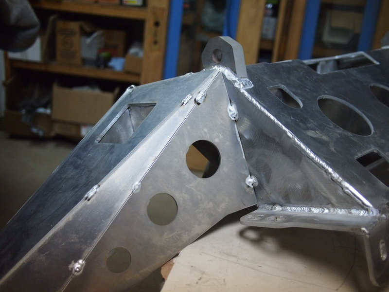

    Pics finally! Okay, so it's been done for about a week and a half, but it took way longer than I thought! I lost track of how many hours I had. It took about 6 or so to remove all the factory stuff, weld the center section solid, then fit to the truck. The next day we worked on fitting and tacking all the pieces. The following day I welded the outside solid, jumping around. The day after that I welded the inside intermittently. Then it was time to grind. Took about an hour or so. Finally I welded on the tubes. Then a coat of paint. All in all it took about a week and a half, working half days on weekends and a few days after work. It was quite a challenge but worth it completely! Super nice product!
