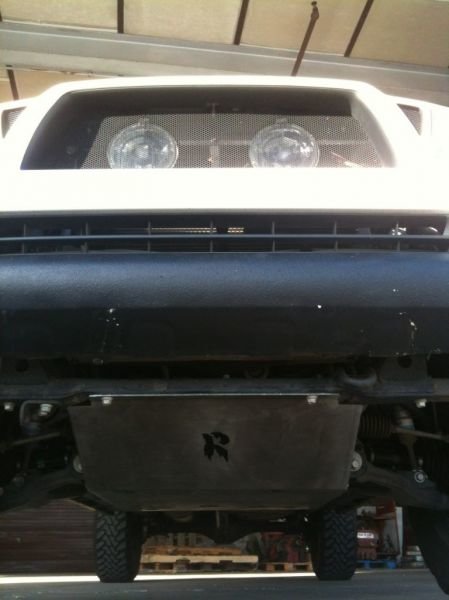

    Got it installed.
    Thanks Eric.

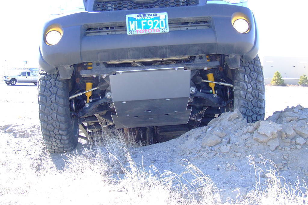

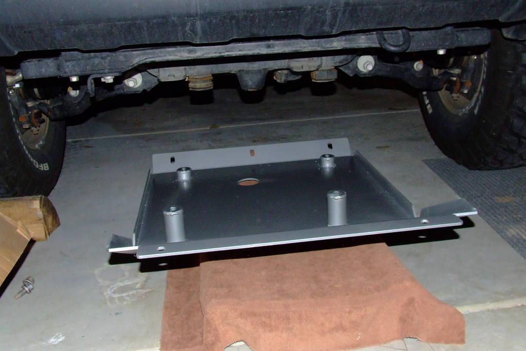

    Step 1 Place IFS skid on creeper.
    Step 2 Slide under truck.
    Step 3 Lift front end & install two front bolts 1/2 way
    Step 4 Block up rear end install middle & rear bolts.
    Step 5 Finish by installing tranny & transfer skids & tighten all bolts
    Step 6 Take it out & enjoy your new belly protection.

    Just got mine in the mail this week! Had it powder coated for 50$.....and will be installing tomorrow. I also got the to crossbars for the bed rails powder coated as well and they installed in minutes! Thanks for the awesome products Eric!

    anyone use erics skids with B.A.M.F. LCA skids? any issues on clearance/rubbing?
  18. Sep 2, 2013 at 10:00 AM
    #58
    RelentlessFab
    RelentlessFab [OP] Eric @Relentless Fab Vendor
    Feb 17, 2008
    #4772
    15,815
    Eric
    Sparks, NV
    07 AC 6mt>03 SR5 >08 Sport and 17 6MT TRD OR
    Relentless Armored! Too many others to list.
    The round inner tab on the BAMF skid will need to be trimmed. Simple enough, just mark a straight line and cut it off
