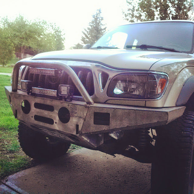

    I'm in the middle of making my way through the bumper now. You guys don't happen to have a rendering depicting where all the bits go, do you? The two pairs of tapered and 90 degree bent pieces have be stumped.

    Also sorry if I came off blunt and rude, I opened the package after doing the very OCD task of pouring a finish on a photograph I mounted... I wasn't expecting to see the plasma cut recovery points. I looked at them again this morning and they're not as bad as I made them out to be.

    Lookin good!

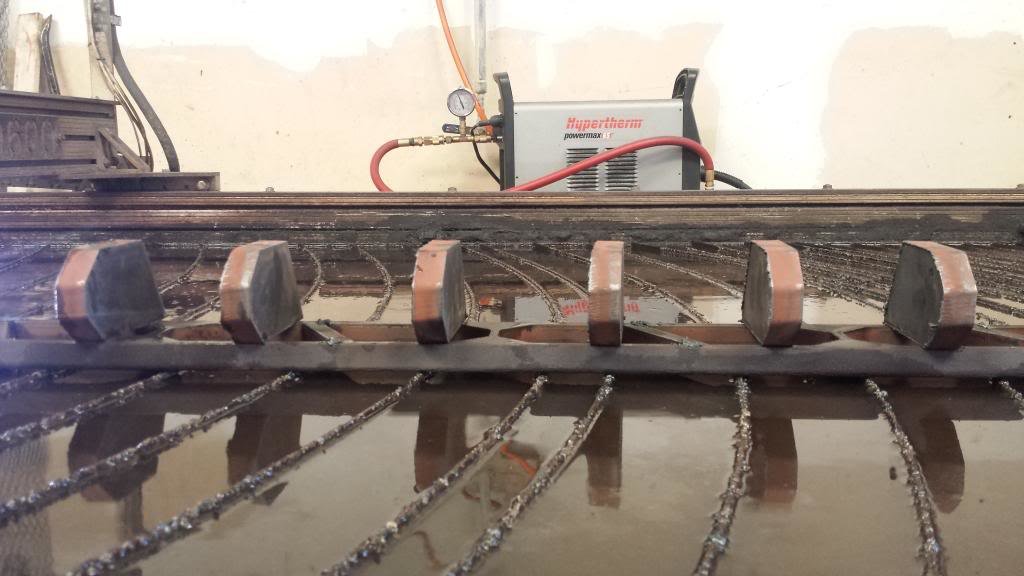

    I got mine and i just opened it today, and i see what you are saying. the cnc plasma operator isnt doing a very good job lol. even the 1/4" parts have a bad kerf on them. and the shackles points are even worse. You can get great quality if you cut the parts right (i have seen it with my own eyes)
    overall the parts are great, and its a diy kit so a lot of this will be easyish to fix.

    Our plasma has been a bit finicky lately- throwing random error codes and irregular cuts on one part then clean and square on the next. Seems to be an internal issue with the machine... so since I cant afford down time of my CNC while getting the cutter warrantied I ordered a new one and upgraded to the next larger one. :D It's slated to come the end of this week, should put us back to our same consistent clean cuts, and even speed cutting a tad. I've got settings dialed, just seems to be machine issues lately.
    Here's the last recovery point batch, I personally cut them(we also took the criticism noted earlier on them and are having the hole in them punched rather than cutting it on the cnc so these are the 'blanks')
