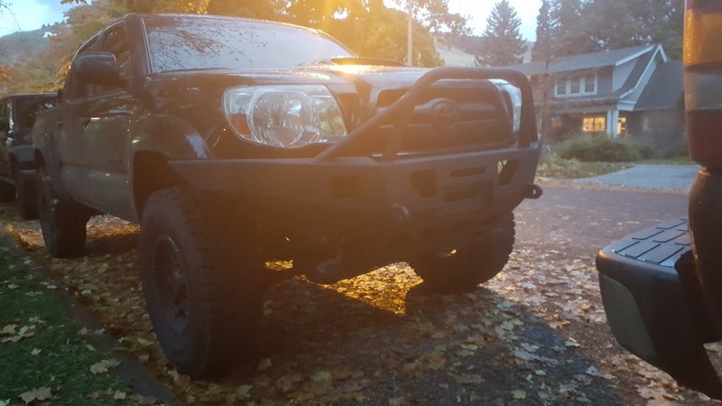

    After a little bit of calling around and pricing I decided on Line-X.
    She's got a whole new look about her now.

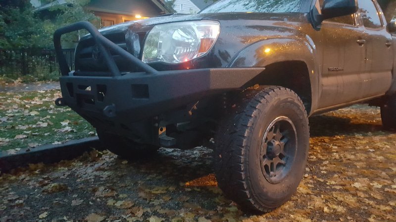

    On the other side

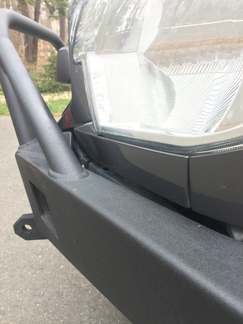

    Sorry to revive this old thread but I just installed my Relentless Fab Predator bumper on my second Gen and I can’t seem to get the trim pieces that go under the headlights back on and stay on. I think the fog light housing is hitting the support bracket. Did you have to trim yours or?

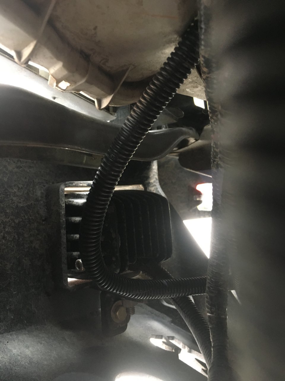

    I didnt have any issues with my headlight trim pieces. The foglight looks to be a bit below that piece; and is also below the sheet metal support.
    265B8B60-56EE-41E5-8C1B-1D3359DEE177.jpg 509DC86B-72EB-4892-94CA-E1544D14CC75.jpg
    Did you happen to accidentally tweak the mount for the trim piece? I did that once when I had to remove the headlight assembly, but I was able to push the bracket back to its original positioning.
    The only fitment issue I had was with the mounting holes where it meets the frame horns. I had to use a dremel to open two of the holes up, just barely. I tried for about an hour before I resorted to that and, voila, it mounted right up.
