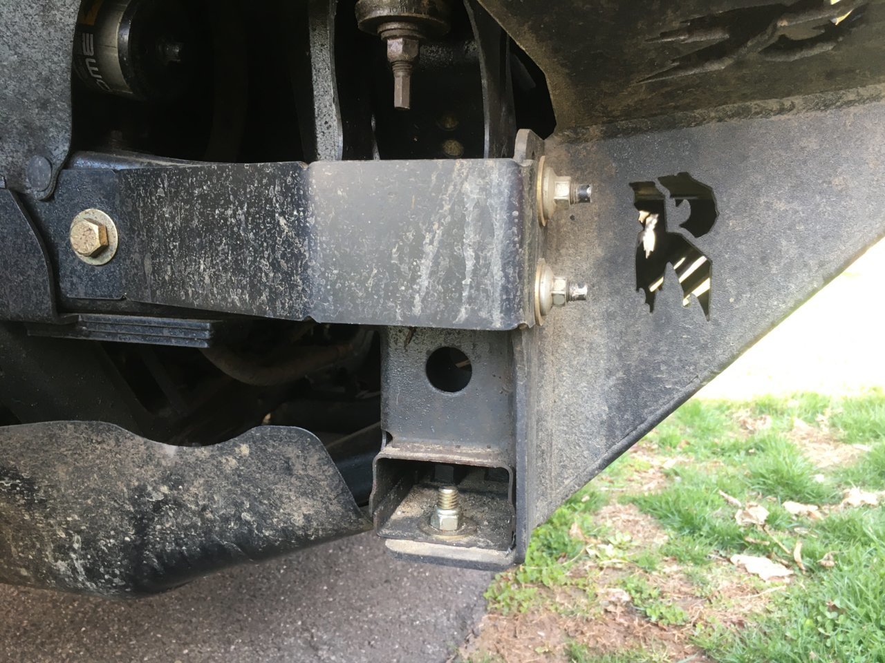

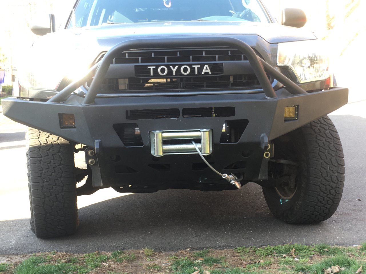

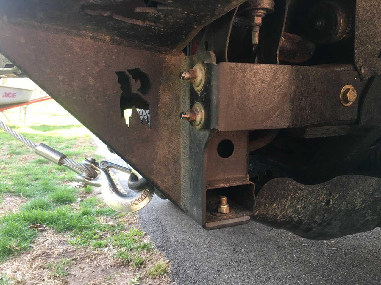

    Sorry for the delay; the holiday yesterday got a little busy.
    I ended up not using any washers to space/level it out. The passenger side gap between the bumper and headlight is slightly bigger than the driver side, but its hardly noticeable so I left it without any washers.

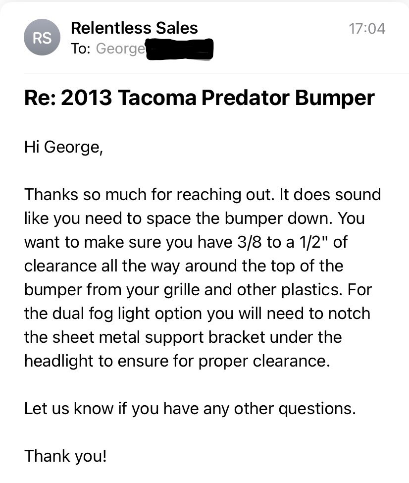

    Thank you for getting me those pictures. I did not use any of the washers like I mentioned before so I am going to install those the next chance I get. I also emailed Relentless Fab and here is the response I got. Looks like I have to notch the support bracket. I'll probably precision dremel it lol
