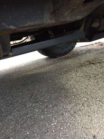

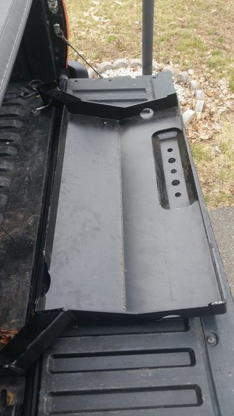

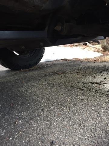

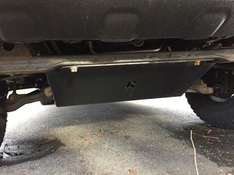

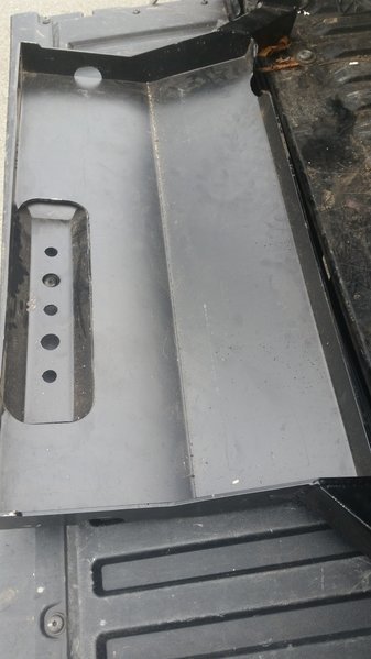

  10. Apr 4, 2017 at 5:35 AM
    Colgan
    Colgan [OP] Well-Known Member
    Feb 27, 2017
    #211849
    62
    Here is a pic of the skid in question. Any help would be great. I'm guessing where the plate have the drop is where I should make flush for better clearance
