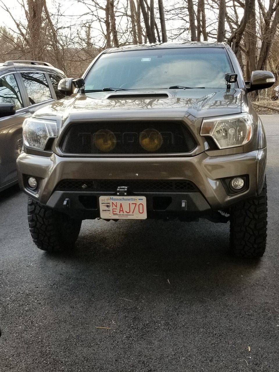

    After some modding of the holes it fits like a glove. Would have been nice to have the trim piece though not sure why it wasn't shipped but oh well.

    Trim piece isn’t part of the package. Anybody you see with it bought their own I believe. Looks good man!

    Huh, so that's what the front of your truck looks like... it looks great brother. ;)

    @SMKYTXN sells something that might work for this. I almost bought some, but decided against it.
    https://trailtoys.net/products/fender-flare-trim

    Thanks people's I won't bother putting the edge stuff on. What would any of you recommend to touch up the powder coating?

    Looks great! What are these holes you guys are speaking of? The holes on the mounting spots on the bumper? Or On the brackets? Or on the truck?

    Holes on the bumper that connect to where you remove the Aluminum crash bar

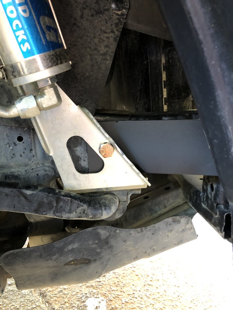

    Install done. Need to take a pic! Thanks again @GHOST SHIP for the help!
    Any of you with reservoirs, the solution is to drill a hole in the mount and notch the frame brace slightly. Worked well.

    @tacobell007 I will need this done when my KINGS get on please.

    @crashngiggles maybe next time we meet we can cut this hole in the bracket and just mount it so it is done when the Kings go in.

    I have ADS front c/o's with remote res and didn't need a modification on the remote res brackets. I did need to drill out the bumper mounts to fit, I thought these bumpers were specifically for 2nd gen Tacomas? Did anyone not have to modify the bumper mounts?
