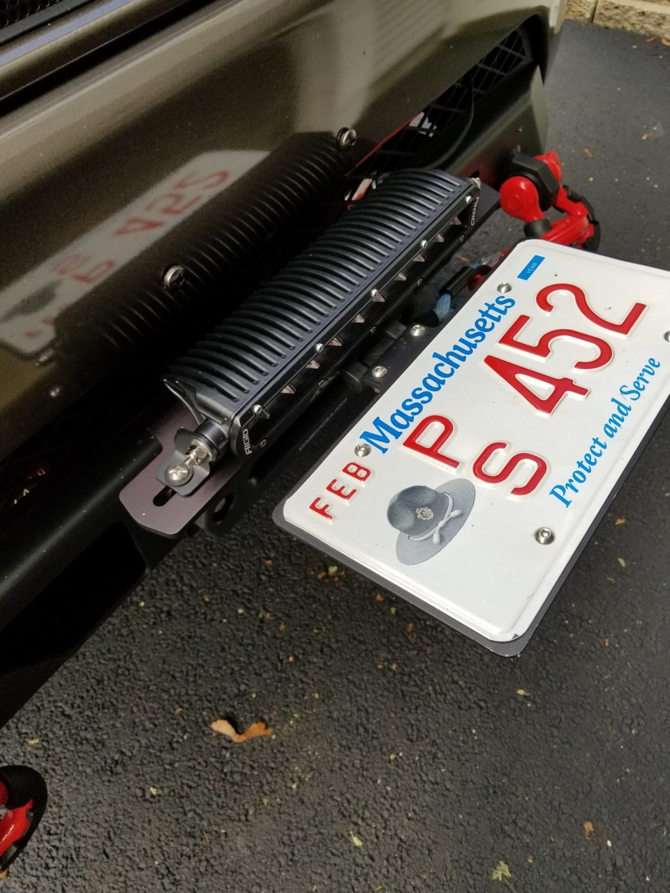

    Sorry if it wasn't clear, I didn't mean shining through the lower holes, but on the sides of the winch behind the mesh area. Guessing it'll probably still be too tight though.

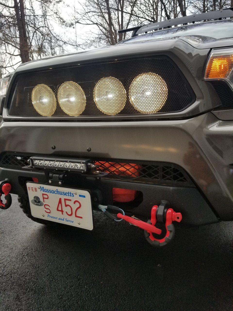

    Wicked tight back there, you could do what I did and buy a Flipster V2 and get the additional piece to mount a small light bar.

    figured as much haha. that does look pretty good though thanks!

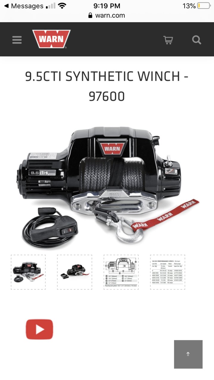

    Do you think this wench will fit??

    It likely would (with possible grille support trimming behind the bumper) but I wouldnt recommend it as the control lead would be a bit difficult to plug in all the way down on the winch. A winch with a movable control pack would be recommended vs the integrated like the one you pictured
