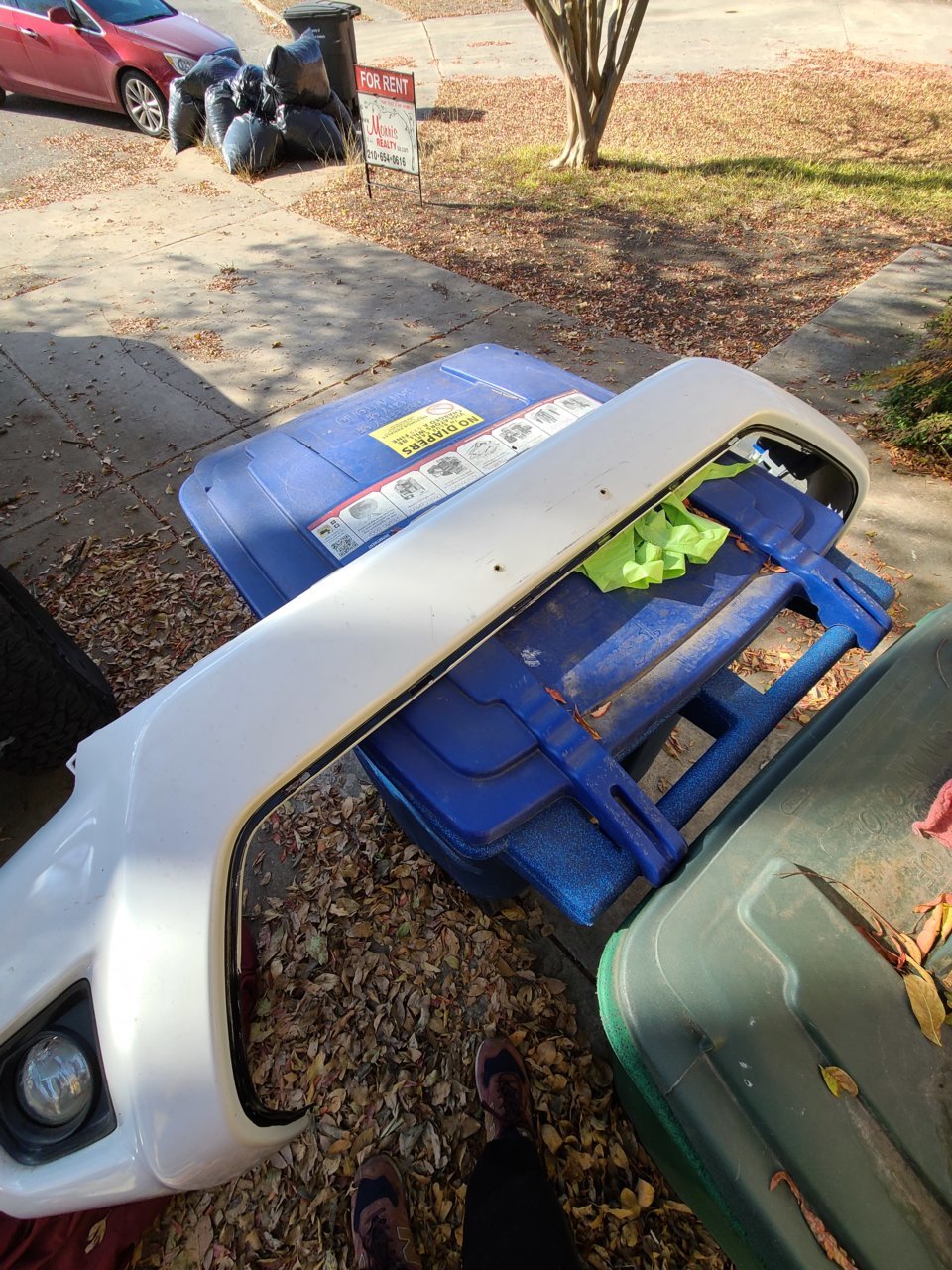

    If anyone has a light colored vehicle (my truck is superwhite) you can slightly see the difference in color so if you make a shadow line on the bumper where it frames around the stingray it looks much better. 20201218_101031.jpg

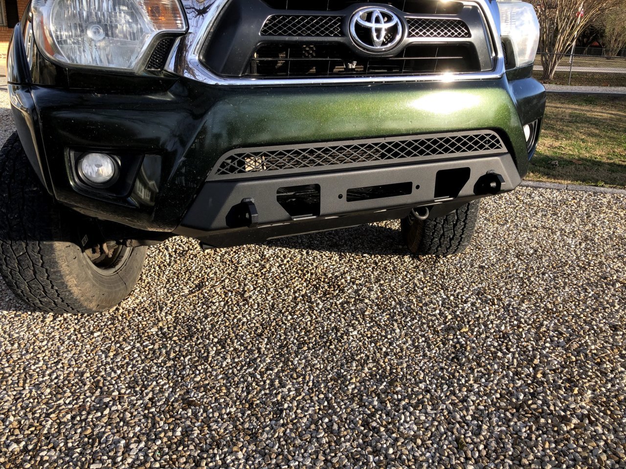

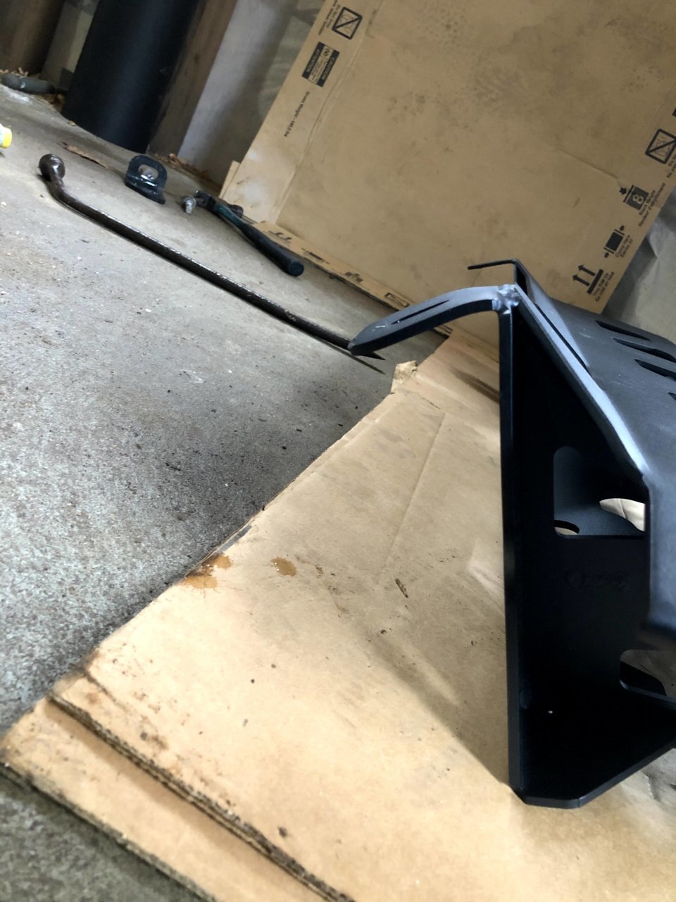

    Whoop! Got it on. Thanks guys, looks and feels great.

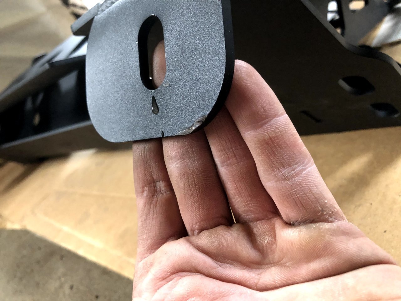

    Only downside is that I'm pretty sure it was dropped in shipping because one of the lower bolts (shown) was dented and bent in. Cousin got a tire iron and helped me bend it back enough to fit snugly, and I'm guessing I should just get something to cover the exposed metal to keep from rusting...IMG_0451.jpg IMG_0436.jpg IMG_0435.jpg

    You can just blast it with a little spray paint and it should be fine. Looks great!

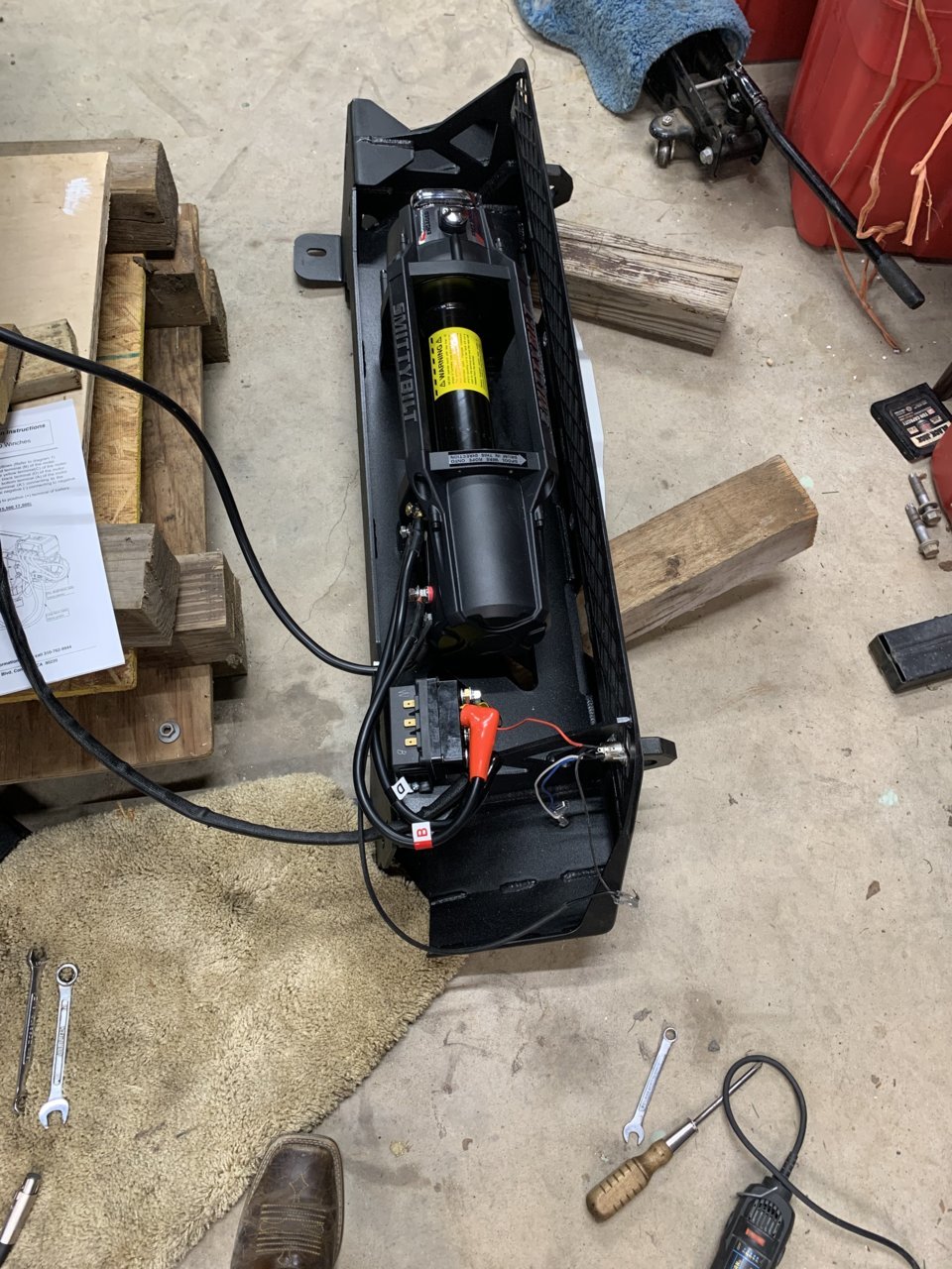

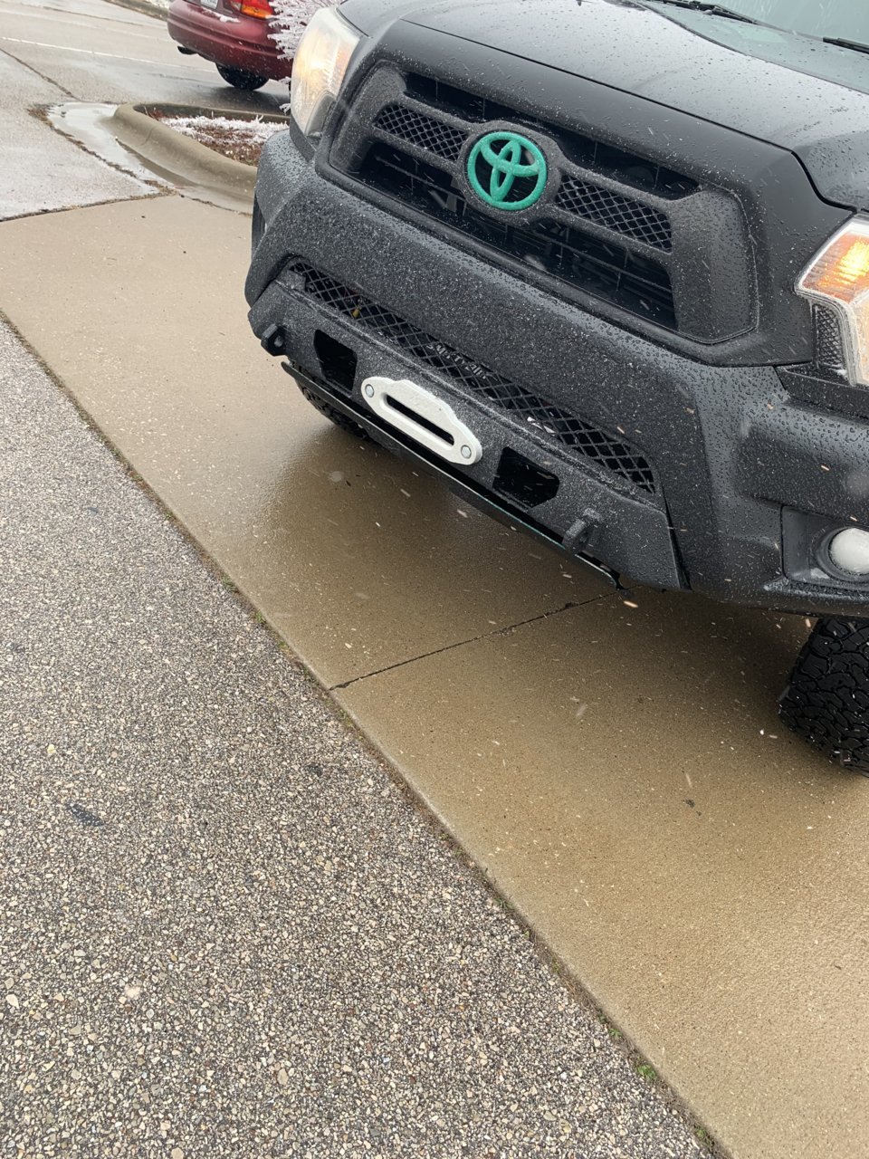

    Got mine installed over the weekend just in time for some snow. Still have to install the winch line which will be soon! Did mine a little different. I broke apart the control box and made the connection available from the front. D2CE9C34-41CE-4501-BFD6-CE65D49790E3.jpg 1570DA82-E313-49DE-A9C4-6D411889184F.jpg

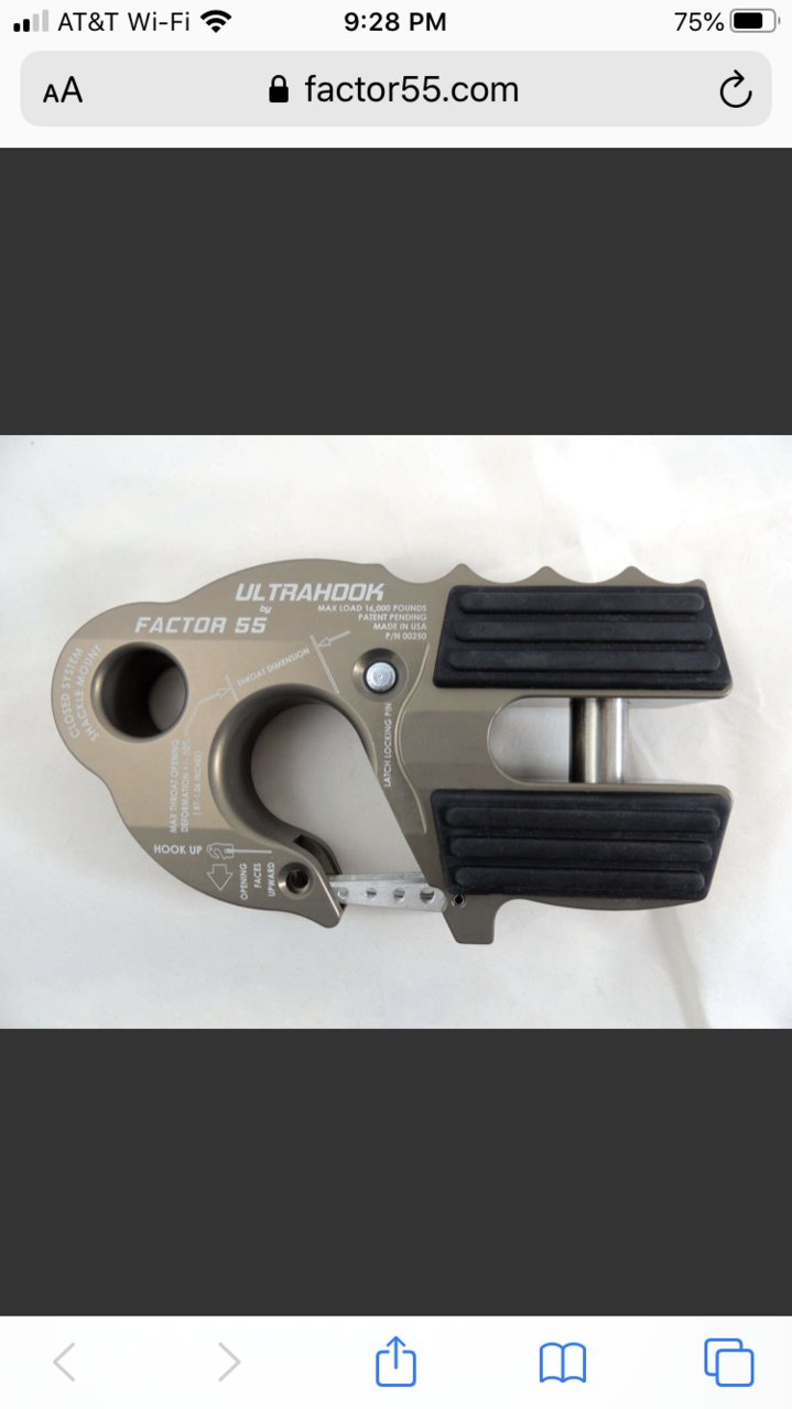

    Going with a Factor 55 fairlead and Ultrahook. Wish they made them in black tho

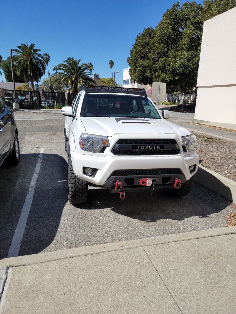

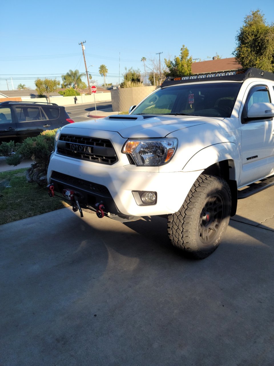

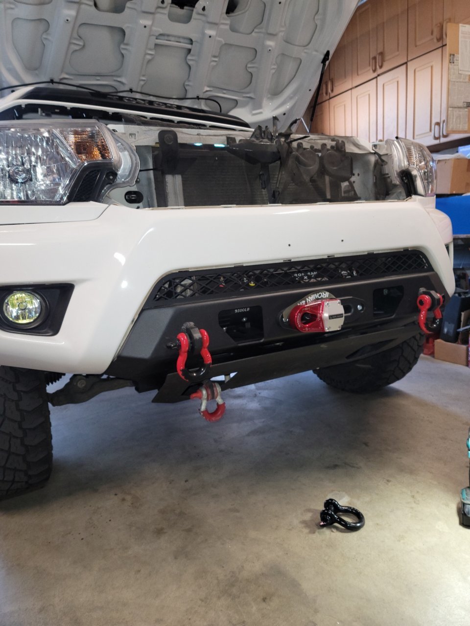

    Finally installed my low profile Winch Bumper, aka "Relentless Fabrication 2nd gen Stingray Bumper" and my winch plus some accessories. I love it. Thanks, Guys.

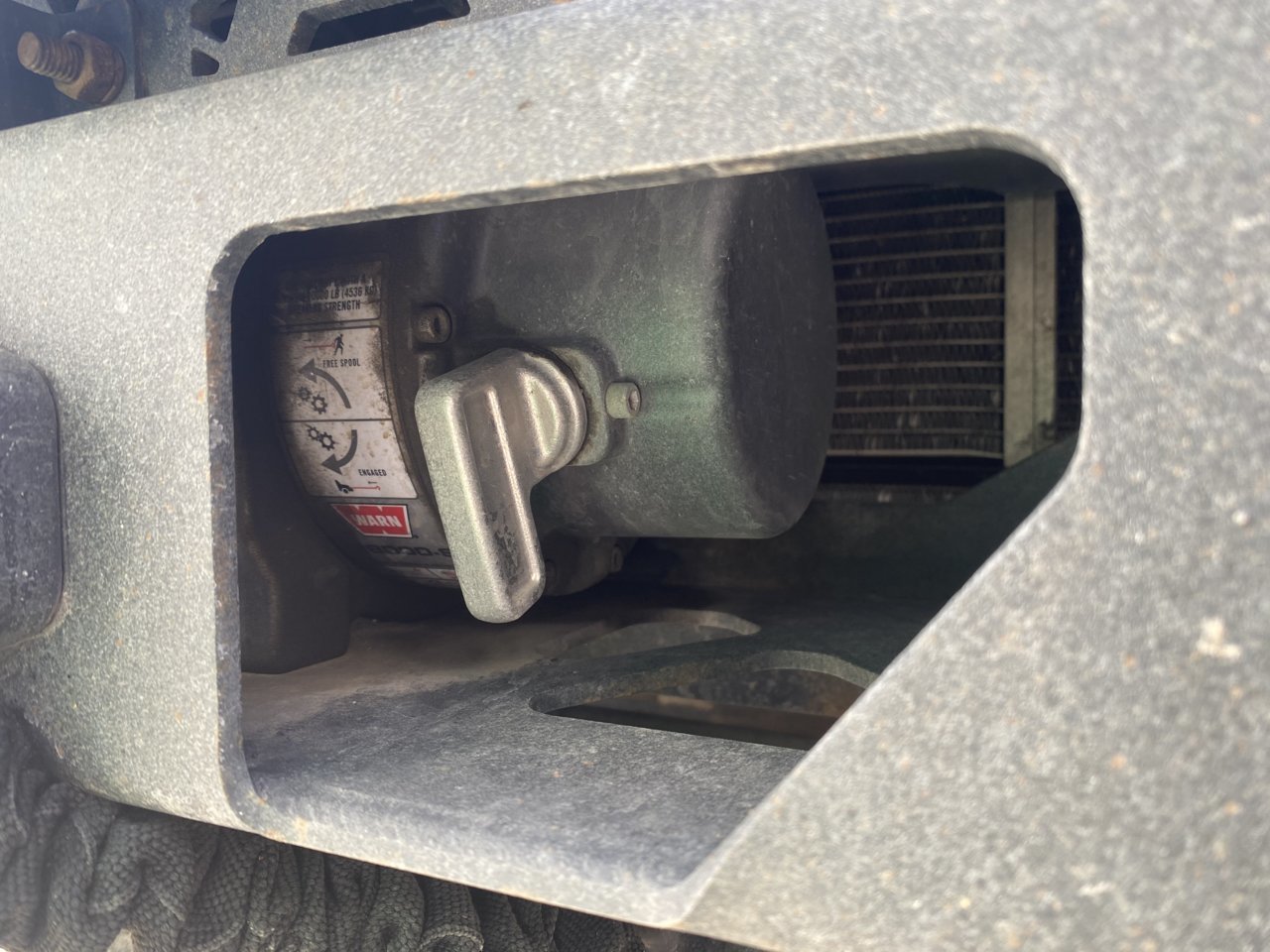

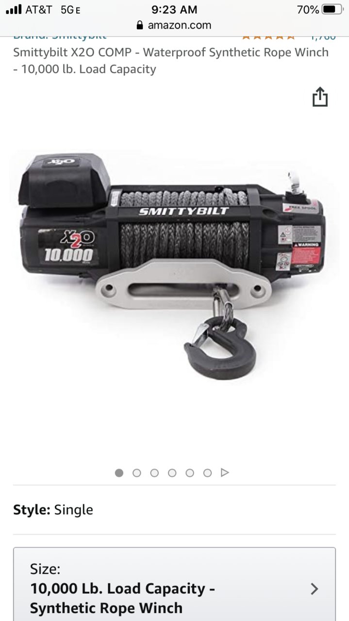

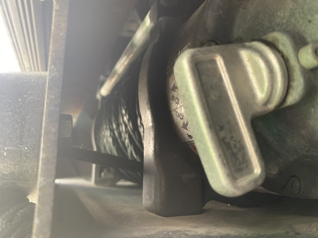

    So I’m having a pretty big problem with this winch install. My installer clocked the winch so the clutch handle faces forward, since my SC intercooler pump sits right above the winch. Problem is, now the clutch handle won’t fit, hits the bumper. Has anyone run into this problem, and if so what did you do to solve it. We were thinking of grinding it down, or just cut the lever off at the base and weld a super thin handle to it.

    Either get a remote clutch lever kit or get a different winch. I had the same issue when I bought my winch is too big, so I end up returning it before I start butchering the winch that I don't want to do. I got the Ironman 9500 Winch that's work for me (I bit tight but doable).

    @Georgeth1022, doesn't help you much at this point but there is plenty of room for a Warn M8000.
