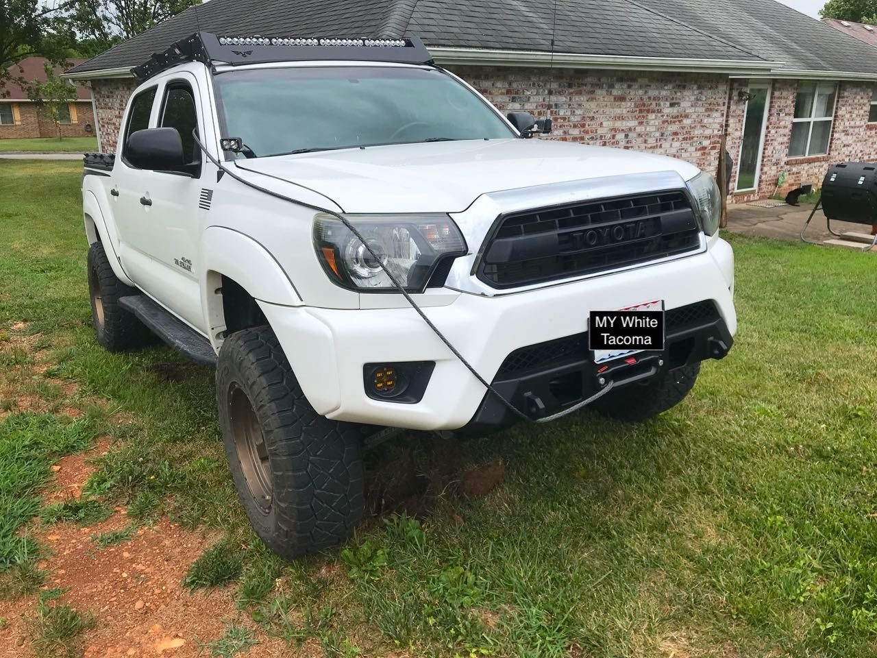

    I meant to post this awhile back but been busy and forgetful. Not the best picture, it looks WAY better in person. I still need to run my winch through a solenoid and I am going to wire in a LED light facing the winch spool so you can see it while using it.
    Also, need to figure out how to install the bumper reinforce brackets with my Fox shock resi's. Shouldn't be too difficult, it's just been too hot to care!

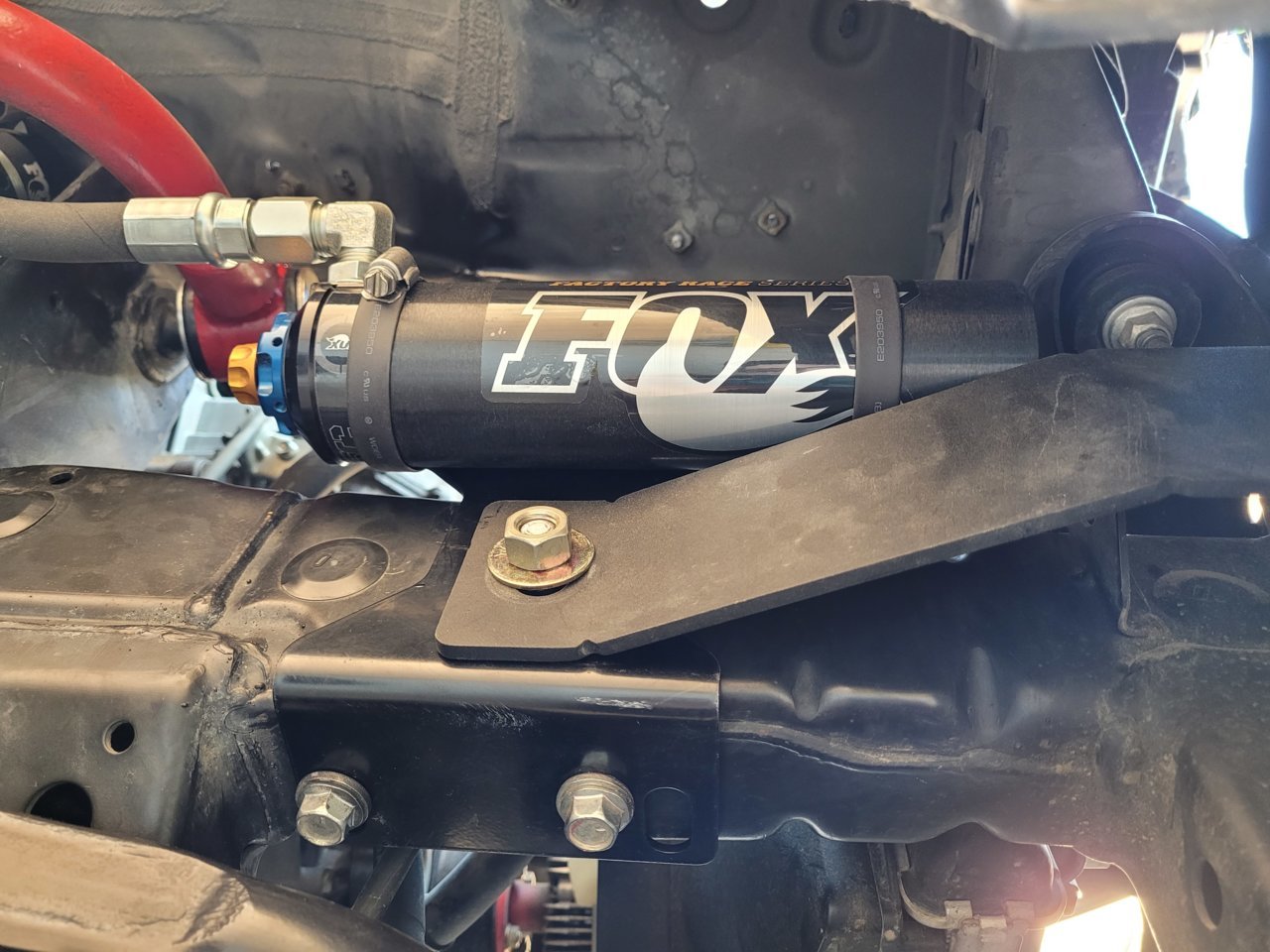

    I also have Fox shocks with reservoir and you should be ok with the install.

    Do you have the new style reservoir mounts from Fox? I installed the reinforcement brackets today and did have to modify the resi. mounts, but I have the old style. They stick out a bit more now and may rub a little, but only when close to full lock and with the tire tucked. I had to bend them out slightly and open up one of the bolt holes.

    I have the old style horizontal mount.
    I apologize, I actually drilled a hole through the old style mount to allow the bolt to go through the frame, reservoir bracket and the support bracket for the steel bumper. So modification is needed.

    Ah, I thought about doing it that way. I may end up drilling it like you did and mounting closer the the frame if it rubs too much. Thanks.
