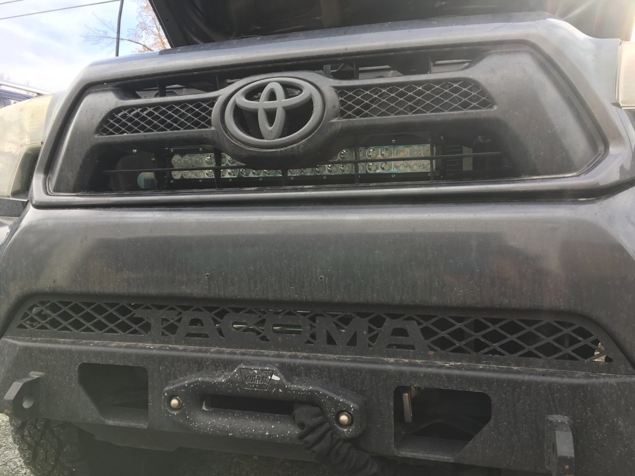

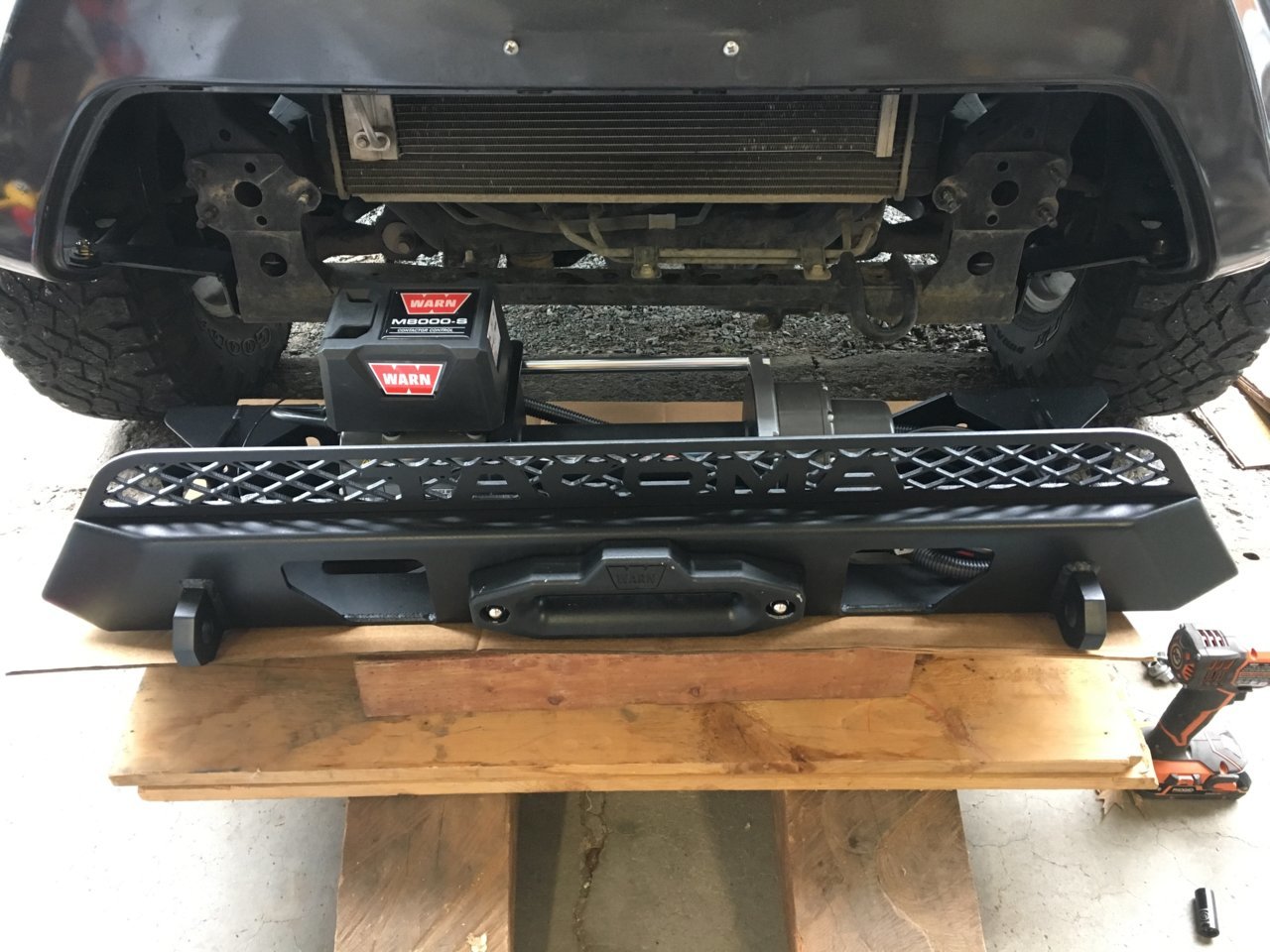

    Did you have to clearance anything up behind the bumper area to make it fit with the control box in the default position shown in your photo? Room to spare up behind there or a tight fit?

    I wouldn't mount lights back there but there's room for an aux transmission cooler and supercharger intercooler.
    This pic is from before the aux cooler and intercooler were installed.
    At one point I tried to fit a lightbar behind the grille but when I mocked it up real quick it was clear that I'd need to relocate the control box...it would have been a pain to plug in the controller.

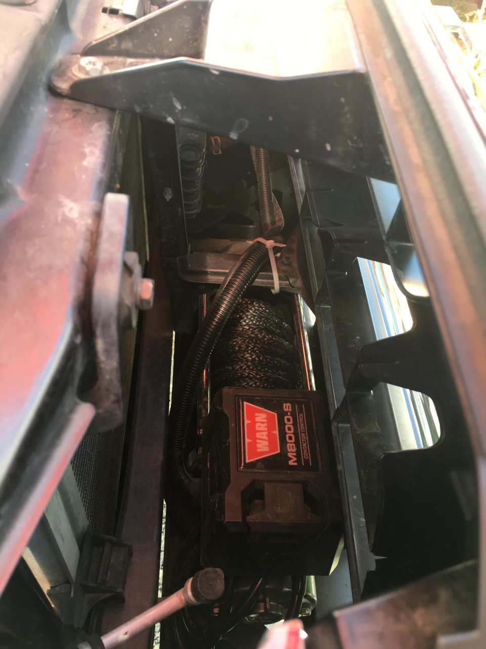

    Awesome thanks, photos are quite helpful! And forgive me if you posted them before, I’ve read so many threads I can’t keep straight where all the info is or what I’ve already seen. Interesting how close that cross brace is above the winch spool, and how there is way more room near that AC line than I expected (figured of all things that would be in the way).

    I believe Eric used the winch when designing the bumper...mine was the first 2nd Gen stingray he built.

    Hello, I was wondering, if I went with the Warn VR Evo 10s do I need to buy the control pack relocation kit? And where would I relocate it to? Sorry if this is a noob question.

    Assuming the images I saw online are correct, that winch appears to have the control pack located in the center. Based on photos above from @stickyTaco notice there is a cross brace right in the middle above the spool of line exactly where that control pack would be. So I’m going to say that yes you probably would need to relocate.
    As far as where to put it that’s entirely up to you. Popular places are down by the winch but offset left/right of center, up above the winch behind the grille/in front of the radiator towards the passenger side, or passenger side of the engine bay. You may have to make your own custom mounting solution for any of these spots, or search for solutions on the aftermarket.

    I was able to fit it without the relocation kit. I had to grind and bend the cross brace that Adam is talking about. But was able to make it fit without much room to spare.

    In most cases I'd be recommending just cutting out that center sheet metal support bar in order to clear the winch control pack on any winch, unless you want to relocate it higher up for ease of access to plug in a remote.
