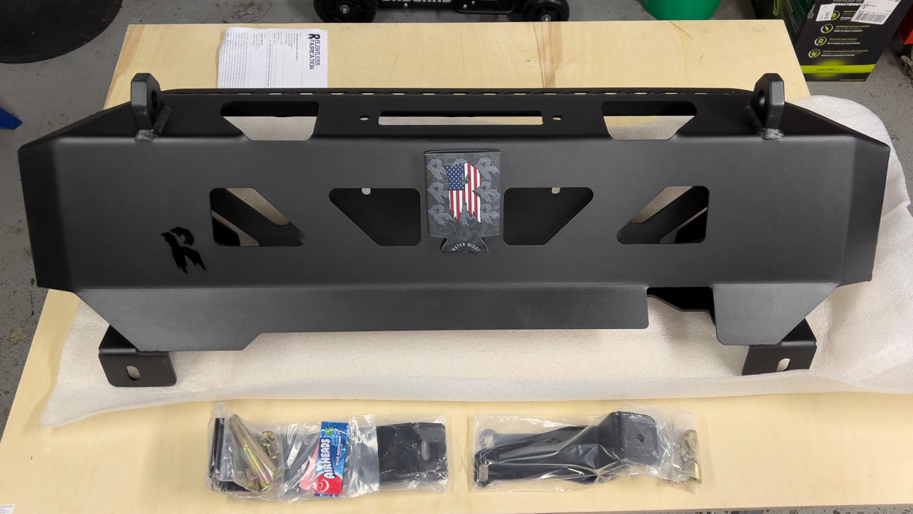

    Pointeman Well-Known Member
    Aug 11, 2017
    #226590
    1,803
    Mark
    2013 Pyrite Mica Tacoma DCLB
    6" Fabtech Amp Research hydraulic steps Front Runner Cab Rack Leer 100xr topper w/rails 17” Black Rhino Warlords Dark Tint 295/70R17 Nitto Ridge Grapplers

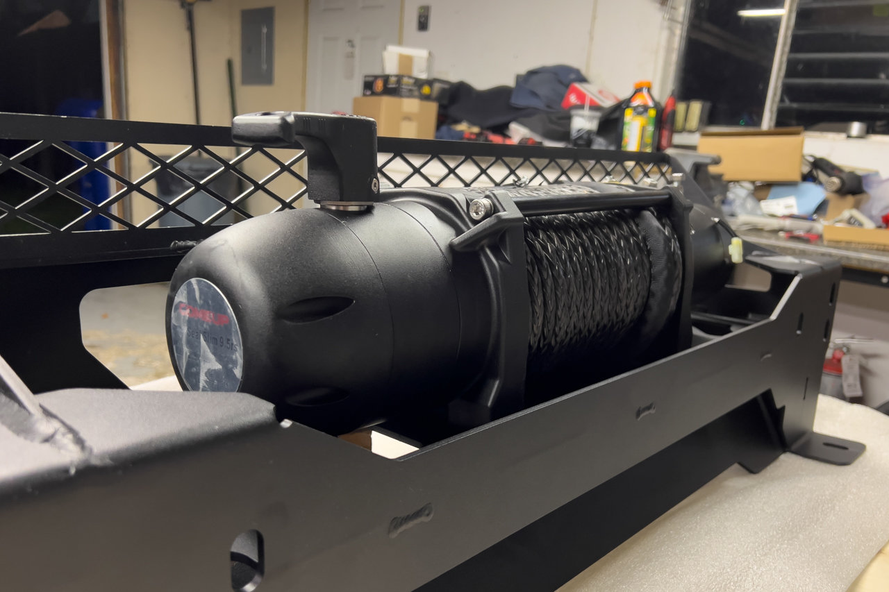

    Had to do a quick test fit of the ComeUp Seal Slim 9.5rs otherwise I wouldn't be able to sleep tonight. I need to clock the handle forward but otherwise seems to fit great. Weather forecast may allow me to install it this week too, although it's the final week of a college course I'm taking so that comes first. I have next Friday off work and temps should be around 50 degrees that day so worst case I have to wait a week.

    I literally did the same thing as you. I put the winch on it just to check it out and have to stare at it until I can install it later this week LOL

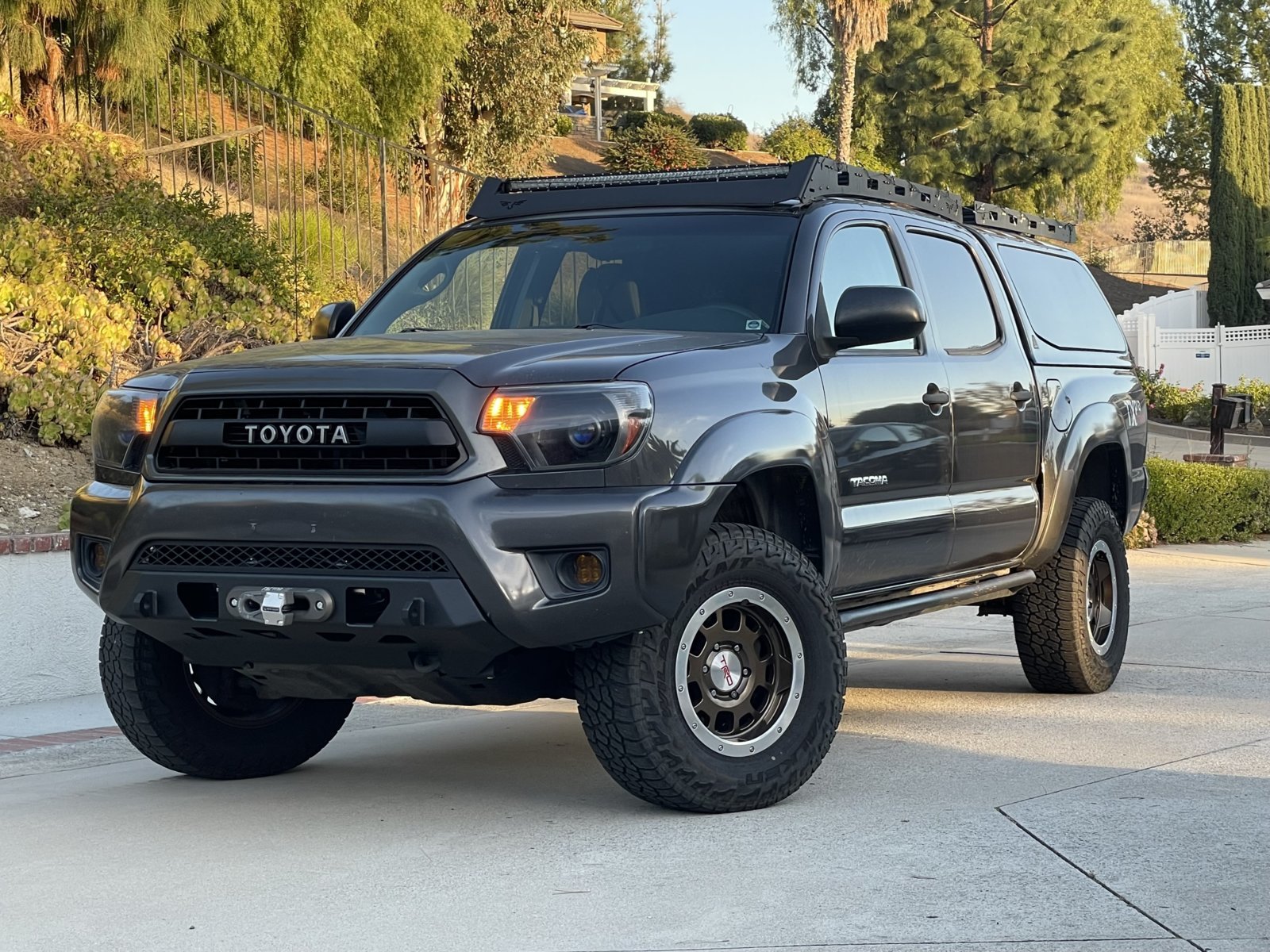

    2012 Tx Pro
    Put off a ton of stuff on my to-do list to get this done. I previously relocated the control box the other day to the rear passenger engine compartment and spent a good 6 hours getting the bumper and winch installed today. I ended up using 1/0 and 2/0 wire to relocate the box. Getting that stuff into a split wire loom is NOT fun! But totally worth it in the end! Now to upgrade the battery. It dropped down to 11.8v while getting the rope spooled up properly.
