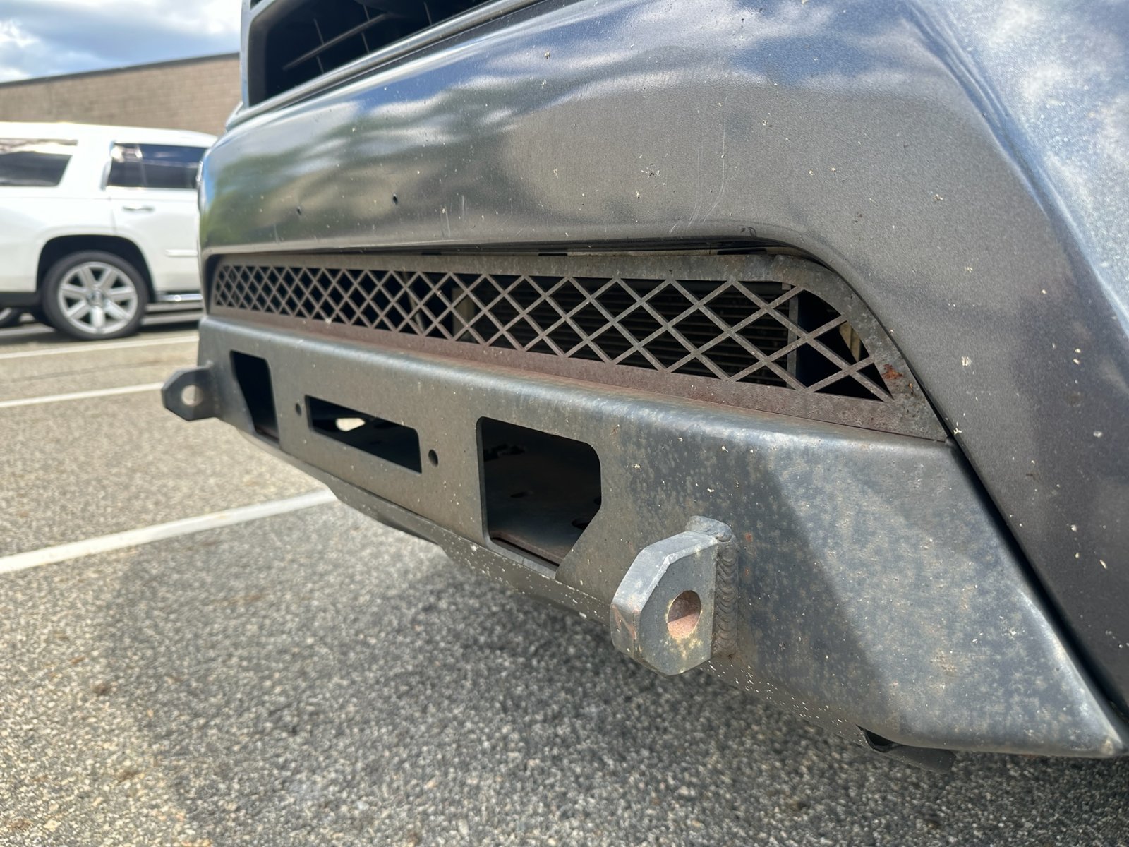

    What's the best way to clean this up and make it look purty again? Had it on since 2019. Thinking of selling the truck in the next year or two and its looking a bit rough.

    2 options:
    Relatively easy 1: Remove the bumper, hit it with a sanding flap wheel 120 grit or finer then rattle can Rustoleum pro/high performance flat black.
    Relatively easy 2: Leave bumper mounted. Painter tape the bumper so you don't scuff the oem bumper shroud. Scotchbrite pad (manually by hand) the aftermarket bumper. Painter tape plastic trash bags over the front of the truck so you don't overspray. Spray with Rustoleum pro/high performance flat black. Make SURE you're not overspraying paint onto the truck.

    Personally I'd take it off, have it sand blasted and re-powder coated. If you try and sand it by hand and coat over whats there with spray paint it might look good for a year or so and then be right back where it's at now.

    Thanks! I think this will be the route ill go.
