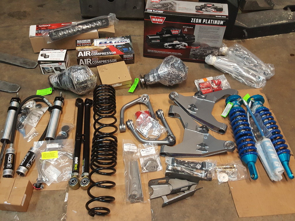

    OK, parts list:
    Armor/exterior:
    Relentless Predator front bumper
    Relentless Rear bumper (updated design with tire carrier coming soon)
    Relentless rock sliders "running rails"
    Relentless IFS and trans/tcase skids
    Relentless roof rack w/ fairing, rotopax mount, hilift mount
    Suspension/drivetrain/performance:

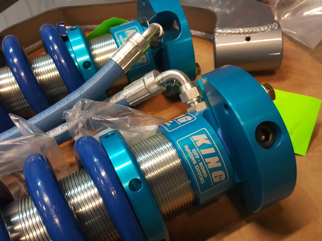

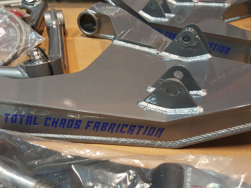

    Total Chaos +2" RACE Long travel kit with +2 CV axles. Gusseted EVERYTHING (coil tower/UCA dual shear, Cam tab gussets, spindle gussets)
    King coilovers w/ resi's

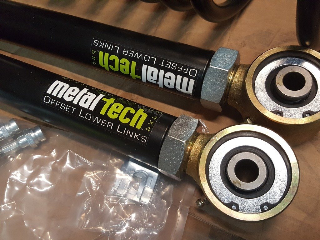

    Metal Tech 4x4 rear long travel setup

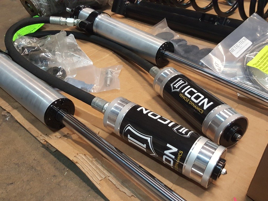

    Icon 2.5's with resi's
    Motorsport Tech 1.25" wheel spacers on rear
    ARB Airlockers and 4.56 gears front and rear setup from ECGS
    Doug Thorley shorty headers (need to install)
    Custom Magnaflow exhaust (14" muffler, forward axle dump)
    AFE Magnum force ProDry-S CAI
    Method Race Wheel 'Double Standard' wheels, 17x9
    Cooper STT PRO tires in 315/70R17 (35x12.50)
    Lighting:
    Aftermarket blacked out headlights w/ Halo/projectors
    Rigid Dually SAE driving lights in front bumper
    Rigid Dually D2 Hyperspot lights in front bumper
    Coming soon: 40" Baja designs LED bar on roof rack, rock light setup TBD, backup lighting TBD
    Recovery gear:
    Warn Zeon 10S Platinum winch (badass winch!) w/ relocate kit
    Factor 55 ProLink E on winch line
    Various 3/4 D rings, recovery straps, snatch block, etc.
    Miscellaneous:
    ARB CKMTA12 'dual' compressor w/ 2gal Viair tank
    Switchpro's accessory power distribution/switch panel
    Probably more that I'm forgetting, will keep updating!

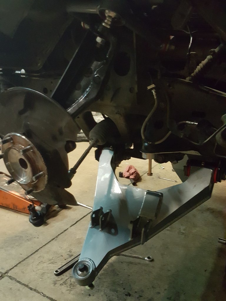

    A few pics of the build process and parts:

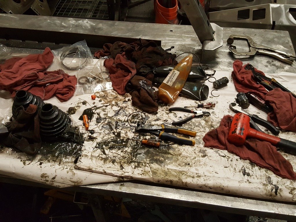

    CV axle rebuild onto +2" axles... fun

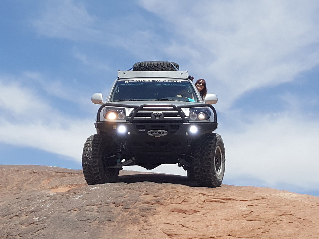

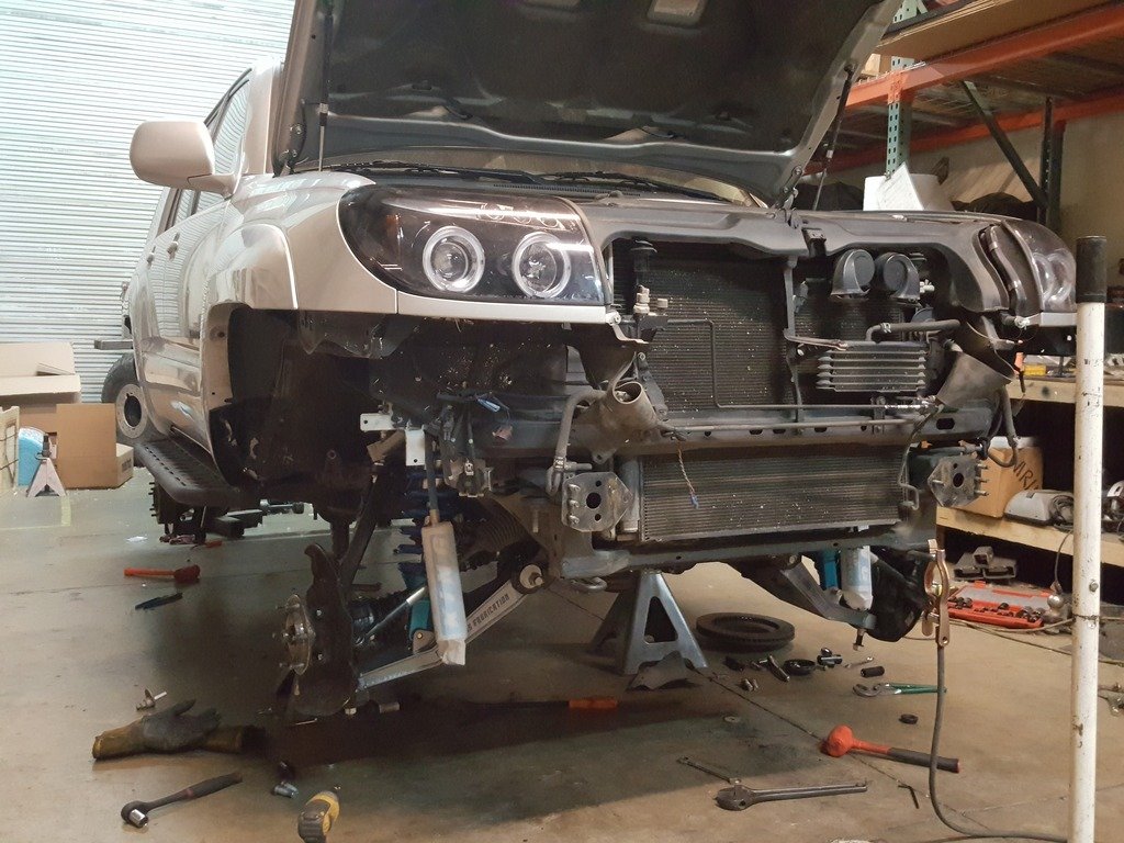

    So, fresh out of the shop being built (I did a week long marathon build! 14hr days working on this thing to get it ready) I loaded it up and headed to Moab UT for Rock Therapy 2016.
    My wife is still editing photos, but here are a few to start. I'll add more as I get them uploaded.

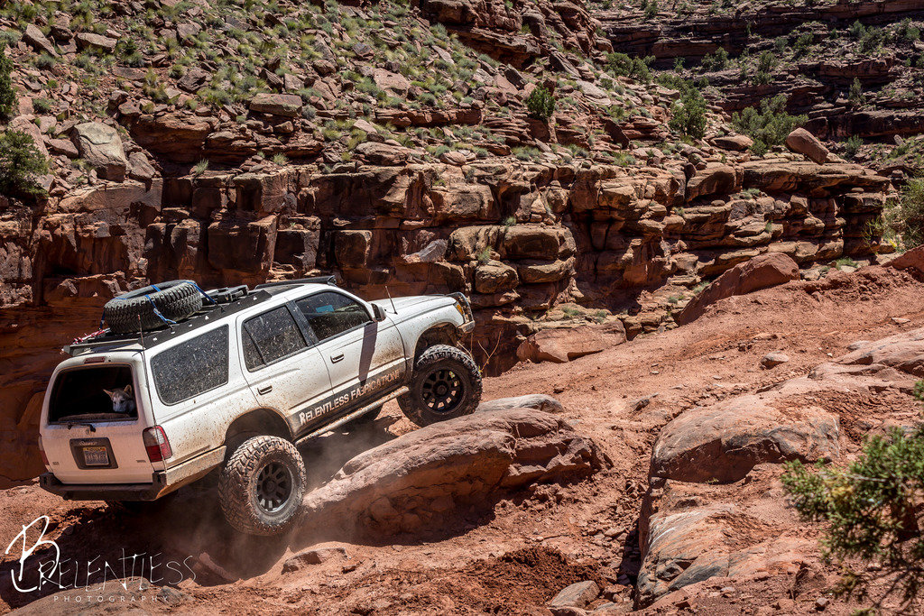

    Behind the Rocks
    Ran 'Trifecta': Poison spider mesa, Golden spike, Gold Bar Rim all linked in one day.
    Group shot on Gold Bar trail (left to right, back) @MJonaGS32 @Mademan925 @RelentlessFab @JLee (hidden behind) and @jberry813 coming down the trail
    Took a bit longer than expected when I snapped the driver inner tie rod randomly on this obstacle called 'Body Snatcher' on Golden Spike. Thankfully Jason @jberry813 and Jerry @JLee ran out for parts for us and @Wishbone Runner had a spare back at camp(thanks!). Apparently the 4runner/FJC have different inner tie rods than the Tacoma, weird. Will be keeping a couple spares in the rig all the time now
    Wife ran the trail "Fins 'n' Things"
    I then moved on to Hell's Revenge. Ran up Hells Gate and also conquered Escalator on the trail.

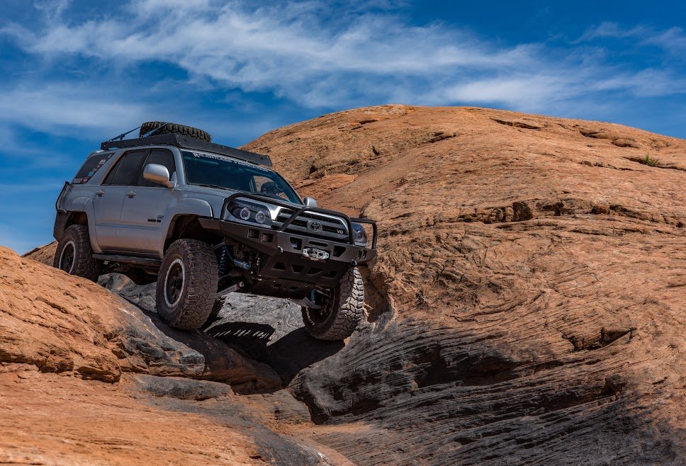

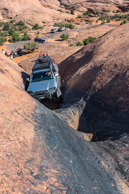

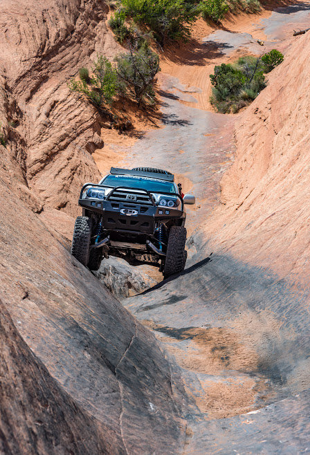

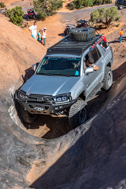

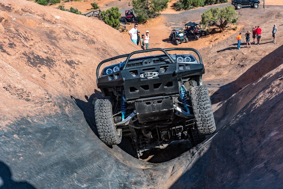

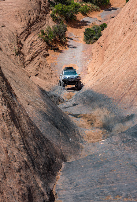

    Hells Gate....
    Going down:
    B6M3SkzLq7Fva4uRglqyN-o-VjryYXnzGz5Yd9Ht_4e348948f9f22f8dbbf476a02f8f09559d745435.jpg
    EVV1-yBhwu3eLczwT6RDIuIaqSiYy-iCczrwjcw9_ef0371c41a566adbde60774cc1745de5d8d893bd.jpg
    jwKjURm_JHyYLkdxX8l6O4nlz8ThGIkKCHvONKv7_63c1aaf2baeeb778dd8c85735138dbf361a0149f.jpg
    gjSqMPA-OBZwKuO_E7mckw9i9N45uw86-18G4LPf_fdeebd300e848d66ceb0f07f92480fcfb9640e59.jpg
    And then ya gotta come back up....

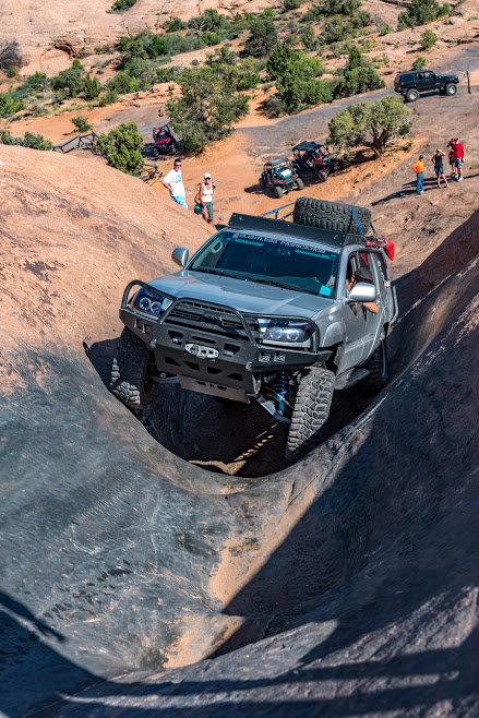

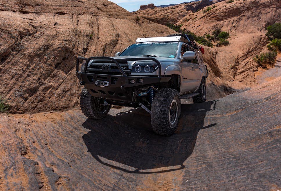

    The optional "Escalator" on Hells Revenge
    eYaDETq83r1xwzHa4SYX6ejW64MfCKOywfwK6biJ_390d673a71c2381876c842d46d0a37b8aa6a8c5f.jpg
    GY8YWbeqYRYMOFNRhmuvzjKs5mCNFWK2nX2TVzX8_616c0809f633292e7ddca77a2469d28fa067c537.jpg
    -RuNzBj055Dmk3A_0iF6nefUezq2nO7JDBTrJtb9_ad12c26b5abddb3989cf57ee0ec95d96e392afea.jpg
    SI-HHhC1ShBnyM96SKFeJMkKhOSpd9razF2Dbb-W_cb0206dc388b9eed27410abf4ec1a6f3bf5e939e.jpg
    EFIKRMS4LGBvKjdSc3vb8uMQth7nQQ-x7NP0HVjO_70e0a3ab2e2e8c988437dbbc0ddbc186d3aa830c.jpg
    Looking back down at it. Waaaay steeper than it looks in photos
    xFE7OCRYX7qwb71CZMSgla8nu1NQa788CVFsAlrK_c7dbcf165b83bc36d2aee87e9f46c38eec8083cd.jpg
