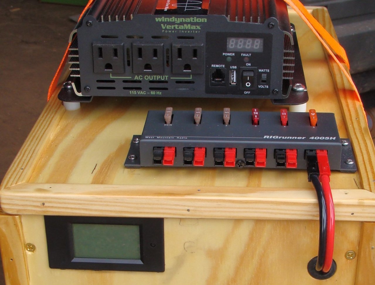

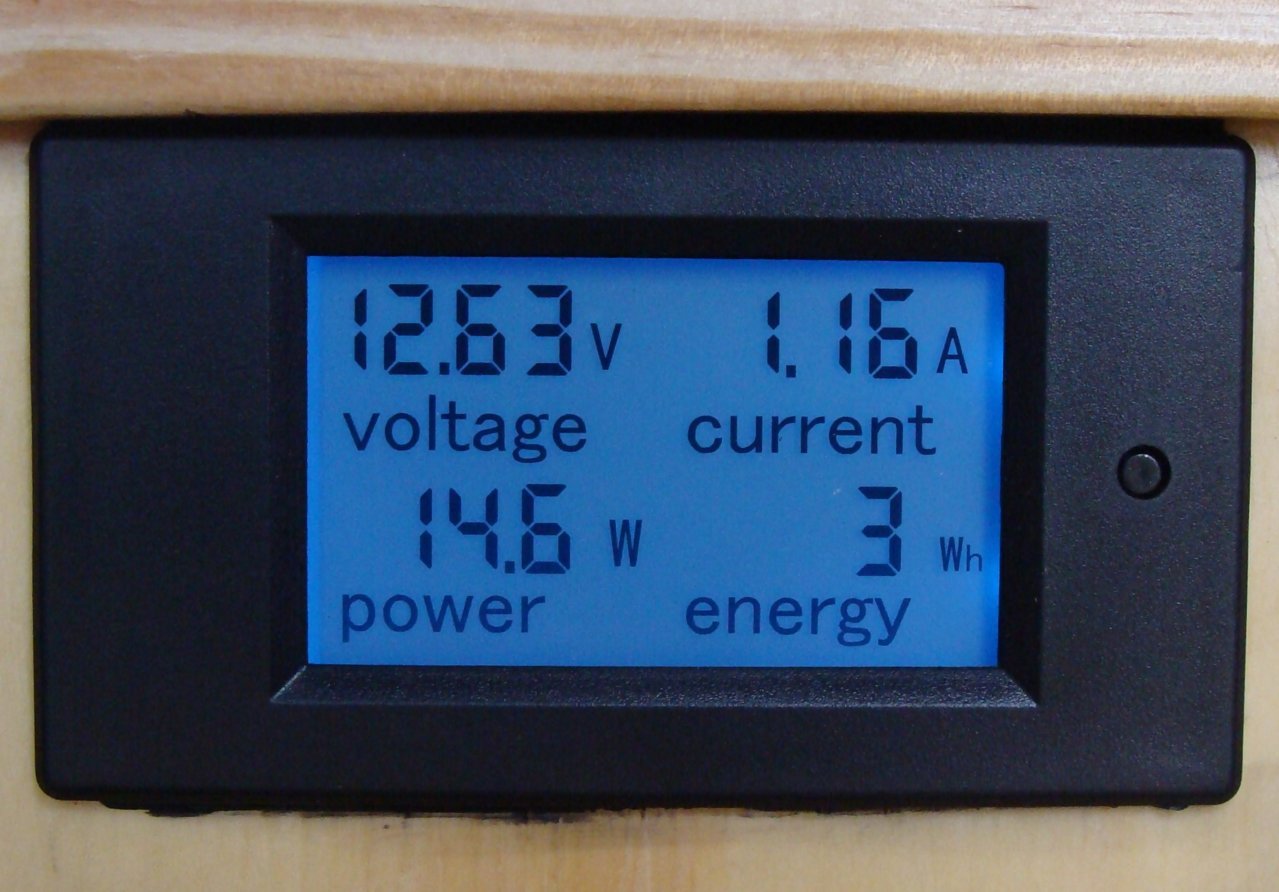

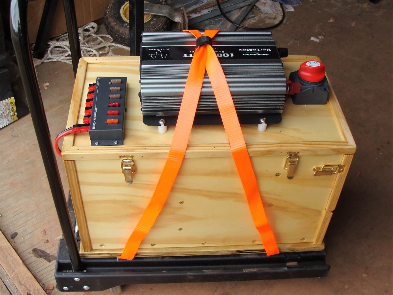

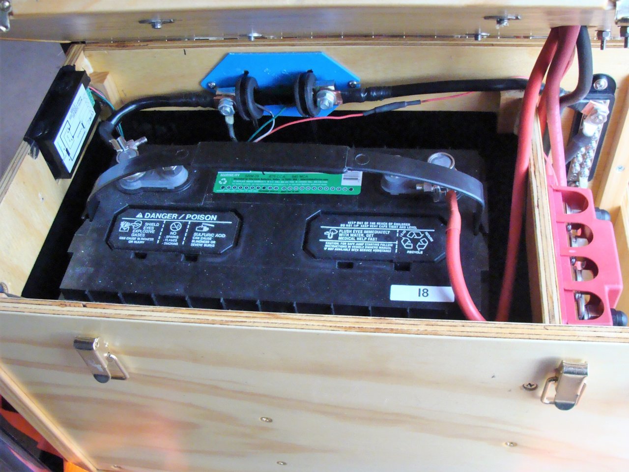

    I use a power bank for my astronomical equipment in the field. I use a 96 amp-hour deep cycle battery and have a 1000 watt inverter hooked to it, along with a set of RigRunner DC outlets. I'm running a telescope mount and two cameras on DC, and a laptop computer on AC, and I can sustain a steady 2-4 amp draw in both AC and/or DC all night long and draw the battery to about 60% capacity. You probably wouldn't draw that heavy a load just using it to recharge small items or using the AC intermittently for small appliances. It takes me about 4-6 hours to completely recharge my setup at a charge rate of 2-3 amps. The jump starter power bank won't have quite the "legs" due to a lower capacity battery; I use one as a backup system or for quick setups when I don't power more than the telescope mount and usually get 6-7 hours from one, as a reference. Here's a picture of the larger bank I built; it's about 75 pounds, and also has a "power minder" display that shows battery drain in watt-hours and watts being used, current in amps, and has a low battery alarm that can be set for whatever level you want.DSC00585.jpg DSC00584.jpg DSC00591.jpg DSC00587.jpg
