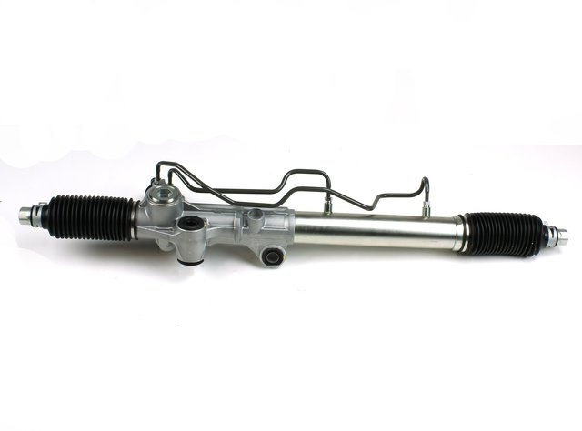

    yeah i saw the one with a 2 year warranty.... its on sale now for $133. might just go that route.

    it showed up today. looks nice. now we see how it holds up after it in.
