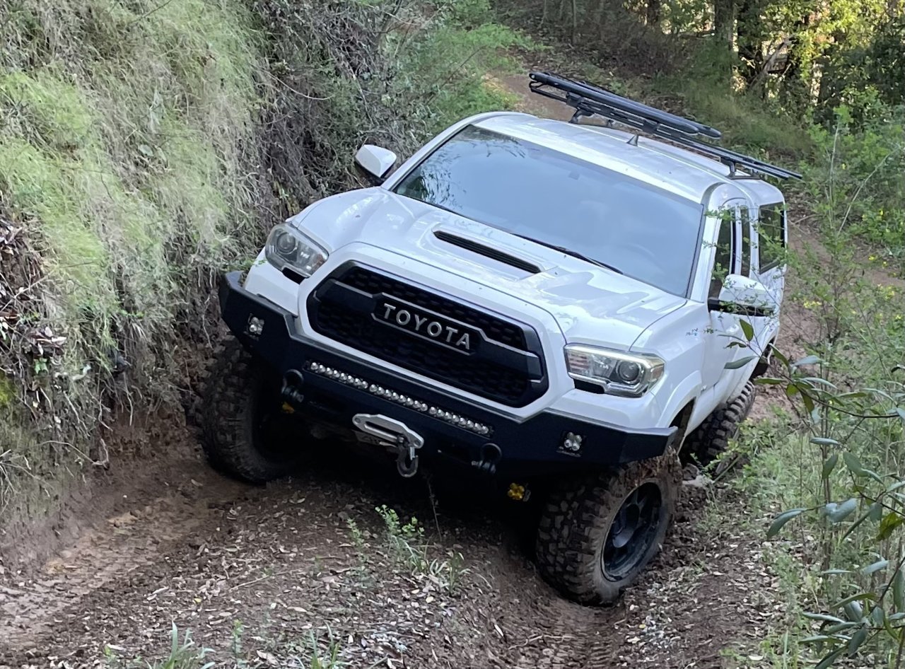

    Clazzio seat covers Oem bed mat $35 china pro grill Snugtop Cab High W/ Yakima racks OME 886 suspension kit 3” Pelfrybilt steel front bumper/1200lb Smittybuilt winch Baja designs lights Switch pros 9100 Method 701 wheels CBI rear steel high clearance bumper
    Ome 886 does the job and doesn't break the bank.
    I've got about 200lbs of steel with a winch and lights hanging off the front, Pelfreybilt. Another 250lbs in the rear, CBI high clearance with swinging spare. Well balanced for my needs, but I do feel every bump.
