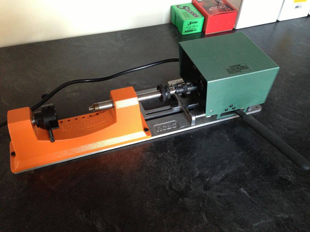

    Here's my "new" frankenstein case trimmer. I found a new RCBS power unit at my local gun store marked down to $100. I picked it up thinking I would buy the matching case trimmer, but the Lyman I already had seemed to be similar enough. I had to cut the handle off the shaft and drill and tap the shaft so I could hook up the power unit. So far so good. :)
    Now I just need to figure out where this thing is going to live.

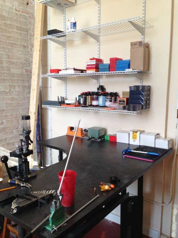

    Here's my workspace. I added the shelves today as I was losing workspace on the desk to components.

    It is nice and organized. But you are breaking a cardinal rule. Avoid storing powder and primers together. The powder should be in a heavy wood or steel cabinet away from the immediate area. And the primers would best be stored in an ammo can or sealed container of some sorts. As recommended, that's all i'm sayin.

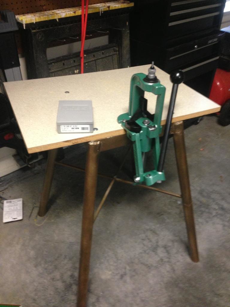

    I'm slowly getting set up, got the press, dies, a bench/table, next paycheck I'm getting a reloading manual, scale, and components...anything else I will need?
    oh, I'm setting up for running .45 colt, the dies are RCBS carbide dies.
    oh, I also have a crap ton of brass and a source for cheap cast bullets.
    I've got a big steel desk that I will be setting up on instead of the current bench once I get everything, I'm hoping to reload my .45 colt with blue dot.
